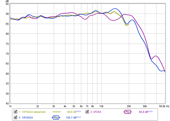

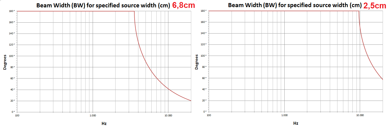

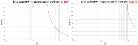

Of course 10F isn't perfect superman but think 16kHz reach is bit pessimistic, reason is probably when measured in home environment we have reasons for limits and as example below blue is 10F verse purple a real 22kHz tweeter on same baffle psychoacoustic smoothed with traced 10F datasheet gold curve in bag ground, throw a 96kHz or 192kHz DSP at 10F and that 22kHz tweeter is within reach on axis at about a 20º window.

That might be the case. I created a 15kHz +3dB high shelf on MiniDSP EQ, it seems to have helped a bit. Need to tinker more, maybe 20kHz is achievable.Beautiful build picture including the ones at imgur link .

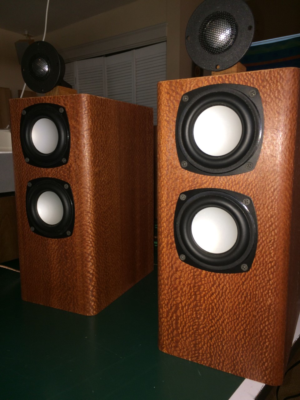

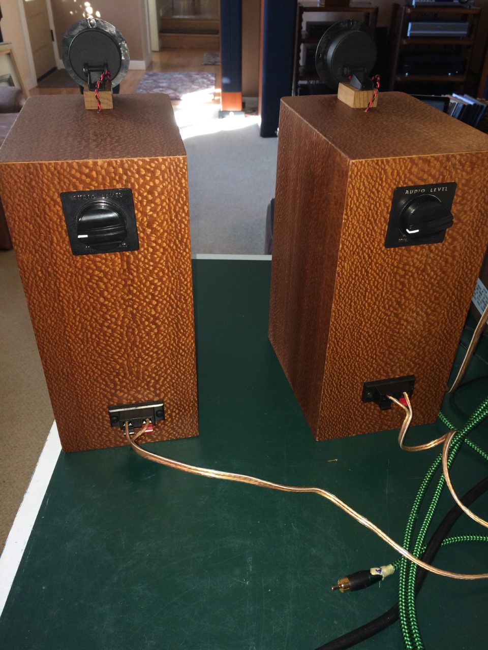

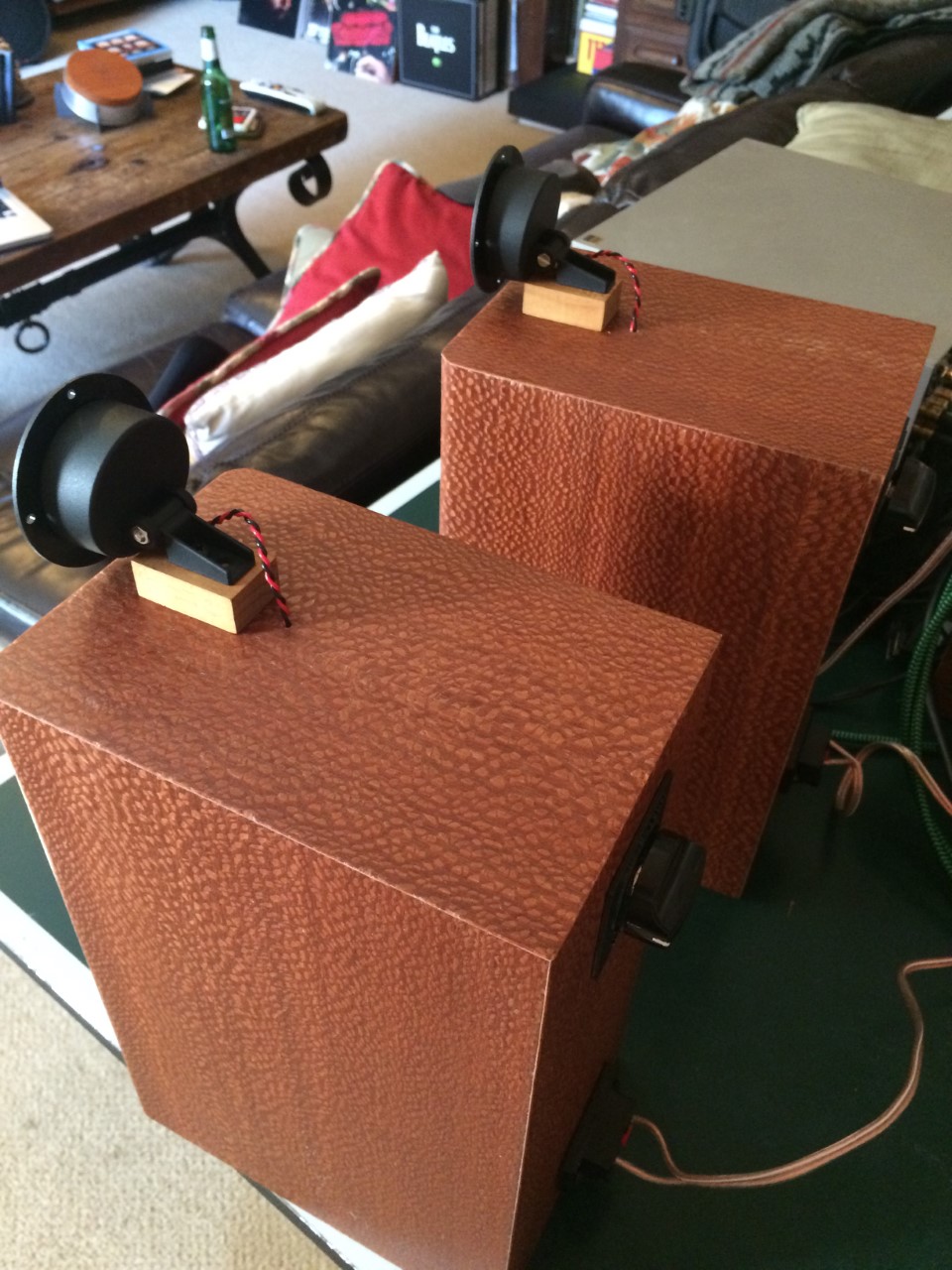

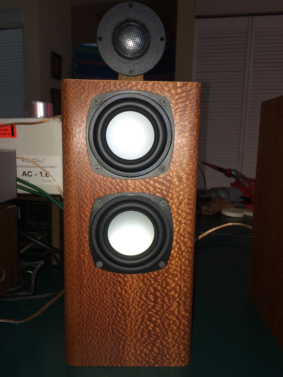

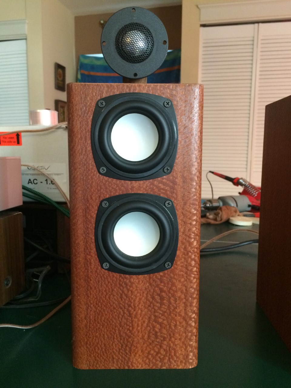

...Aurasound NS3-4ohm's and some very cheap tweeters collecting dust in the closet, so....
Dual NS3's 4R wired full-range in series, sealed in an old PE Baltic Birch knockdown and veneered in lacewood. After first listening without the tweeter highs were lacking, so I added tweeters, a 2.0 uF cap and variable L-pad to sweeten them up a bit... Not bad and can handle greater SPL than expected.
Cost of each cabinets' hardware is $60 (2x AuraNS3 + $20 L-pad and tweeter). But unless the primary design objective is small cab, higher SPL and adjustable treble, and unless you already have the drivers and other stuff, I'd recommend ditching the dual driver, tweeter and L-pad approach and using a single FR driver like the Mark Audio Alpair 6M or 6P, or a Fostex FF85wk for a more detailed and better balanced sound.....maybe even an MA Pluvia 7 though I haven't heard them yet.
Mario
