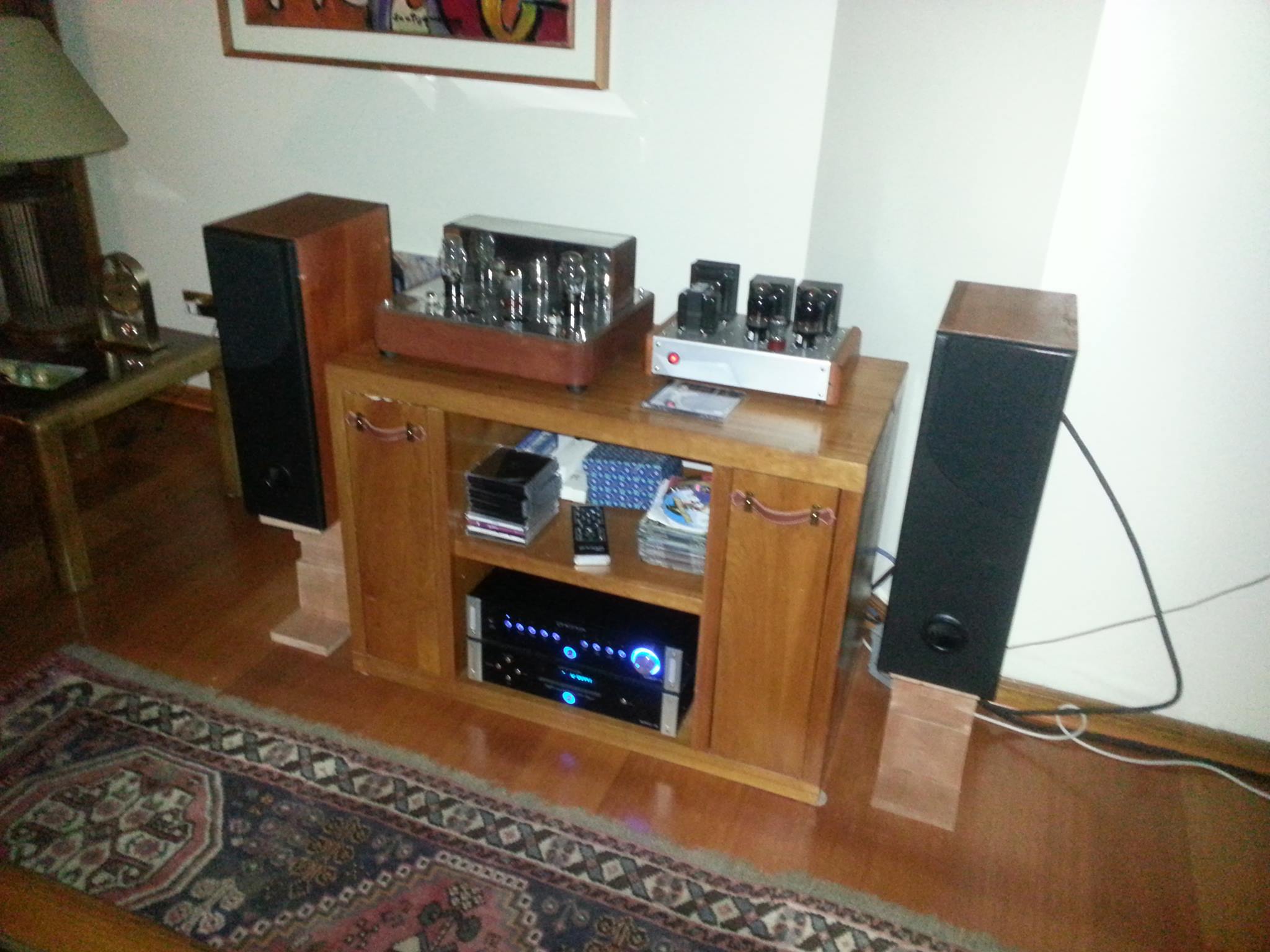

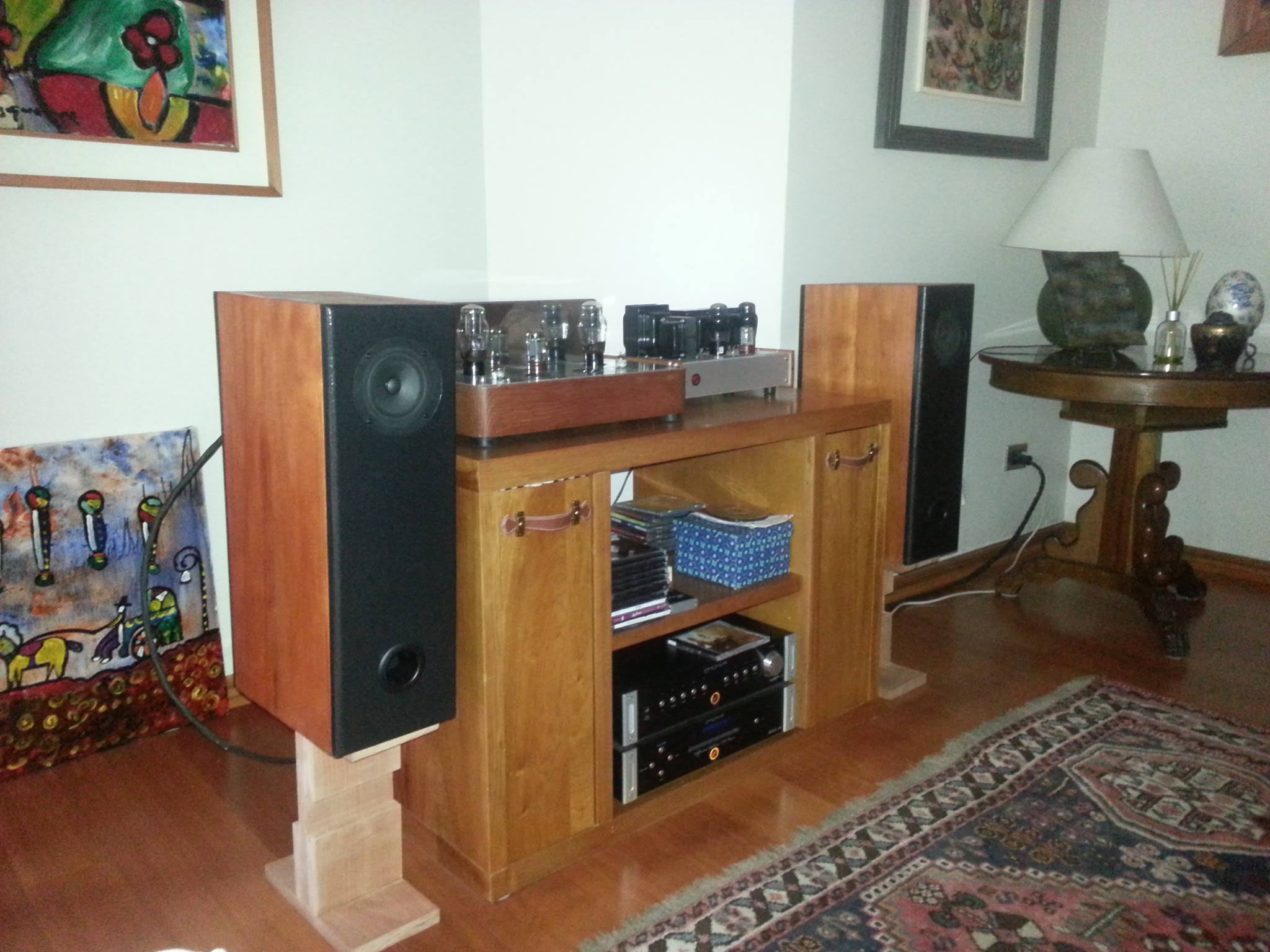

Well, these are the Konus Audio speakers. The wood is Bosnian Pine.
From origin, they are covered with a fine varnish, but I took all the varnish.
I know a "menuisier" (someone who works with wood), who made a lot of research about XVII th century wood techniques.
At that time, the most sophisticated techniques consisted in working the wood surface without any product.
He reproduced the tools from that time and took the varnish out. Then he treated the surface with these tools until a point where the wood shows it's natural shining reflex.
So they have a natural discrete brilliance, very "chic".
This gentleman restores furniture from the Palace of Versalhes, and he has a shop in Paris 200 metres from my apartment, (a few years ago, because I moved to Fontainebleau).
He made it for me, because he knew how much I like these speakers.
This way, the speakers get old in a very beautiful way, the wood oxidates naturally.
There is also a great advantage : if I have a problem like an accident, a shock, it is easy to restore the wood, just have to restore it locally. I mean, if they had varnish, I would have to redone all the surface finishing. (Jesus, I hpe I am beeing clear, with my english!).
He told me that varnish appeared to hide imperfections and to make a less perfect job.
Anyway, the surface is very beautiful now, and silky.
I am doing myself an incredible shelf, (125 x 55 x 11,5)cm. It took me already almost 100 hours just to polish. (I am not using his technique, I have not the tools and I don't know how to do it, I just invented my techniques. This shelf will be beautiful, with good sonic caracteristics. I will post some photos when ready. It weights more than 60 kilos! I have some other projects of hifi furniture and I will explain how You can do it. Very simple... but a lot of work. But if you have a nice machine like a bosh pro or a dewalt, (or even better), the work will be much easier. Nevertheless, if you want the best results, you have to make the final polish by hand.
For maintenance, no products, just a dry silky tissue.

I changed the terminals, to be able to use all kind of cables.
I installed WBT copper terminals.
When you get used to these speakers, it's difucult to change.
PS : Lately I changed the screws for black ones, with the originam ones, much more discret.
Very nice indeed! I like the grain patterning you created.
I will make photos with a nice day light, this summer, because these photos don't make justice.
I know that my friend Jean had A LOT of work...
These drivers give the ilusion of having tweeters.
The bass is dry and harmonic, 40 hertz, but true, nice transmission line, so simple and efective.
But the best thing is how thet communicate.
With electronic music, for example, they are incredible, and the music is very easy to follow... it makes a lot of sense.

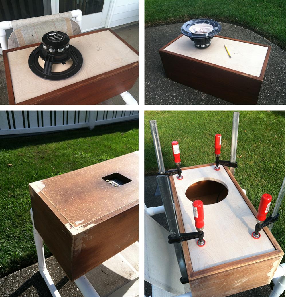

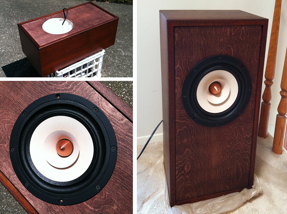

Well, I've read such good things about the Jordans that I'd be tempted if it weren't for their cost. I'm still tempted despite the cost, and when I can put aside the $ for them, I suspect I will. Meanwhile, my $20 Pioneer BOFU drivers in a TL still amaze me.
TB 1808 in a simple sealed box. Will go deeper in a larger ported box but these need to be apartment friendly. Very detailed and natural sound.
.8cf - F3 95hz / F10 55hz.
