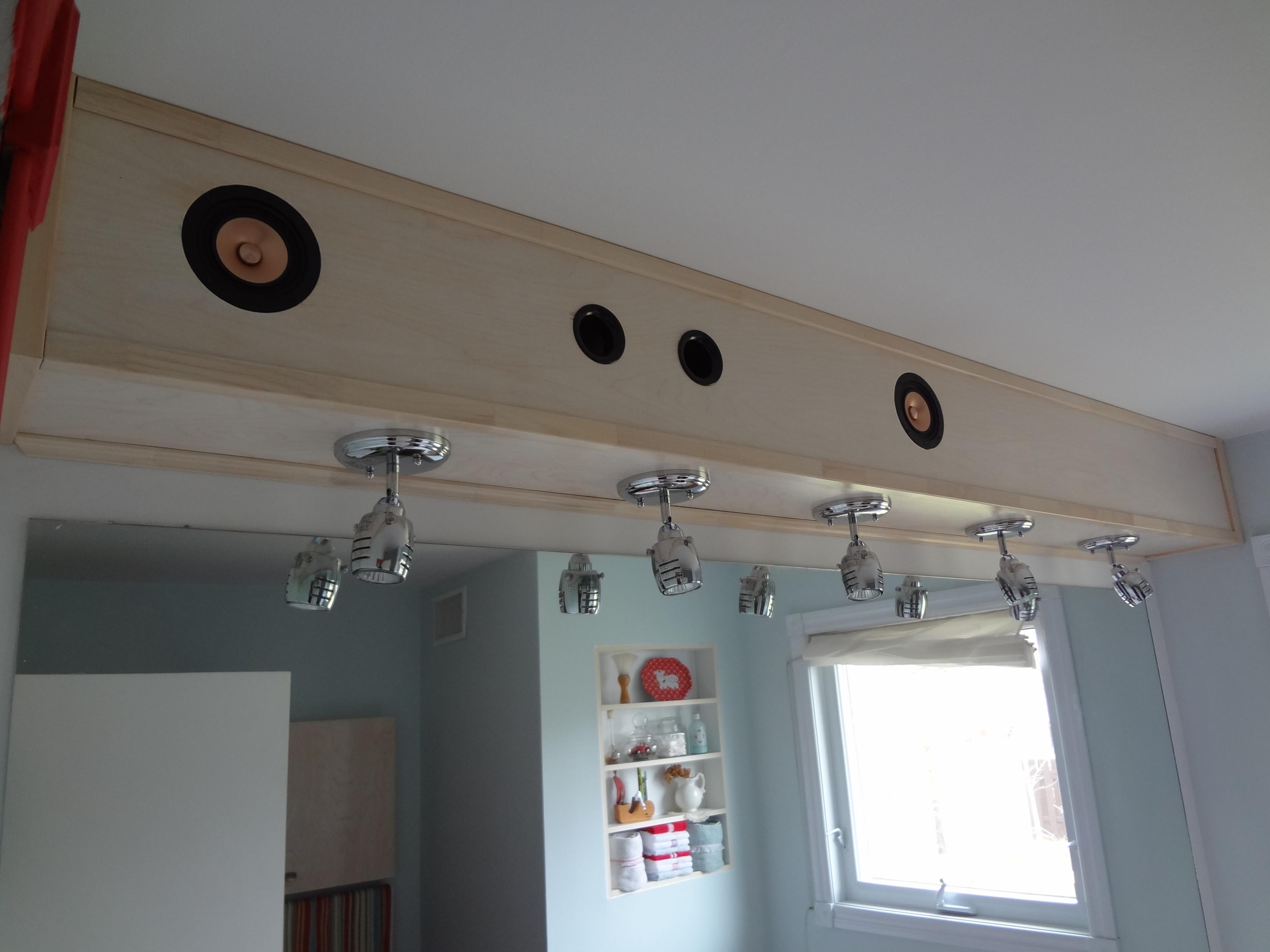

Full range in bathroom
Just thought to share this little project in a bathroom. Done with Markaudio CHR70 and with a dedicated amp. Sounds great for that place !

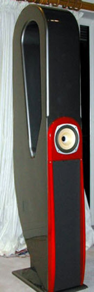

I built my Hedlunds ten years ago and I am very happy with them. They have AER full range drivers. In addition the midrange is crossed over to a Raven ribbon tweeter at 2 Khz with a gradual slope. This removes some of the abnomalities from the whizzer cone. The tweeter is not horn loaded but very efficient and is located underneath the AER driver and is hidden behind the grille. (see pic)

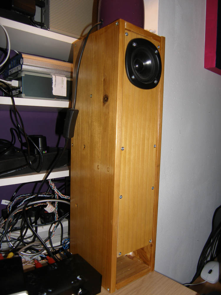

The drivers Audax full rangers cost me £10 for the pair the box a Voight pipe was built from an old shoe rack. Amazingly for such a non optimised design I get down in to the 50hz reason about 3db or so down in a sealed box it was around 100hz. For £12 I am well pleased had to get some more wood glue.
