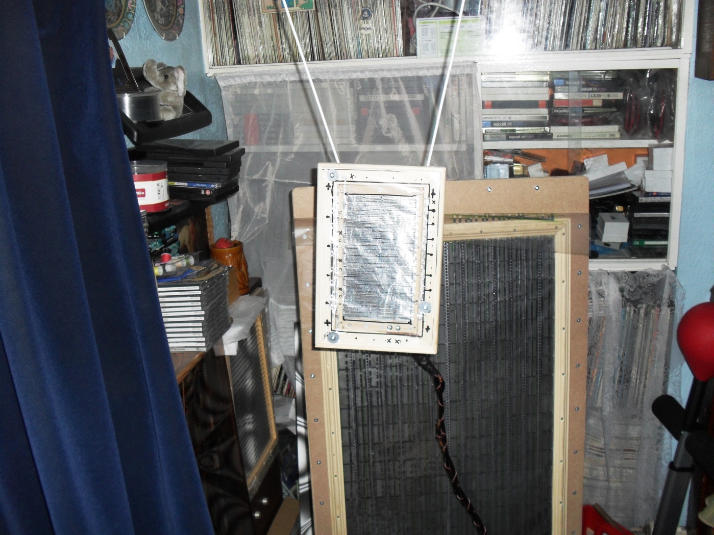

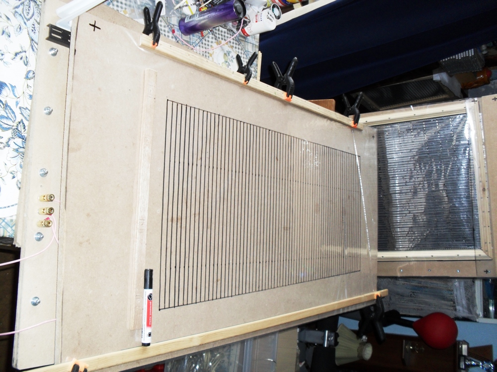

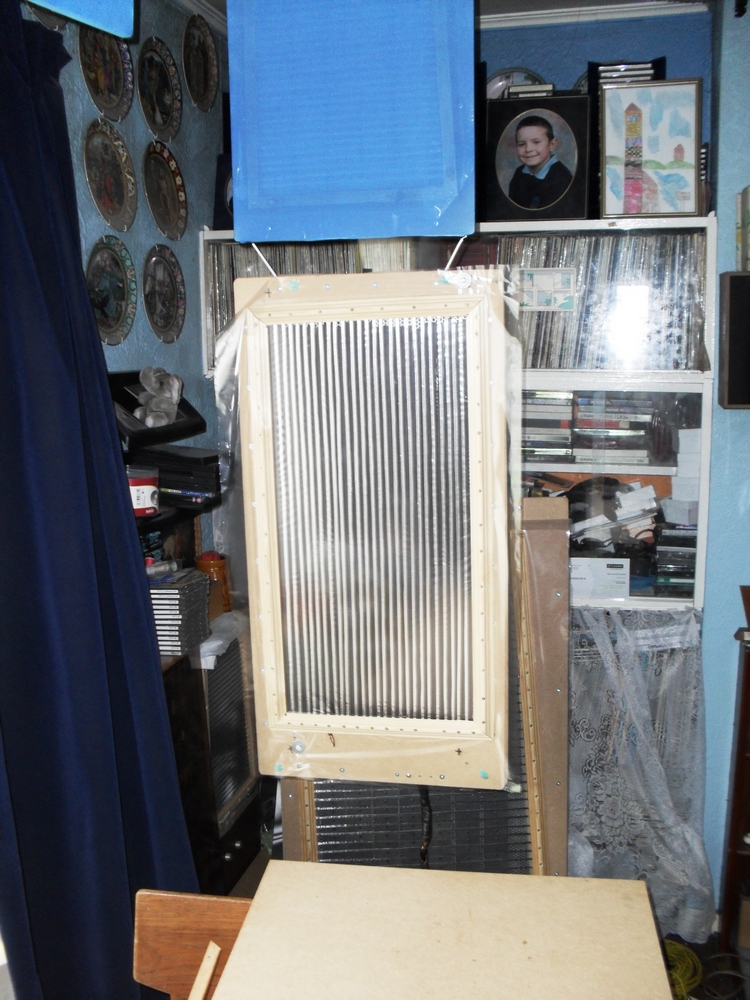

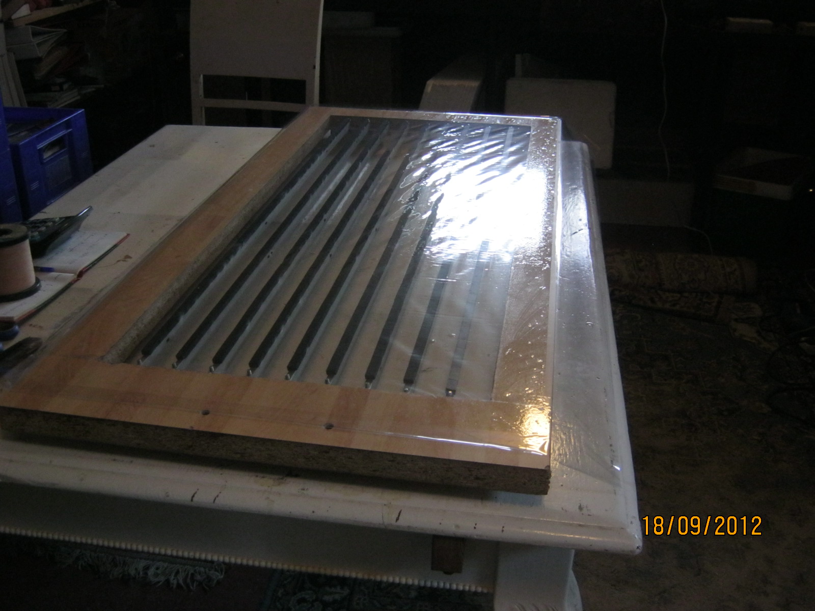

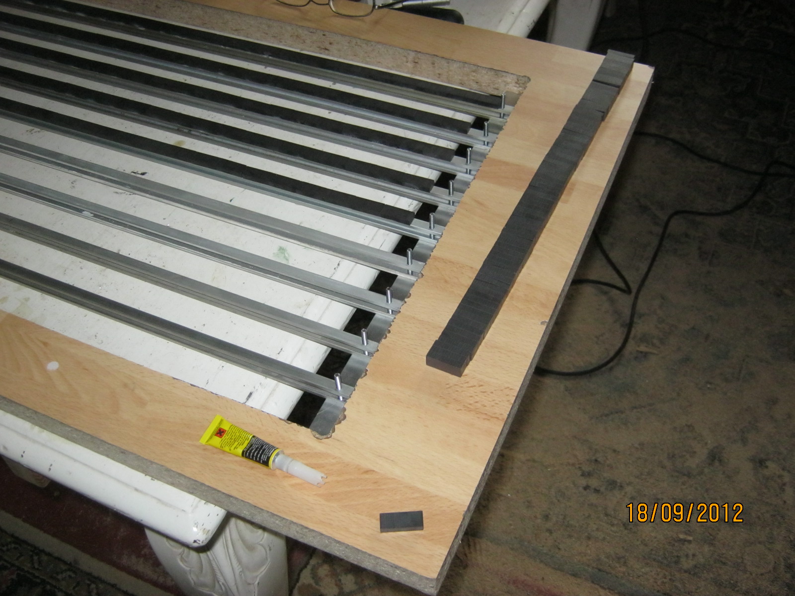

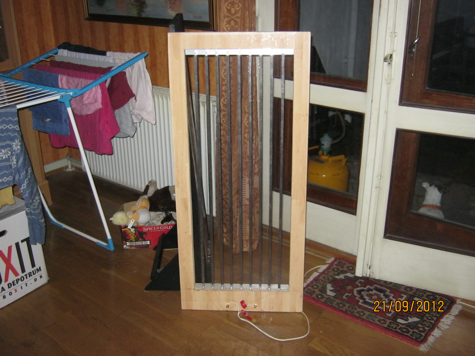

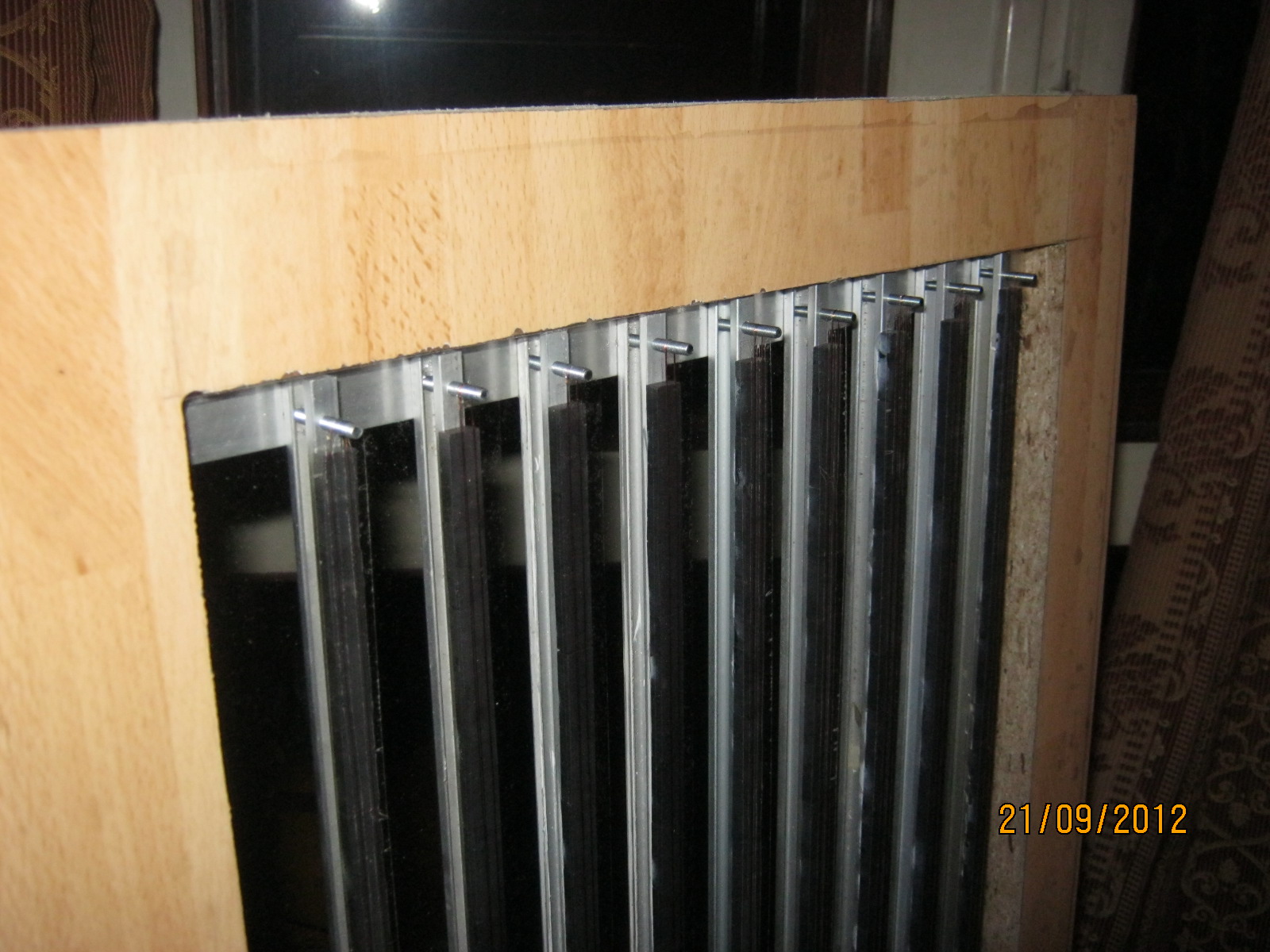

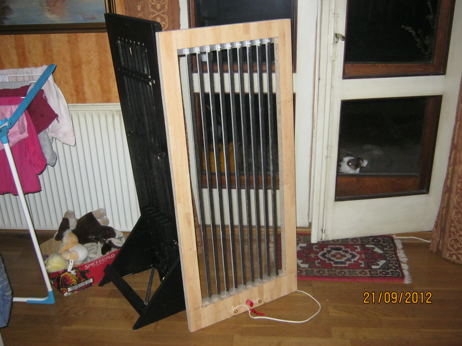

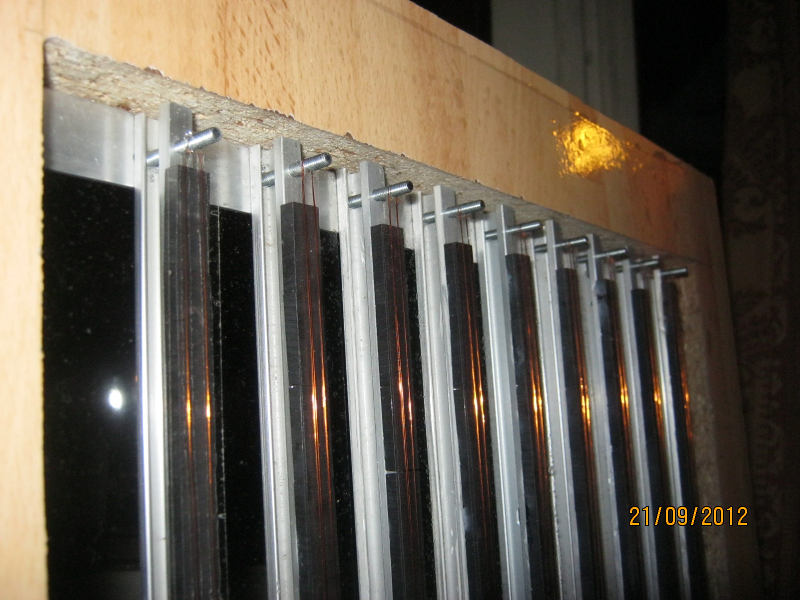

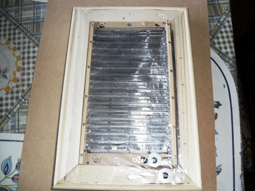

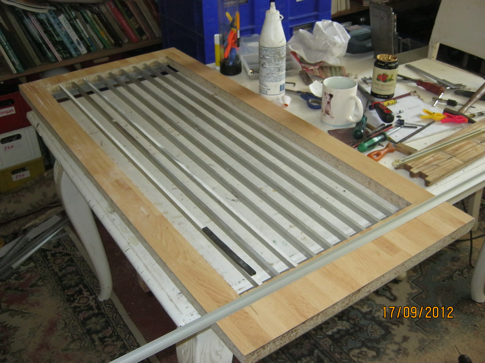

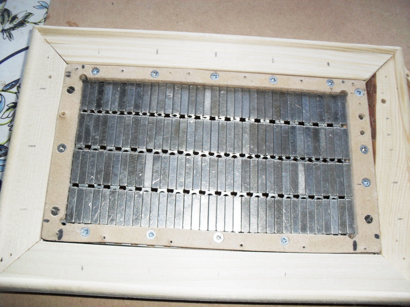

Have decided against building anymore EPSILON style layouts and I am using 3mm tape now. Easier and just as sensitive, you live and learn, it's also a lot easier and quicker. My back is happier as well. I still have alot more rebuilds to do with the new tape.All the blue ones 9 of them. I will finish my headphones one day. I have finalized the 2 designs at last. I will have to swap ears to find the best layout as I have 2. The A4 size design is only half finished 1 more to build.When I get my carport I will be putting 2 on the wall outside to try. Big ones 4' x 2' with acoustic insulation at the rear.Any suggestions would be appreciated.
Where have found 3 mm wide aluminium tape? What is the thickness of the aluminium?

themaskingshop.co.uk is the place to go for 3mm tape,The thickness is 6/100 of a millimeter.
Thank you. It seem to be 40 µm Aluminium Foil, not 60µm. It can be checked with a suitable multimeter. Just measure the resistance for several meters. Should be about 0.22 ohm/m for 3 mm wide tape.
I did use a multimeter and it is 60um. It is glued and masked very easy to use.Especially to turn, you don't need it any thinner, else it will rip when using. Have done that a few times using the CPC 9mm tape and the 4.5mm tape when I cut it in half. Easy with scissors. Glad I don't have to cut anymore hundreds of meters. Not really designed any sub woofers, as the 4' x 2' using ferrites goes down low anyway no need for a sub woofer to my ears. The bass is very tight and non resonant compared to the QUAD ESL's. I have these as well. Much prefer my own designs in comparison. A lot easier to build and repair as well.Only £1.66 for 60 meters very cheap.Flemings left hand rule explains how they work.

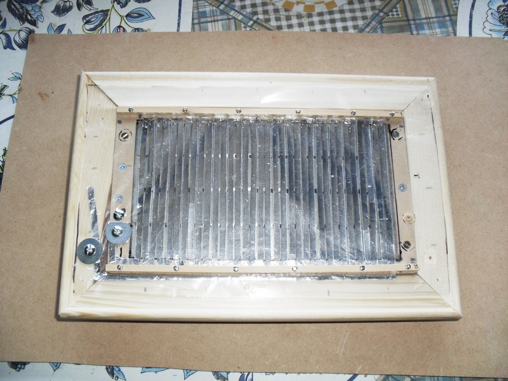

Too much work involved for no return, the difference in the impedance was the driving factor. Which I completely overlooked, which is typical for me, being a right thicko.Too much work all that tape especially at my age, and my back's not getting any younger. The 3mm tape I use now is a lot easier to lay.As long as you run a roller over it which is important with the glue used by the manufacturer. I don't have to cut anymore tape in half or quarters anymore, which is a welcome bonus.I always rush things without giving much thought to important parameters, woe is me!!! Still it keeps me busy and occupied. I will get on with my next rebuild after breakfast.

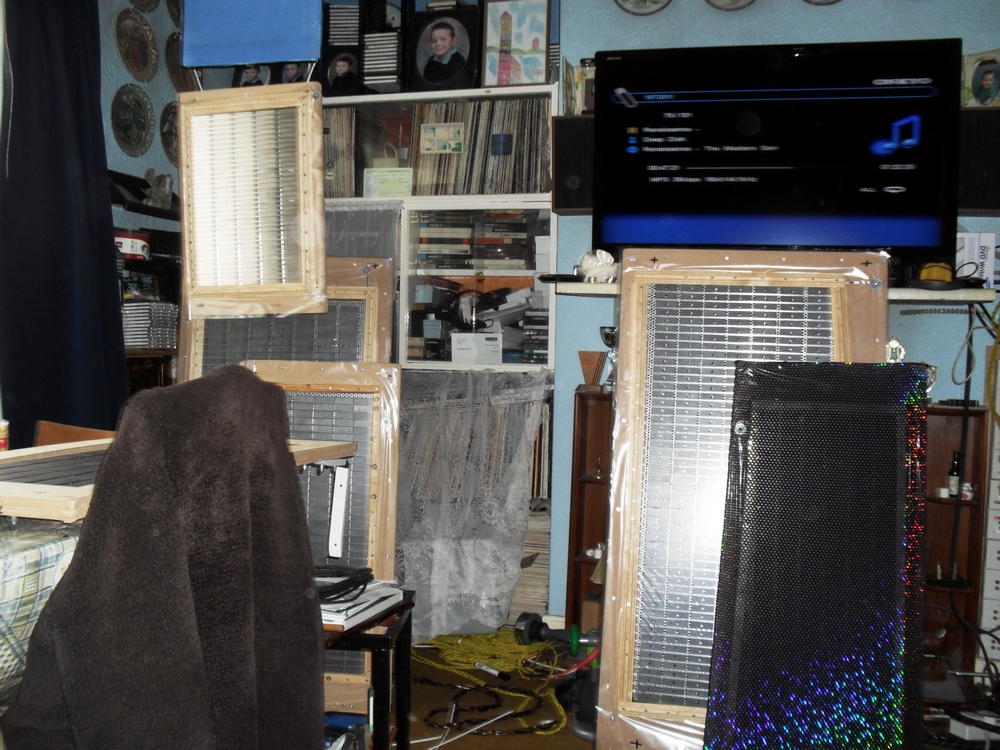

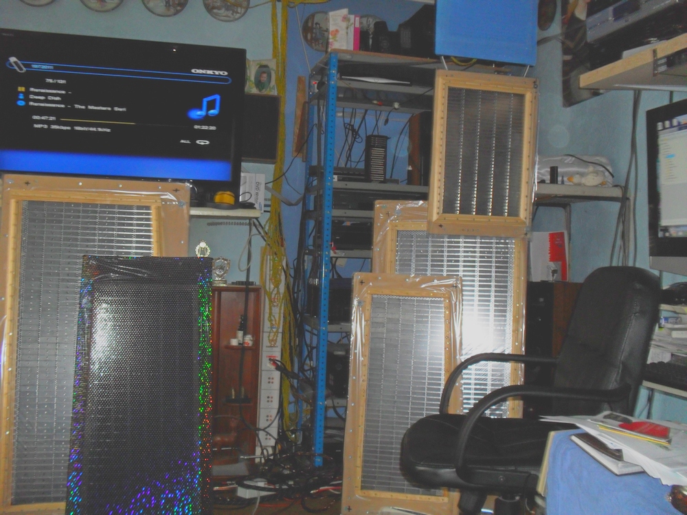

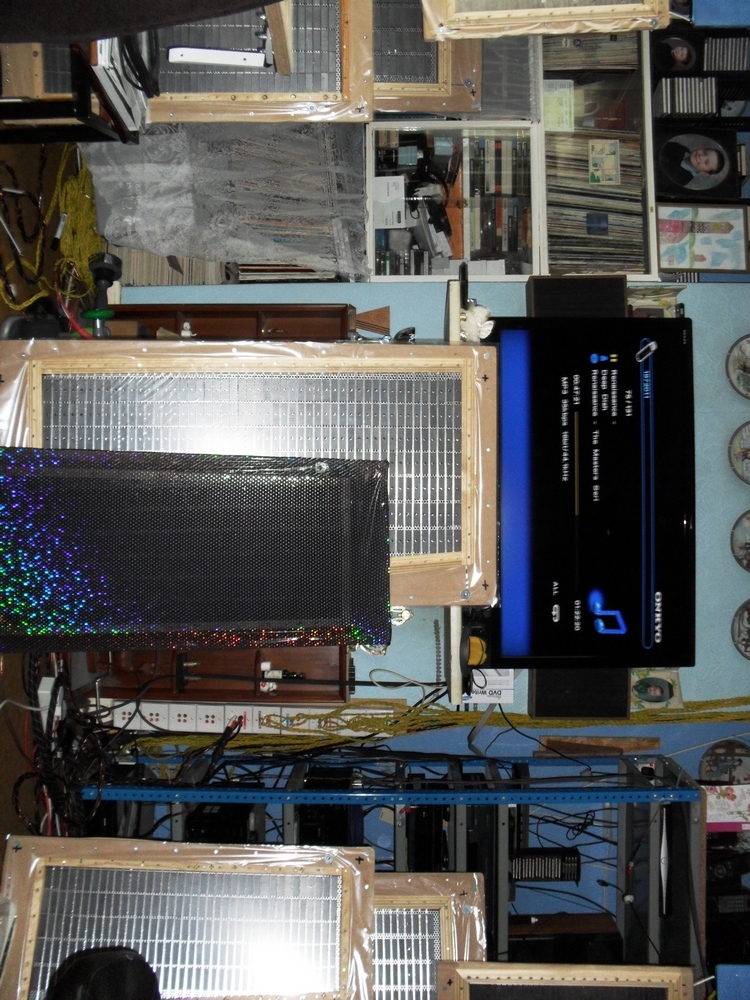

LATEST REBUILDS
Latest rebuilds only about another 15 more to go. Latest one on table to make up the small pairs on the floor. Then the 9 blue ones hanging up, will be the next rebuilds. After that a few more here and their.Then I will have to think of something else to build, perhaps an electronic piano layout and then a pair on the wall outside. Or an underfloor loaded full range planar now I have finalized my design after all these years! Should keep me busy and out of mischief.

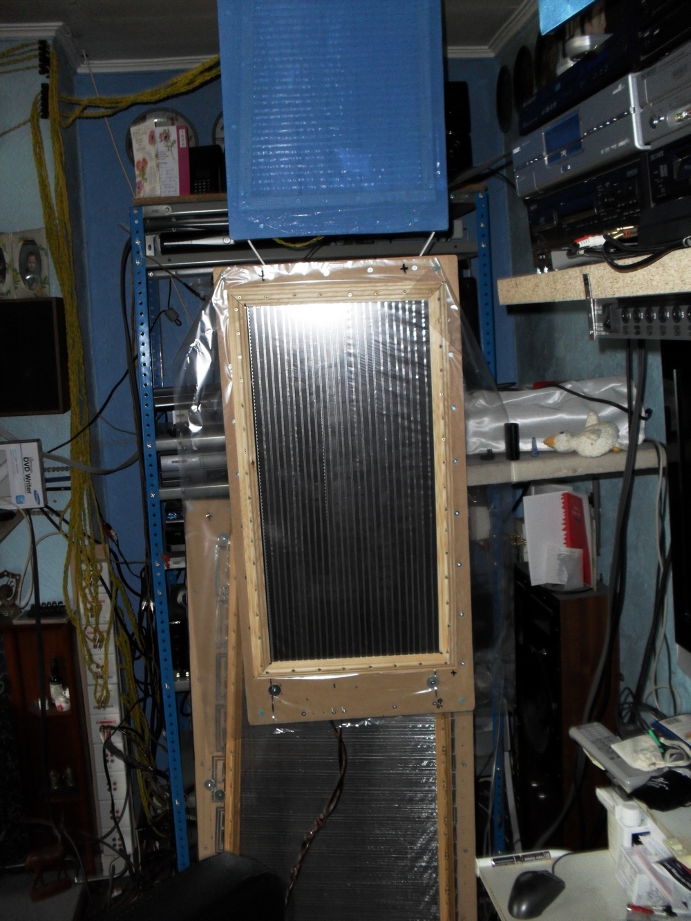

Have stripped 3 more rebuilds, but I am waiting for some more 12um mylar C. Finally getting organised and making impedance the same within .2 of an ohm. So I get a good pair or a good 9 with the blue ones.Am playing 2 of my rebuilds and they sound great. The tightness of the diaphragm is very important. If not drummy all round you get terrible resonance, so make the diaphragm tight all round. I think finally I have arrived in Nirvana at last. No more re-designs at last.As I said I might make an electronic piano out of 3 diaphragms, should be an interesting and stimulating project.If I lived in a detached house I would build an underfloor loaded full range planar. The bass would sound awesome..I did build cone underfloor loaded speakers but the bass was too loud and shaky for the people next door, plates fell of their shelves.

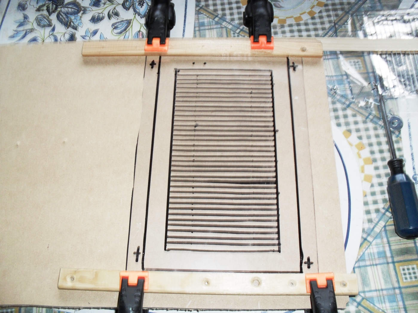

Here is some picture. My english is not so well.
