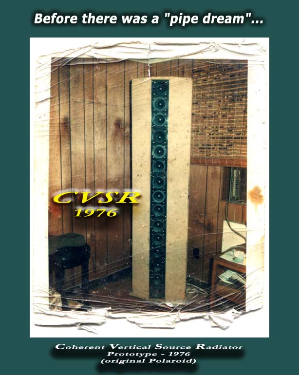

If you go to my website (which has not been updated in a long time now) and look at the Archives section you can find a box called the CVSR... from 1976. It worked great with EQ on the bottom octave or so and a tweeter (not shown).
CVSR image
After that I made some speakers that were in Speaker Builder mag, that used a similar concrete form tube that I sliced in the front and glued a 1/4" masonite baffle on that, cast some concrete tops and used a PR for the bottom... made a two way that way using a pair of Goodman's Maximus drivers and a Panasonic leaf ribbon, and another version with a single Audax 5.25" driver & the same tweeters... later added the Focal T60 tweeter... still have a few of them around the lab... but the idea was to build out into a line array when I started those... I went quick, cheap and dirty with the construction: hot glue and flat black paint with open cell foam wrap!

Very pretty, bear. How does it sound?

carpenter - it was a very impressive speaker - that was without any finish on the particle board (pressed wood chips)... it had the uncanny effect of sounding very very "un-loud". As you cranked the volume it seemed like your seat was moving closer to the stage, the sound got "bigger"... nothing more. At that time we were using a Phase Linear 700 to power it, and with the EQ, the meters would jump when it was cranked... that set used early Peerless 5.25" drivers - in those days TS parameters were very new and exotic, and difficult to use... quite frankly I guessed and got it pretty close as far as the box volume.
