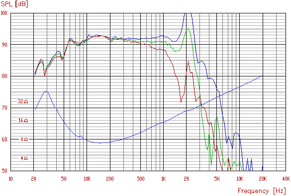

There are a lot of reasons I oppose full range drivers-intermodulation distortion prevents even one with a perfectly performing cone from really doing well-but a 15 inch full range driver is really out of the question.
This graph is for a Vifa 12 inch-a 15 inch would be worse. Look at the dispersion curves. Even at 1700 Hz the 60 degrees axis line is way, way over 10 dB down from the on-axis curve.
The only reason this speaker-which is not designed for full range use-is not worse, dispersion-wise, at high frequencies is that the cone has so completely broken up at the high ranges that the high frequencies are being radiated by small sections of the cone acting independently of the larger cone at a whole. A speaker designed for high frequency use will have less cone breakup, therefore worse dispersion.
A large diaphragm, no matter how perfectly manufactured, cannot give good dispersion for the high frequencies. The high frequencies will "beam" forward, and the high frequency sound will be harsh.
