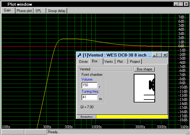

i found these full range speakers that are dirt cheap, 5 dollars each. they are 8" with the ff. specs.
Paper Cone. Foam Surround. Whizzer for extended highs.
Z = 8 Ohm (7.1 Ohm dc)
Freq. 50-20KHz (±6dB)
Fo 54Hz
Sens' 91dB
Magnet 8 Oz
Power 30W nom.
Voice 25mm
Qms 2.32
Qes 0.91
Qts 0.65
Vas 47.11L
Zo 24 Ohm
Sd 0.022M²
http://www.wescomponents.com/Speakers/dualcone/Dc8-30/dc8-30.htm -picture is here
the magnet seems to be so light 9 oz only. so any ideas what i can do here? maybe get 4 of these and put it in one box? and also can you please help me get a box design for this driver. what size, ported or sealed.
based on the data, is this a good full range speaker?
thanks!

The data doesn't tell us much about how it will sound except in the LF. Some cheap FR drivers are 'diamonds in the rough' so they require a number of tweaks to sound worth keeping. Rabbitz sounds as though he has personal experience with them, which I don't, so as always, YMMV.
Anyway, this one models surprisingly well in a ML-TL (at least with the published specs), near 95dB eff. and extension to 30Hz, so if you want to gamble some time and wood on at least one prototype to see if you want to expend any more time/$$ on them:
55" x 13.88" x 8.63"
driver down 18" from top
all dims inside
4" dia x 0.75" long vent near the bottom
~31 oz of stuffing distributed from the top down to the bottom of the driver for a first approximation.

Qts is too high for a reflex speaker unless its huge.
Suggest you put two in a box 35 to 45 litres.
Remove the 'whizzer cone' from the lower one and experiment
with various inductor values to roll it off to give baffle step correction.
Run the the top unit full range.
At $10 a side seems pointless to spend too much on the cabinets.
:) sreten.
Big box necessary, but so what? The thing is, hardly anybody puts a small cheap speaker in a good box. That's why almost everyone says you will get crummy results. Because they used a crummy box. :rolleyes: Put it in a good box - I have a pair of WES DAi-1chi SP8-100's, $30 ea in a pair of 245 litre boxes and they go down to 30Hz and surprise everyone that hears them.
BTW, my catalogue says $14.50. Are they on special or something?
