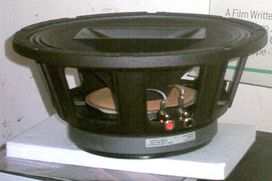

Beyma 12GA50
Eminence Beta 12 LTA is more of a +95db kind of thing.
The previously mentioned Fane 12" 250TC and 15" FC152, aside from the single wizzer 12".
Any more to add to the list?
Edit:
Sort of tempting to do a single driver battery powered mono amplified 35 liter closed box with the Fane 12-250TC and eq it flat from 50hz-10khz. Just to lug around.

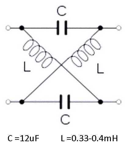

Hi KaffiMann - I once tried an allpass on my Eminence coax woofer section - don't know if it was just a better summation, but the tweeter seemed to mesh better. These Eminence ran about 99dB sensitivity with 80oz magnet and 2.5" edge wound coil. I have old Beyma 12cx which are much nicer than Beta12cx.
