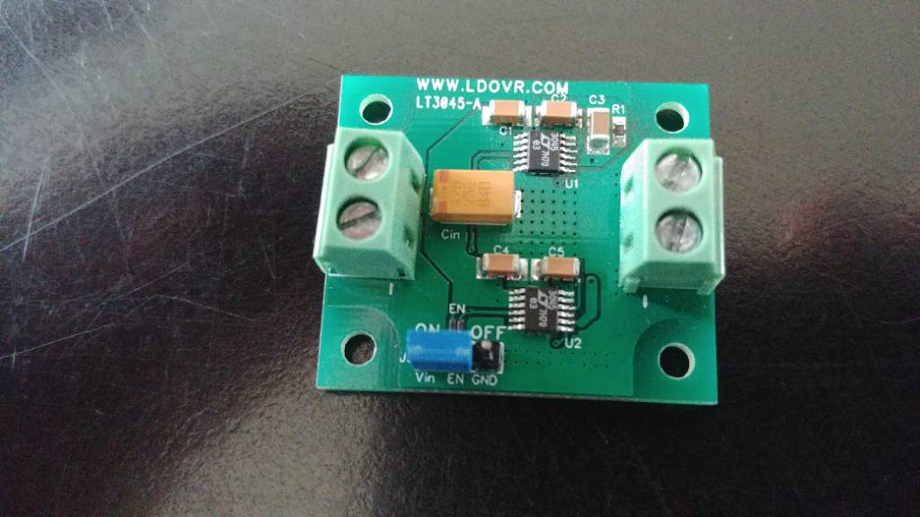

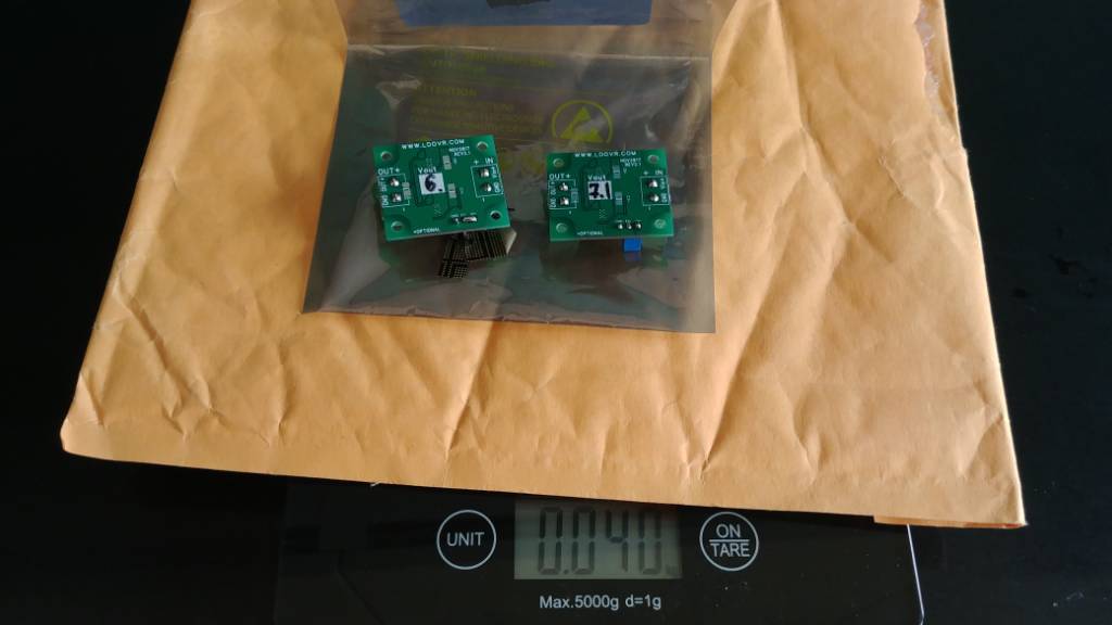

Hi, I've got two LDOVR 1A LT3045 pcb's for sale. One is 7,1V the other 6V. They fit well together. New 30 euro each. I sell them together for 25 euro. Postage within Europe is only 3 euro's. View attachment 742663 View attachment 742664
Wrong topic. Try Swap Meet.
