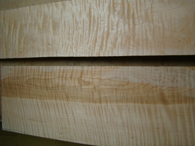

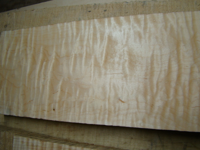

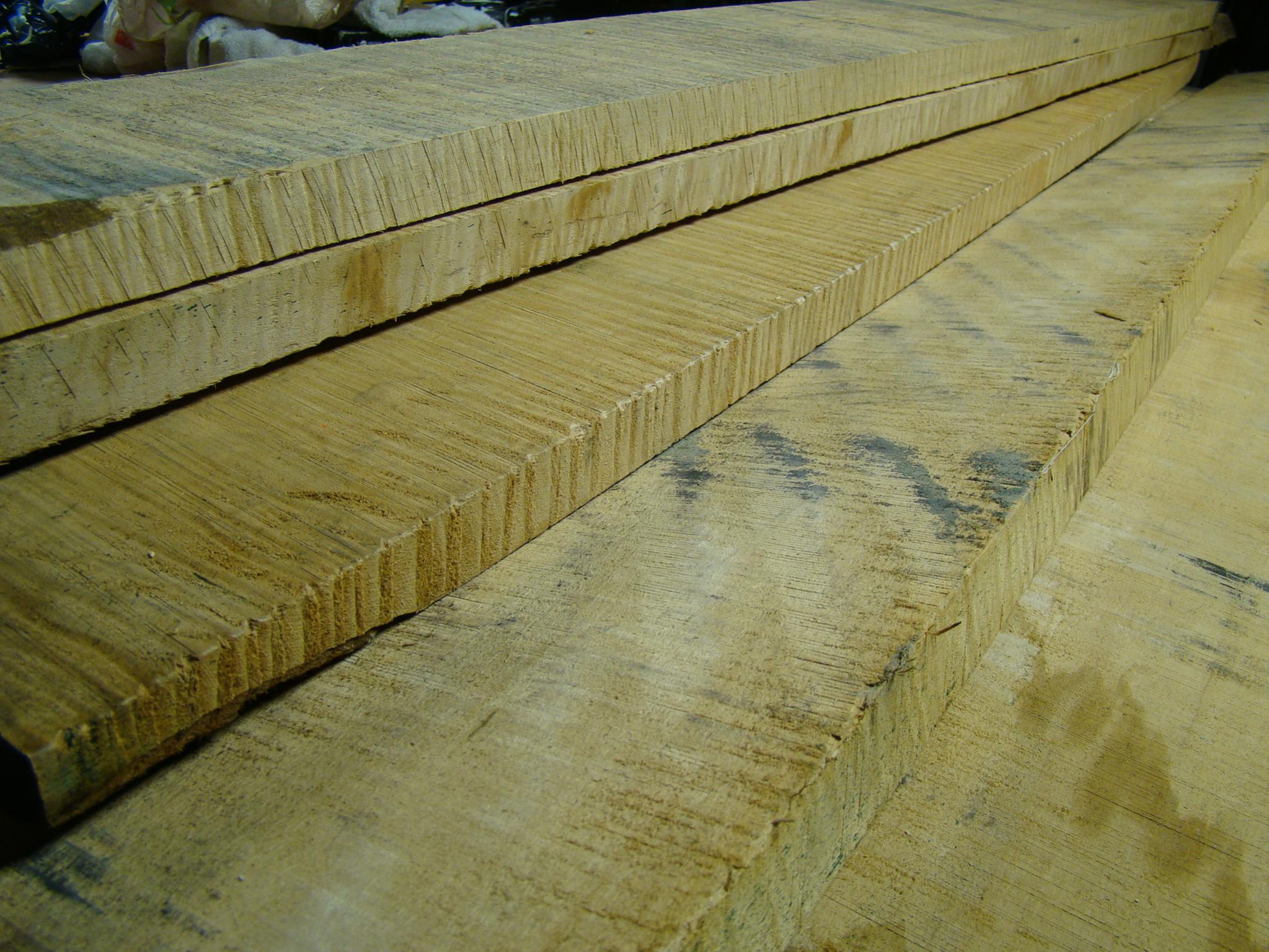

A little hard to tell species from photos (not my strongest skill at best of times), but fairly standard 6 or 8/4" raw planks from which I'd guess Evan will mill / square up to rough working thickness, glue up for slabs, and finish to final working thickness. Such prep time is only one of the fun parts of working with solid material that sets a journeyman joiner apart from the rest of us .
Evan - maple?
Sorry to have dropped off the planet on this one. Had to finish the customers pieces first. This is some of the nicest curly maple I have gotten. All a very plump 5/4".
Now on to the fun...
