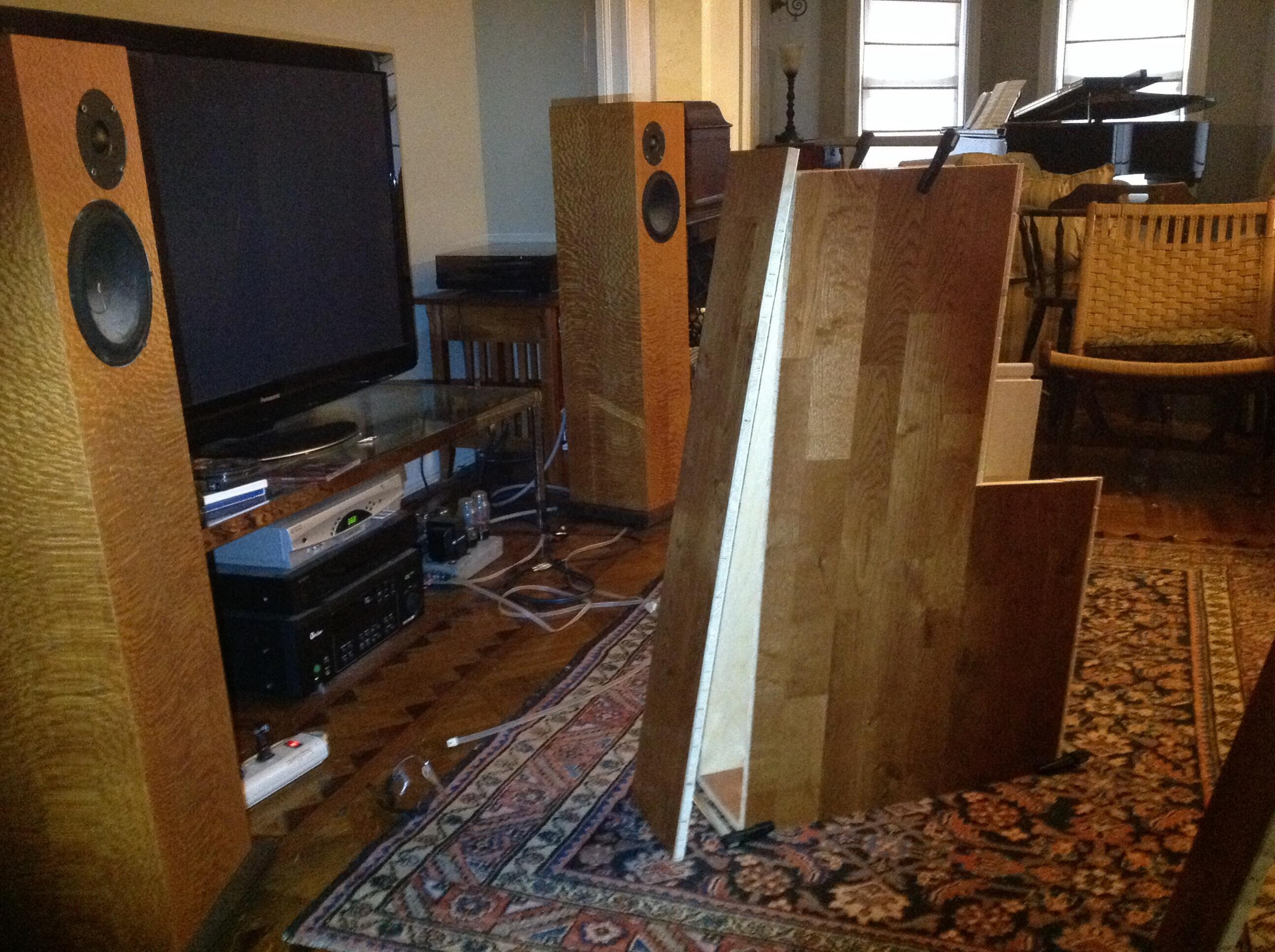

Here's a pic. I still have to cut the template for the curve. And since someone will ask, my main speakers are Proac 2.5 clones with Australian lacewood, the tubes are 6B4G in the amp, there's an Aikido pre-amp under the Rega turntable. The best sounding equipment in the room though is the black Yamaha by the windows. The only distortion from that is your untalented poster banging on the keys.;)

So. I have built my frugel horns with mark alpair 7 drivers. Before I glued one together, I dry clamped all the pieces together without stuffing to test the sound. I was blown away!!
I've since glued one together and put stuffing in the rear chamber, and wool felt aroud the driver. All of a sudden, the sound is not as lively? Has anyone else run the Frugel's with no stuffing? I'm contemplating ripping it all out as I prefer the typical horn bass sound.

I didn't put the stuffing in one of my builds a few years ago when I first tested them, and thought the same thing when I finished. Ultimately though the sound was right with the stuffing and waaaaay too bright without it.
My A7.3s arrived today but I don't have all the panels fully cut to size yet. Maybe this weekend... I'll clamp them together to see how it sounds.
I've just started building. The first three pieces are glued and clamped. I'm not sure, again, whether I'm reading the stuffing guidelines correctly or not. How much goes in the wedge. Is it just an ounce (doesn't sound a lot) or is the note on the plans just telling me that 1 Oz = 30 g?
