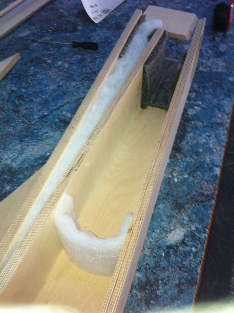

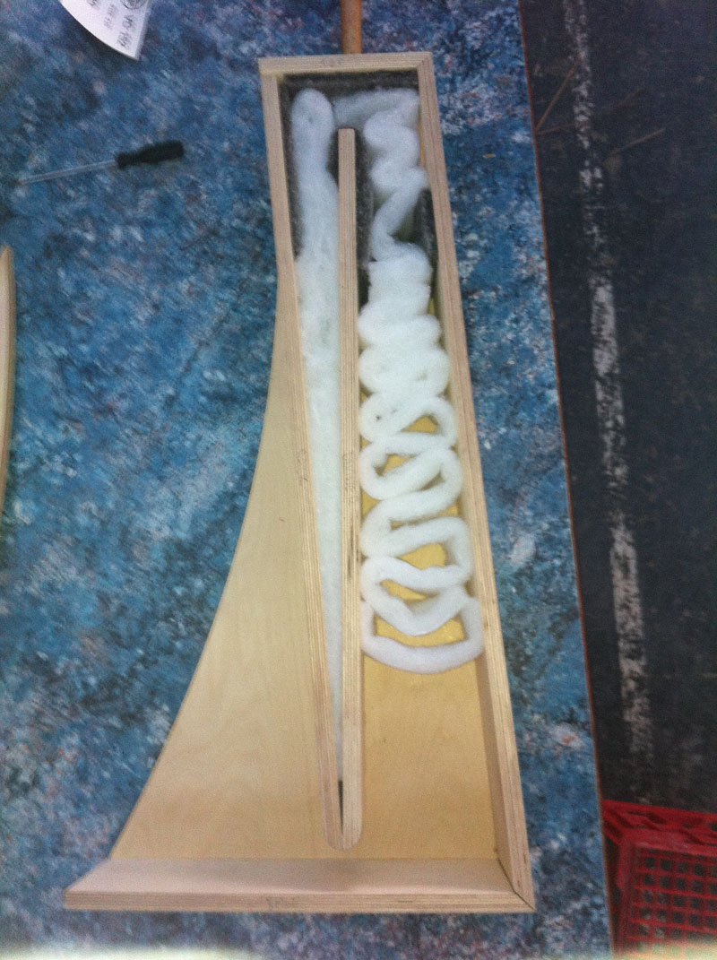

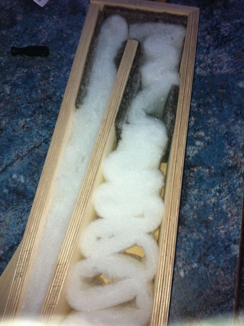

Hi all
I'm most way through a FH3 build. Managed to find answers to all questions through the various threads and some very helpful email support from Chris.
Still a little hazy on the damping however. Refering to the pdf plan and pictures throughout this post I've given it a go, just wondering if someone could look at these pics and tell me if I'm on track?
I have increased the density toward the bottom of the V and spaced some out below the driver. Any good?
Cheers dave. Second post was a repost, I didnt see the first one come up.
I'm making the top removable for adjustment. It would be best of course to get it close to correct first time round though.
Jdot, having a removable part helps, so good call!
