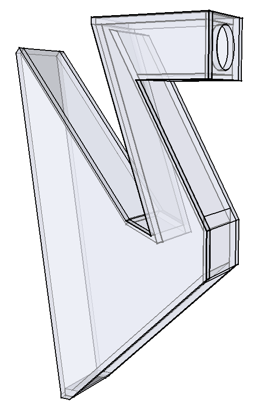

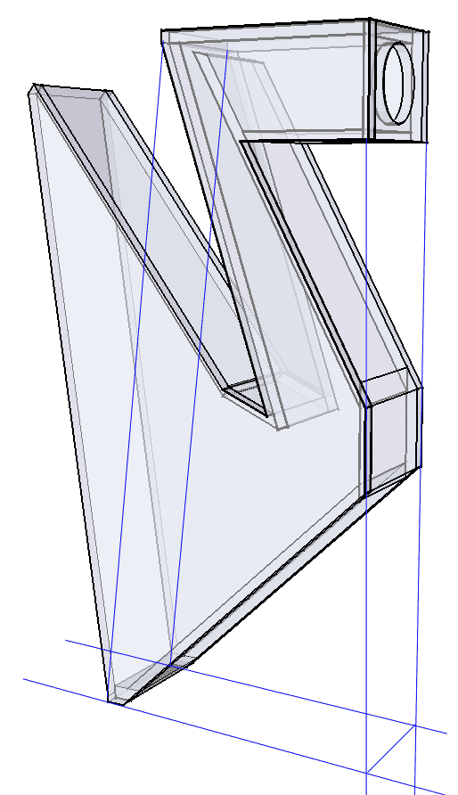

Frugel-HornBVR Mk 2 0v1 (aka The Duck)
Well i made a start on turning Scott's BVR version into a drawing... we have a ways to go, but what i ended up with is cool enuff to post for a lark.
dave
