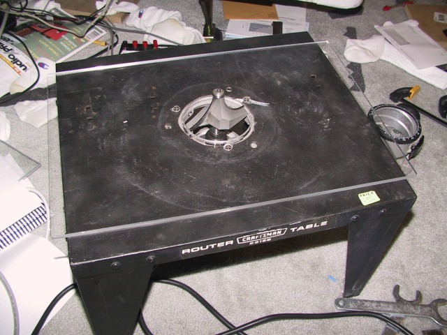

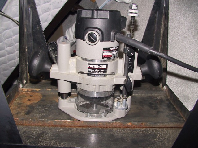

I would recommend not to use the 1 1/2" radius it by hand. I find it to be quite unsafe. I picked up a $2 old craftsman router table at a flea market, and cut a larger opening it, and put a piece of plexiglass on top, and it works great on a budget.
Here is a picture of the top of the table:
The key to this bit is to take your time. If you try to go too fast, it can tend to chip off chunks of mdf. It also removes a lot of material, quite quickly. I am thinking about getting a variable speed box for my router.
