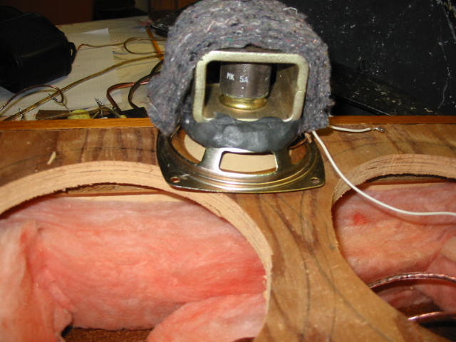

What is that whitish tape stuff around the edge of the basket (pic6)? & why?
Its self adhesive rubbery window seal stuff that I have had on the driver to seal it into my backhorns.
Is all that blue wrapping to suppress reflections back through the cone?
Yes it is, although i suspect its not a particularly worthwhile effort (its just felt), something heavier would probably be better.

I noticed you don't have duct seal between the basket and the magnet. Are you planning to add it?
Do you think this is a worthwhile mod? If so where do I buy it, I've done about everything else to these drivers already so am willing to give it a whirl.
Is the felt permanent or are you just trying it out?
Well perminent untill I get my hands on something better. Its only held on with double sided tape so easily removed - offered marginal improvements in my backhorn.
I think it's important. You can see it in the pic on top of the basket. That is a Foster 10F3 ala planet10 mods
