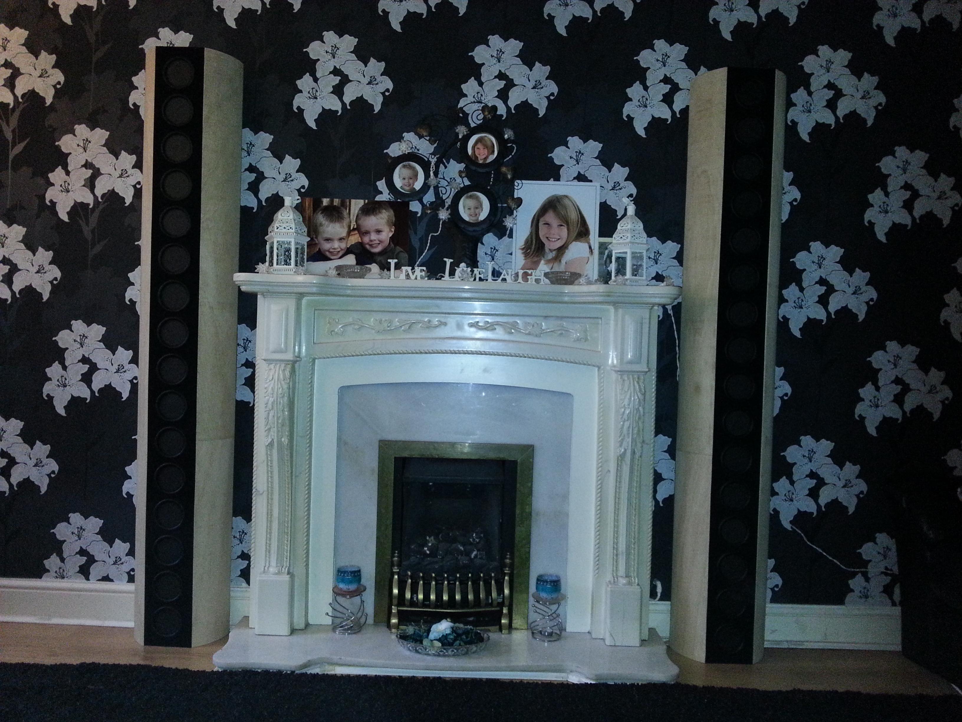

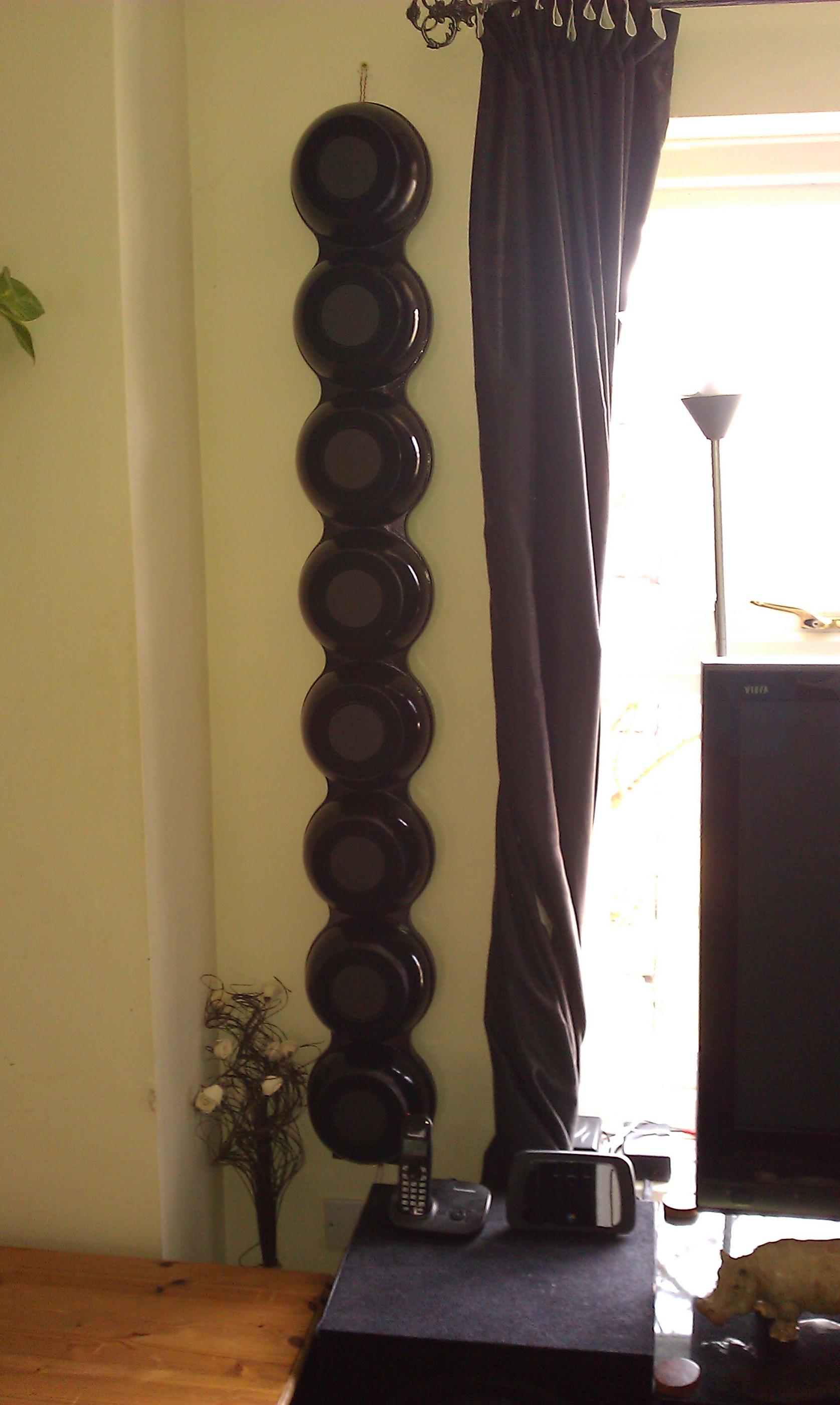

I am also trying to get rid of as many boxes and cables as poss, my speakers are " hang on the wall" and I am building in the DAC's and power amps into a slim power pack which fits between the speakers and wall, the whole lot is less than 8 inches deep.
The attached Zetex is a great bet for a one box solution, power / DSP / DAC's / Room Eq, / crossovers etc.
I know of one UK manufacturer who has just ditched a suite of TI
DSP and amp chips in favour of Zetex, the technology is very clever and the eval board I heard was very good.
