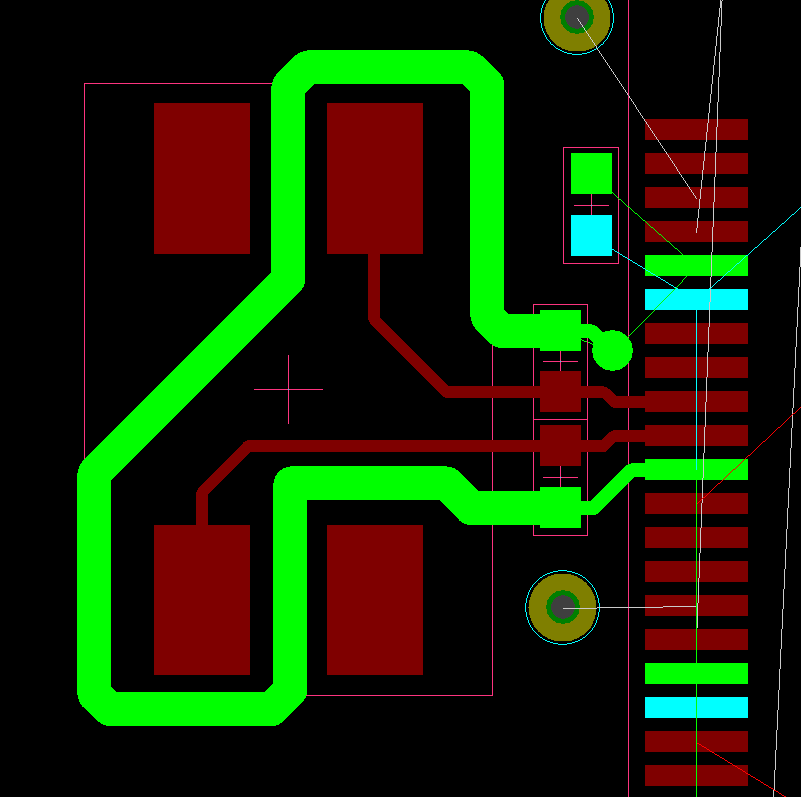

Hi everyone. This seems like just the thread for me, as I was going to come and ask advice in getting every bit of sonic performance out of my boards.
I've laid out this PCM2706-based really simple USB DAC and I'd like your opinion on the board. Does it look ok? The bottom side is all continuous copper. I have little experience in dealing with analog signals on PCB since I'm a more digital guy. It would be especially interesting to hear about what kind of capacitors to use or not to use, where to put them and so on. I don't want to lose any sonic performance because of bad PCB design.
I don't have a schematic to post right now but will post that later today.
Firstly, the PQFN requires more vias down to ground, preferably 1 per ground pin.
Whare are the power tracks!
This is digital mainly, each ground pin should be viaed down to the ground plane, not routed to star points.
Move the capacitrs on the crystal to the otherside of the crystal and minimise the track length.
Put a ground guard ring around the crystal signals.
Turn C22 around.
where are the decoupling capacitors!

Possibly tweek the QFP footprint, the PDF is for an IPC-7351 (Industry Standard) footprint.
Also look at some of the routes going into pads, 90 deg into the pad is prefferable, then add a 45 degree bend, otherwise you can create acid traps.

Thanks for your input! I have tried to implement all your suggestions in this revision. Does it look any better? Ground and VCC traces are wider (25 mils vs. 10 mils). All the grounded pins now have dedicated vias, the crystal has ground pour as guarding and the capacitors on other side. I also tried to remove all the non 90-degree entries from the pads to avoid acid traps. The schematics are attached (the resistors have capacitor symbols because I didn't have a 1206-sized resistor part at my library, lazy me, so don't mind that). C9 and C4 are the decoupling caps.

Again beef up power tracks, and swap the position of X1 with C6, C10 and R3, the caps and rsitor between the IC and the crystal, what you have now is a stub with the caps and resistors hanging on the end. In a rush at the moment, but I will find an example of a crystal over the weekend.

The file 1-xtal.png is an example of a crystal, using a 5x7 package instead of the SMD HC49 package.
The file 1-lay.png is a snapshot of a layout showing some power tracks and signal tracks to give you an idea of the relative sizes.
Most boards I do are multlayer, so always have power and ground planes. On a double dided board I always use the bottom layer (non component side) for the ground plane as this gives the best contigous unbroken ground plane, and put vias down to this plane for ground connections. I would also copper pour ground on to the top layer once I have finished routing the board.

Some more comments, sorry.
These are refinments, what you have is OK and I have seen some proffesionaly designed boards that are less attractive, but these are the icing on the cake.
Turn C7 and C5 180 degrees, you can avoid the track between the pads, best to do this where possible on samll MLCC caps.
Align the pins of C13, R6 & C14 and run a track straight between the pins.
Rotate R10 90 deg and avoid the split in the route.
Rotate C1 and reposition slightly, again to avoid route between pins.
REMOVE Thermal Relief from all vias, it is not needed.
Rotate R7 and put in line with connector, straight routes again.
Sorry for being pedantic, but these little changes will clear the layout up.
