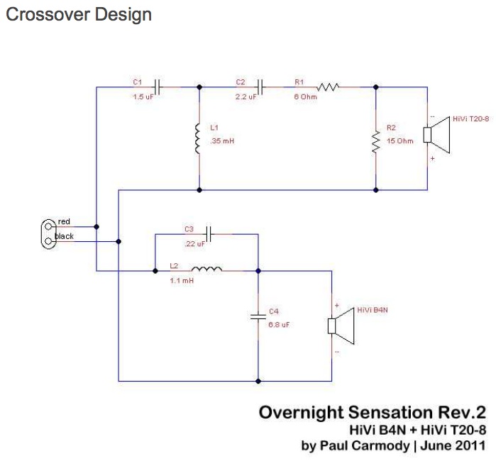

I'm looking at building a pair of simple and good-value 2-way bookshelf speakers, such as Paul Carmody's Overnight Sensations or the K&T Cheap Trick CT 248 with SEAS drivers.
I've attached the crossover design for the Overnight Sensations. Could any of you help me understand how to make the active filter based on these components?

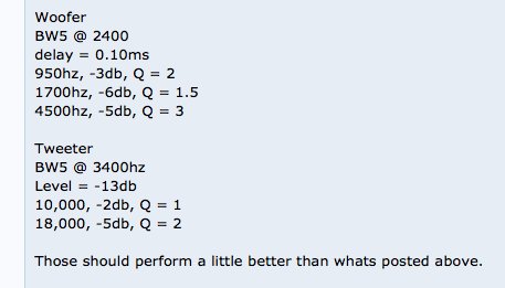

Hey Soren,
Tuxedocivic (Ryan) did this very thing for me. You can see his measurements and settings here: LINK
The settings he recommended are:
Woofer
BW5 @ 2400
delay = 0.10ms
950hz, -4db, Q = 2
1700hz, -7db, Q = 1.5
4500hz, -5db, Q = 3
Tweeter
BW5 @ 3400hz
Level = -6db
5000hz, +2db, Q = 3
10,000, -2db, Q = 1
18,000, -5db, Q = 2
The settings sounded great. I had the whole thing powered with the miniAMP from miniDSP. I have since burned out one of the Dayton tweeters and Ryan is redoing the crossover for CSS ERT26s.

For Kyles pair of OS, I aimed to improve things by lowering and steepening the cross over. As well as flatten things. I thought it turned out pretty good until Kyle hooked things up backwards and forced bass out the tweeter :p

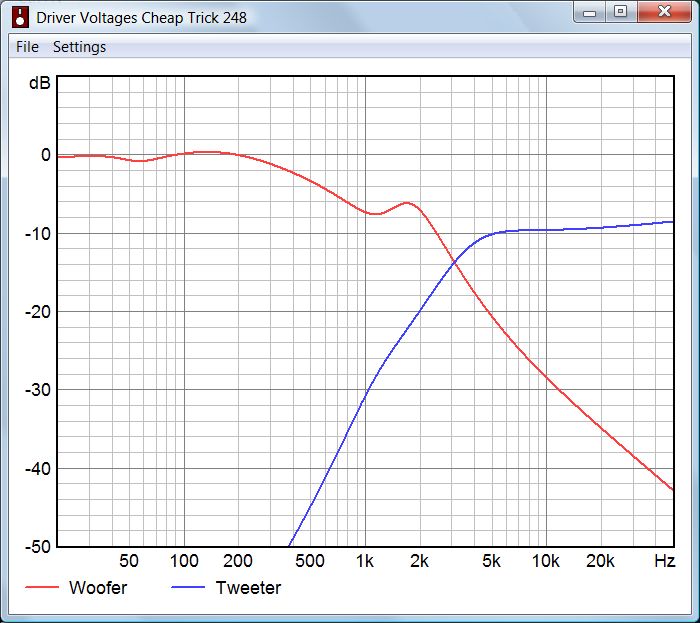

If you can measure the driver impedance (or find a *.zma for it that someone else has done), you can simulate the passive crossover and there you have the transfer curve. You don't need any driver frequency response measurements.

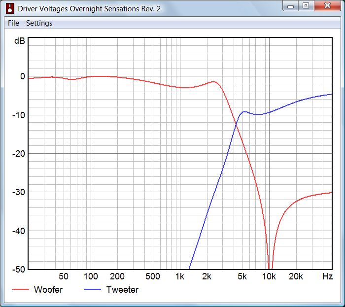

Doing so gives the following transfer functions:
Pardon my ignorance, but what exactly has been done here? Where have you found the driver impedances? And how did you make these transfer functions? Also, how should I go about designing an active filter based on the transfer functions? Sorry for all the questions, but I'm trying to learn :)
Thanks!
It's just the output of a speaker simulation program. Accidentally I had a simulation of both speakers you mentioned, so it was no big deal. That means the program knows cabinet, passive crossover and driver data of both speakers and is able to simulate some results. The curves show the transfer function of the passive crossover. If you manage to get the same transfer function using a digital crossover, then you have reached the goal of converting a passive loudspeaker to an active equivalent.
I see. Thanks for the explanation. What simulation software have you used here?

In the passive XO for the woofer you can see a capacitor across the inductor. This is to build a deep notch at high frequency so as to steepen the filter to meet LR4. This is not an easy thing to do with your DSP. I don't know how the PEQ in the MiniDSP work but you can try. Simply listen to the woofer, does it have intolerable peak/distortion. If so, pay attention to the woofer PEQ setup above XO frequency. If you still cannot bear the peak/distortion then you should consider steeper crossover. Or just compare to what Tuxedocivic has done.

You should note that Tuxedocivic later posted new settings that are quite different than the ones posted previously after actually testing the acoustic response. I have posted them below.
Whether they match the acoustic response of the original crossover is unknown without seeing the individual response of the low and high driver output of using the passive crossover.

From the passive XO you can see that the woofer has issues around the XO, which is why the capacitor across the inductor. I don't know how the inside of the MiniDSP work, but it seems similar to analog. In this case you cannot do tricks like in passive XO. So the 2K4 is possible as a active XO trick but is not a good approach imo.
