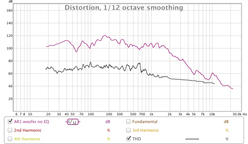

As part of downsizing, I'm parting with an early (1955?) AR-1 (formerly with Pancake Altec driver in it... alas) that I bought used around 1965. Soooo, I thought I'd see how the woofer driver looked full-range on REW on my cheapie SLM at one meter, roughly 95dBC, while sitting in the middle of the floor. Lower curve is THD, about 40dB down and comparable to my other woofers as measured by my instruments, 1/12 octave, 10 dB between horizontal lines.
That should show that young whipper-snapper* what's old about correctly designed audio gear! (OK... I may have added a bit of goop to the cone 40 years ago in the spirit of DIYaudio.)
BTW, 1.4 cu foot sealed boxes don't look so bad, eh. Even if 60 years old.

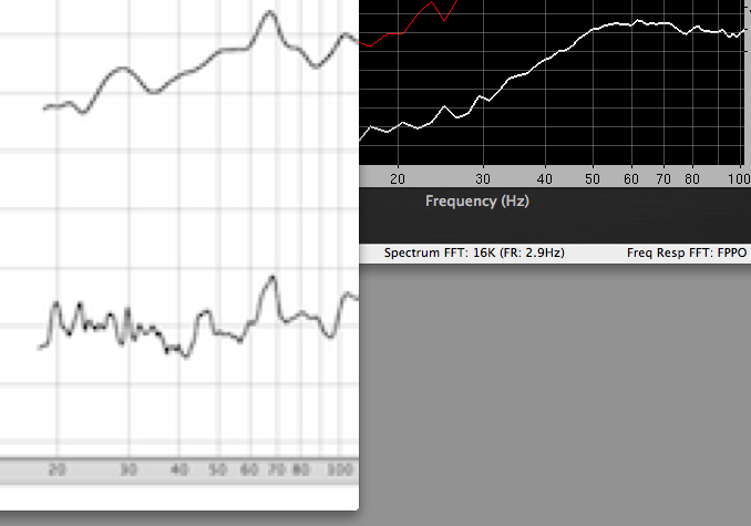

Your AR-1 response would probably look a lot smoother if measured near field, ground plane, hard to tell what floor bounce and room response are doing with the mic a meter above the driver, and the driver a foot (or so) off the floor.
The screen shot below is a circa 1961 AR, measured at 2 meters ground plane out doors (3 dB scale between horizontal lines), compared to your 1955 model.

My 1940s Klipschorn decided it wanted to live in Montreal and left yesterday. Which left me a swell empty woofer corner and woofers abhor a vacuumed corner. Thought I'd update my Truly Ancient and Honourable AR-1W curves. Looking forward to learning observations of any whippersnapper.
My take on the pix: real-world room, mike at listening position. Big dip at 56 Hz shows up on every measurement I've ever made in that room. Distortion wonderfully low for an ancient driver and partly from objects bouncing around in the room.
This is one of the first series AR. The cone weight is great (and I've modified it a bit with silicone rubber). Totally unbendable pistonic cardboard. Usual resonance of this driver is said to be 12 Hz (where can I buy one today?) and in the 1.4 cu ft box, about 43 Hz. Isn't it weird that this woofer is doing so well to 2kHz?
