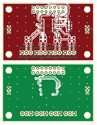

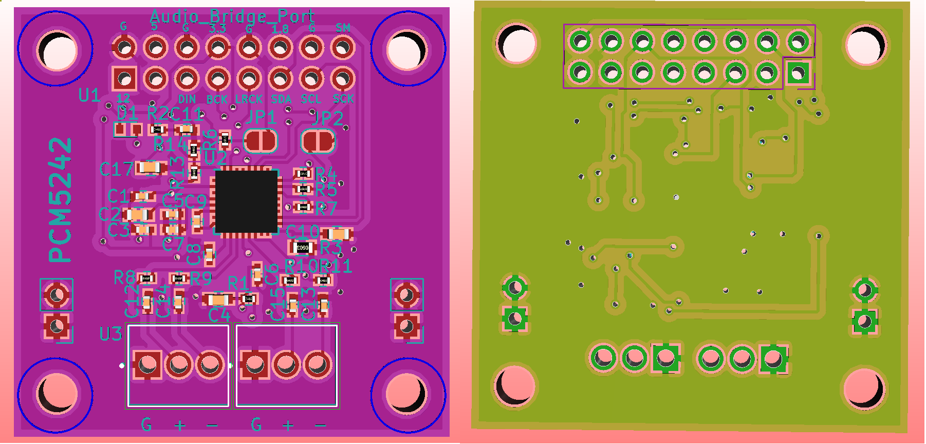

I have designed modules for the PCM1865 and the PCM5242 and they have the FreeDSP expansion headers. I realized after working through the design that I think it would be better to incorporate a power supply regulator into the modules and work off the 12v power supplied in the header. Originally I thought maybe working off a centralized power supply would be better. I'll post more about that in the future, maybe after adding some LDO. These modules could probably be contributed to the FreeDSP expansion module lineup. (after some rework)
My PCM5242 Version 1
attachment.php
My PCM1865 Version 1

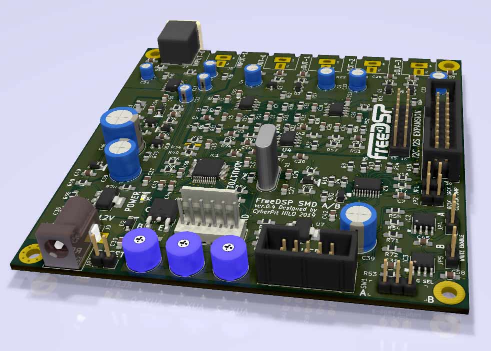

Now I'm Evaluating my CASSIC SMD A/B Design
Hi All, New to the free DSP project but it looks great. I have been playing with DIY hifi for years and am just having a dable with Speaker EQ and DSP. I have a pair of Linkwitz pluto and LXminis.
Is any one running the freeDSP CLASSIC SMD ? Does any one have any bare pcb`s available? If not i was thinking of getting a small batch of PCBS`s run if any one is interested?
Has it been run and tested any issues? any input greatly received.
Many thanks
Ben.

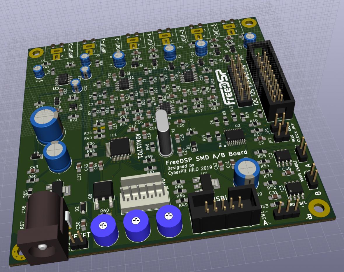

Hi Ben-San,
I just ordered my "CALASSIC SMD A/B" board, few weeks later my evaluation will complete (Hopefully may be...)
After that, I'd like to post my design for all the DIY'er(s)

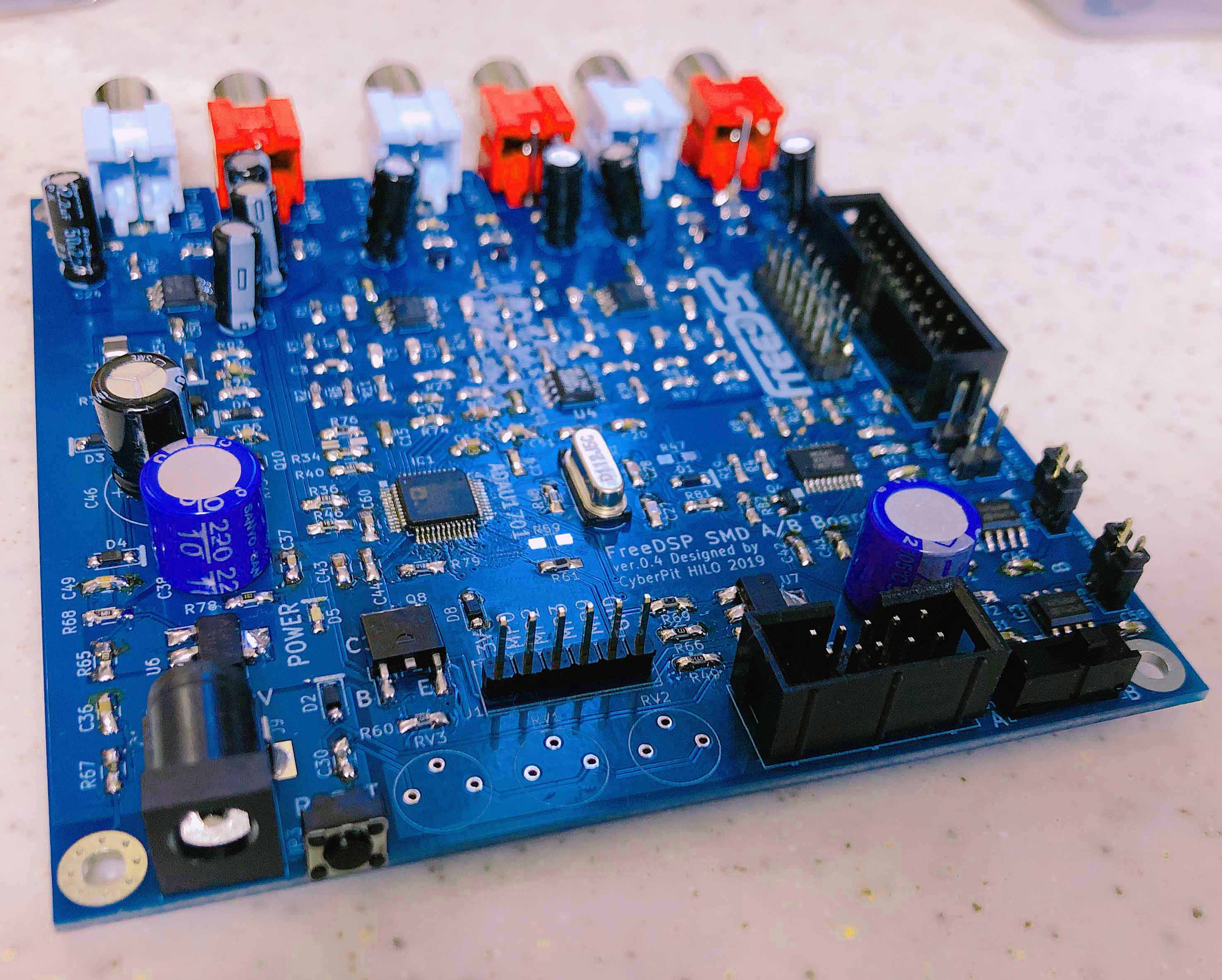

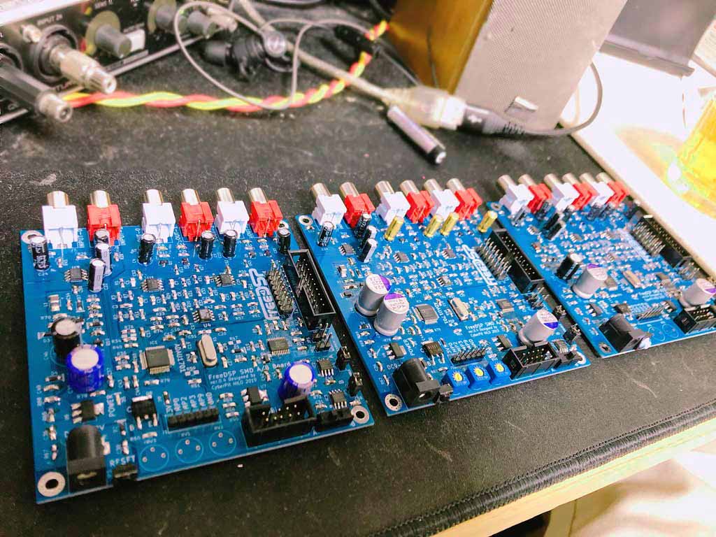

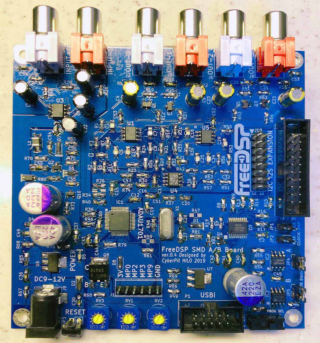

FreeUSB_SMD_AB Board ver. 0.4 in evaluation
Hi, A new version board had built.
Now it working as I expected features and performances.
Thanks for all previous FreeDSP project activities.
