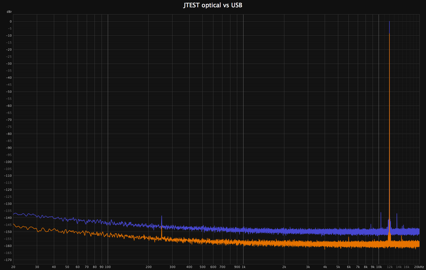

Happy to see even better THD+N results than on AK4458 EVM 😊. I still need to check what is causing increase on jitter, that is next on my list. I’ll post some pictures and test results once done.
Btw I’m using E1DA ADC (with REW) for testing, excellent device with low price!
Finally got the jitter problem solved (well there is still some, but I guess it is the nature of ADAU1452 PLL clock and I can live with it). It was caused by too low input voltage from the SMPS (I turned down the supply voltage to make everything run cooler, but went too far..) Here's comparison spectrum with standard 1kHz 0dB signal on same output. In some frequencies the differences were even bigger. This is with optical input.

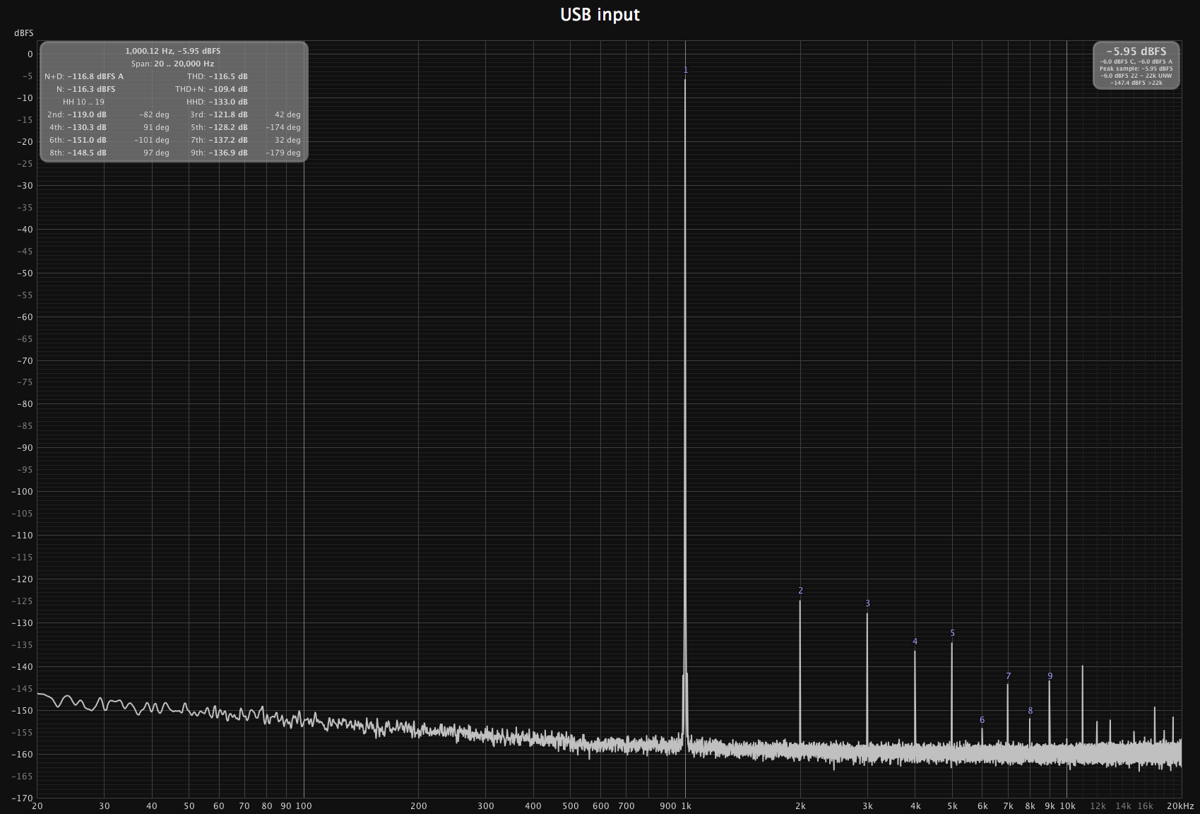

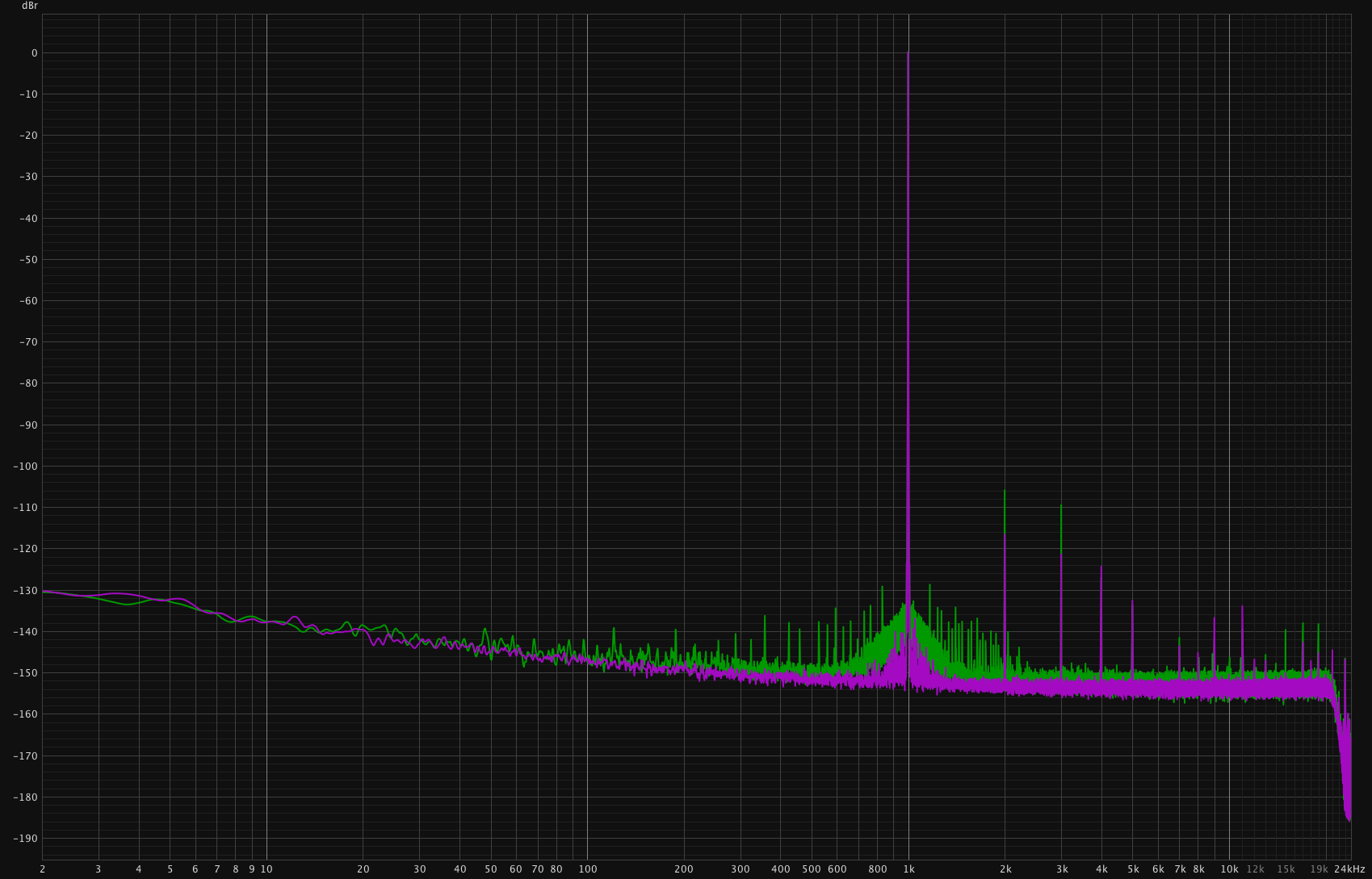

Standard aurora THD -104dB, THD+N -102.9dB (for comparison I would need to re-test the minidsp 4x10HD with the E1DA ADC, but I already know aurora beats it with some margin). Btw this is with OPA1612 which I tested to give best results.
new THD -115dB, THD+N -109dB (AKM spec -107dB)

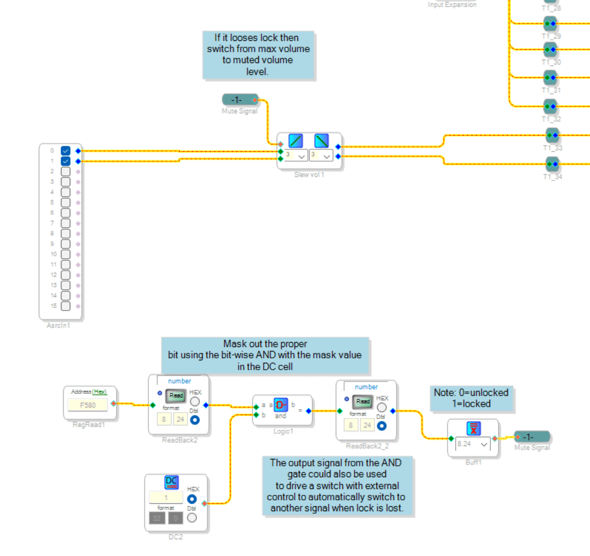

Anyone else stumbled across this: https://ez.analog.com/dsp/sigmadsp/f/q-a/121279/adau1462-loud-pop-click-when-audio-starts
I noticed when I boot the aurora dsp with SPDIF input selected by default and no signal on the SPDIF, the ADC will actually drive outputs to some random DC voltage level. Once I introduce some SPDIF signal it will go back to normal (=no DC at outputs), even if I disconnect the SPDIF signal. It sounds like the ASRC memory needs to be purged. There is DC block down the line, but it anyway causes extra clicks and pops. I'll try with the ADI proposed solution, but thought I ask has anyone else already solved this?

I can confirm that with the ADI proposed approach I got rid of the DC signal at the outputs when there is no signal on SPDIF on startup. It was actually quite easy, copy-paste from the proposed block diagram for the ASRC input.Anyone else stumbled across this: https://ez.analog.com/dsp/sigmadsp/f/q-a/121279/adau1462-loud-pop-click-when-audio-starts
