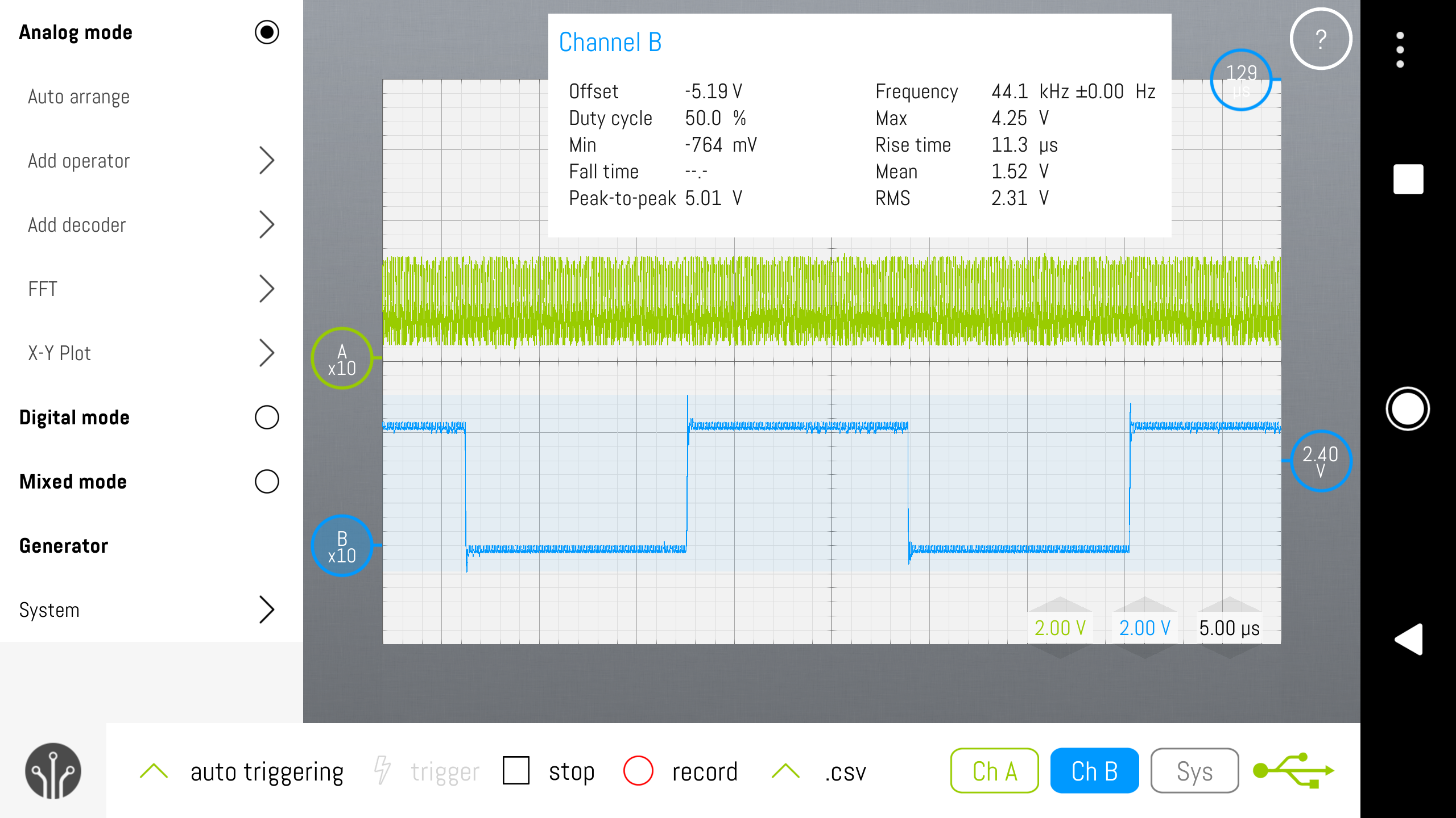

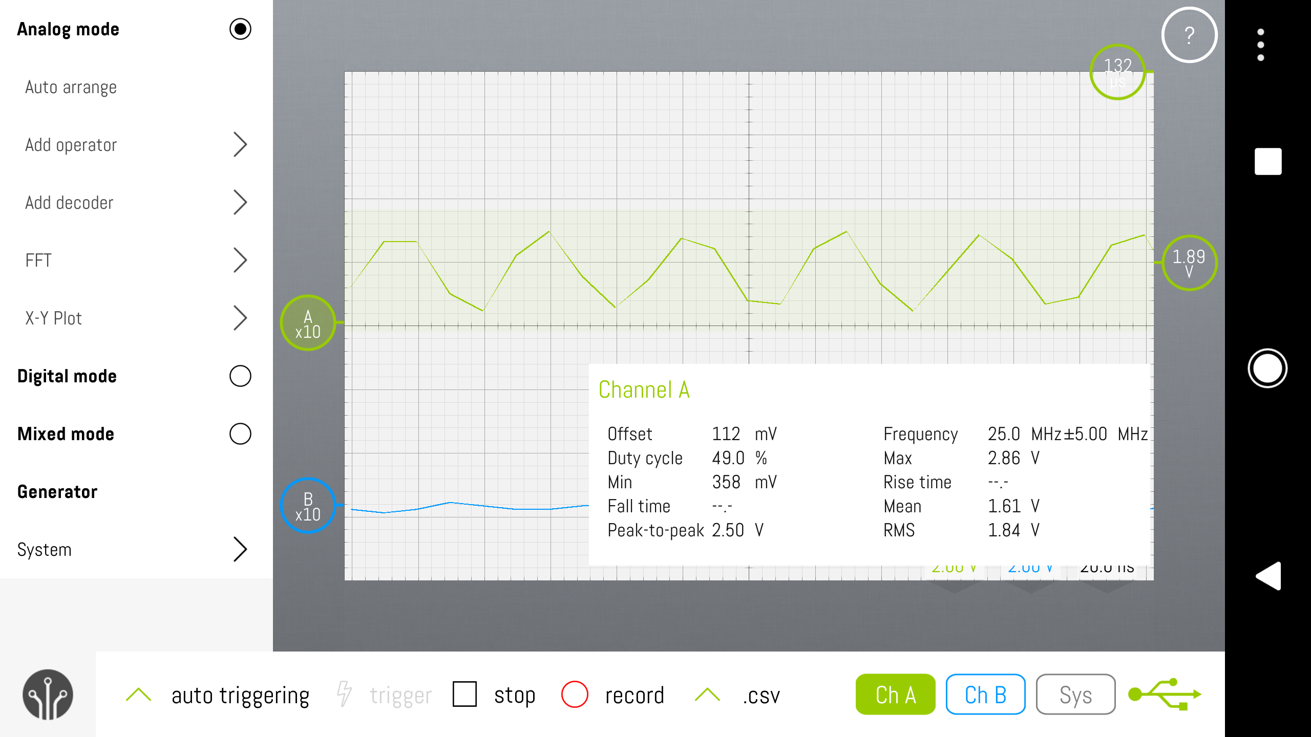

That said - I DID get it to clock from an external clock: when doing 192khz out on the modi2, BCLK is 12.288MHz. Score, I can just split that between BCLK and MCLK - and everything will be in sync.
Only one problem, I discovered that BCLK is outputting 3.3V (in fact all of the serial in ports are outputting 3.3V). I traced them back to the chip, and the PCB is correct so now I'm just confused.

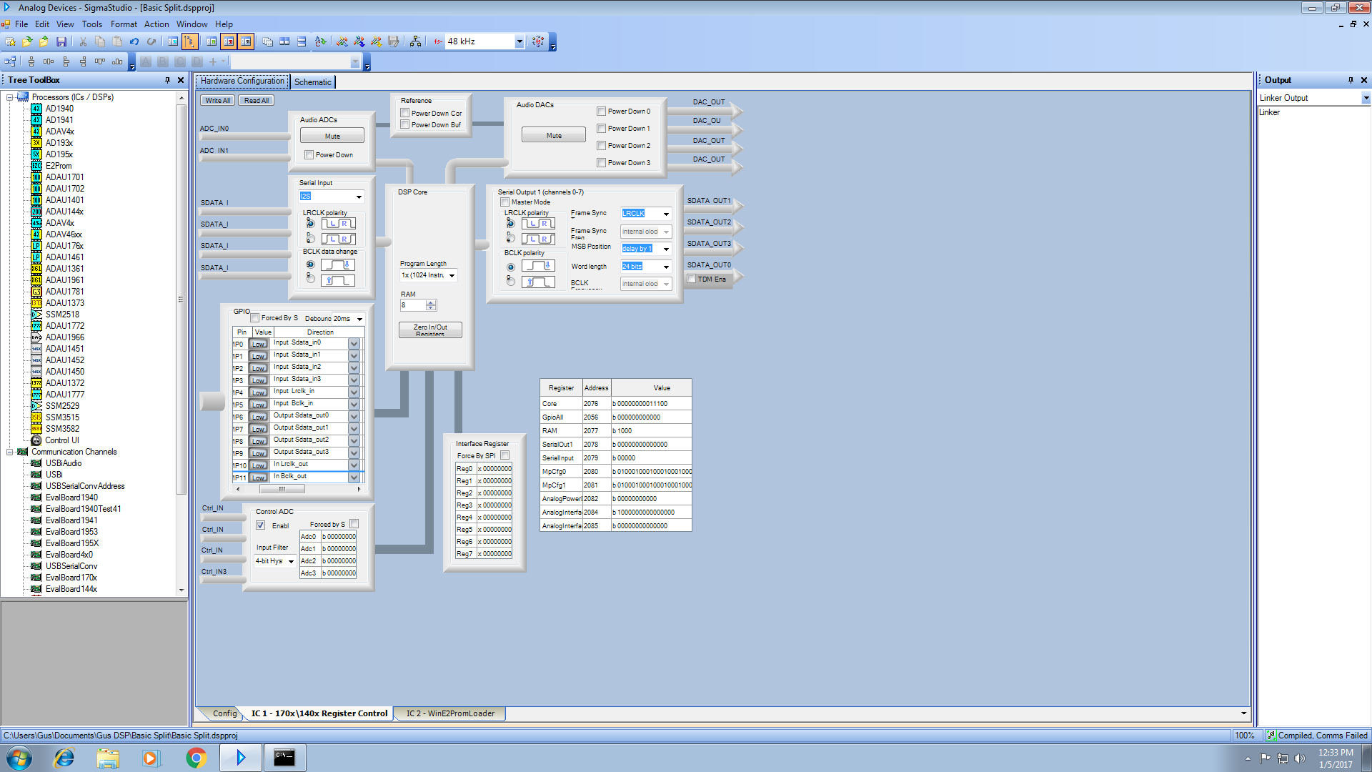

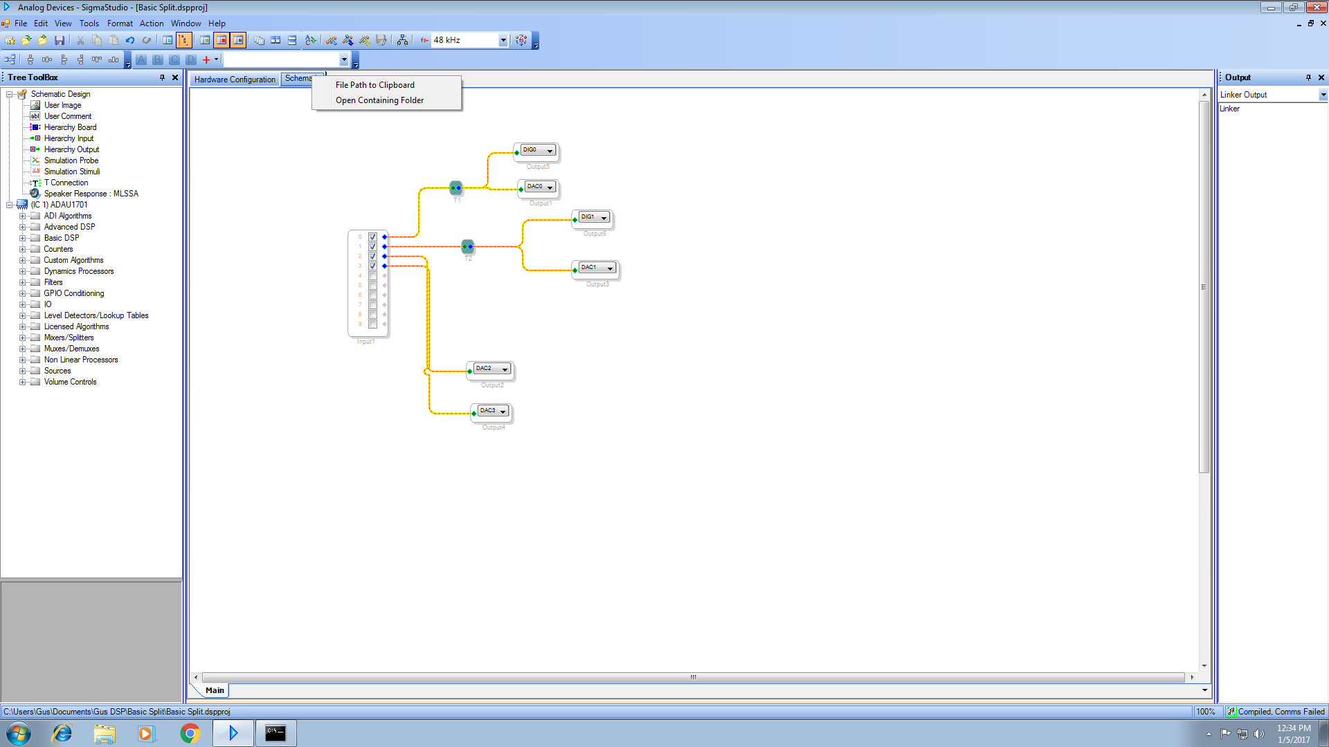

Other than control registers and the schematic is there anything else I need to do to get I2S input working?

I just don't get what I'm missing. It's like the I2S input pins are all being configured as GPIO out pins, being held high (they all show +3.3V on them). There just doesn't appear to be any reason why

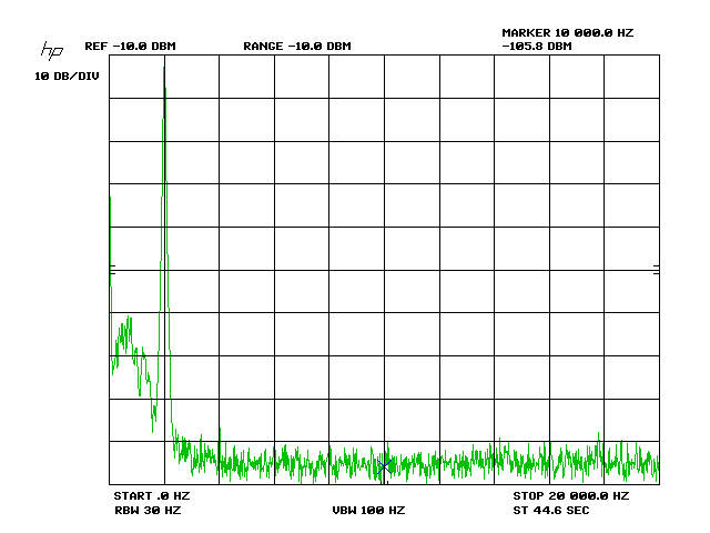

I tried syncing the adau1701 from an spdif generated Mclk. this clock is always worse than the xtal clock from the ADAU. so you will find the sideskirts of the spdif clock (pll noise bandwidth) back in the DAC output noisefloor on the LF side. better to use an SPDIF than can operate as I2S slave to the ADAU1701 as I2S master. the pic shows a pure 1khz sine generated by sigmadsp generator fed to the dac, and the LF noisefloor below 1Khz due to the rattling MCLK clock from the I2S receiver . I added an ASR to fix the problem and set the ADAU as master.

you only have to connect the LRCK of the DAC to the LRCK of the I2S input and the DAC BCK to the I2S in BCK . the input cannot generate the clocks, it needs it from the I2S output.
so in the ADAU register control tick the master mode in the serial output block and set the polarities and values correct. you may power down the adc's and dacs to save some current. I sometimes use the dac as a logic level output to control mute circuitry as most of the ports are already in use.
