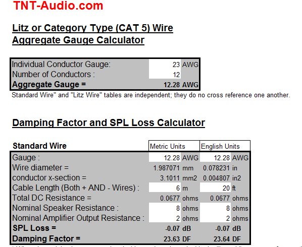

Well, CAT6 really isn't made for high currents. There's a reason why the official PoE specifications call for 48v and a design current draw of a few hundred milliamps.
Romex, of course, is designed for at least 15A depending on size.
Now try the CAT6 in a high frequency signal application, then try it with Romex. Don't be surprised if it does not work at all with Romex due to severe impedance mismatch.
Pick the right wire for the job.
Let's compare apples with apples ...
You are combining 4 strands of CAT6 per side. Let's say the gauge of the wire is 23 AWG, you have a combined gauge of 17 AWG.
If your romex is 12 AWG ... it's not a fair comparison. The next test woud be to combine 12 strands of CAT6 to get around 12.28 AWG.
Now listen again.
www.tnt-audio.com/clinica/wirecalculator.xls
