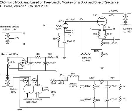

Free Lunch/Monkey/DRD inspired 2A3
So I made a prototype of the attached circuit. Must say it sounds pretty nice, but I get a hum (or is that a buzz?). It's a quiet hum. But if I listen real close (and backwards) it seems to sound like this "you don't know how to hook up a/c heaters." Weird, huh?
I’ve never heard a DHT before this and I don’t quite understand humbuckers, so any comments are very welcome.
I know a bit of the parts are over the top, but what can I be if not a wasteful American?
The 417A doesn’t fully drive the 2A3. Maybe a bit more out of the phono stage is in order. (Haven't listened to it with the CD yet.)
I’m going to try to figure out the hum, and then make a proper monoblock for stereo listening!

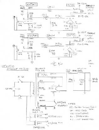

Add a hum pot to 2A3 filament
Hi Dan,
Surely it will hum. It is so strange that the schematic doesn't include a hum pot for killing hum at the 2A3's filament. A 50-ohm 2W potentiometer could be placed in parallel with the two 100R resistor. You may refer to the attached schematic.
By the way, the Hammond 266M2 may produce excessive voltage greater than 2.5Vrms for the 2A3 filament. Check the voltage!!! You may use a dropping resistor to reduce the voltage to 2.5V if necessary. My very simple calculation of the resistor would be:-
R = (Vout - 2.5V)/2.5
You would find a resistor that will give the voltage very close to 2.5Vrms across the filament.
Johnnny

I wired up a 50R humbucker from RS (173-164). With the dial in the centre, the same buzz/hum. When I turned the knob right, I started to hear a hum. Turn it back and to the left, I started to hear a hum.
With the knob in the centre - no hum, just a buzz.
So now I guess I know what hum is. So maybe it is not the AC.
If I put a 100k from input to earth, buzz is gone, but so is the music. Well most of it. If I put a 1M, no effect. (Just guessing now)
But with my power supply, I just don't see it being the B+
Maybe swap the input valve........
Dan

yagoolar,
Don't know if this is right, but it seemed to work for me.
I calculated the value of the cap for a 1hz cut off and for the total resistance that the cap sees. I (well, read out of morgan jones) took the total resistance as the value of the cathode resistors (50+390+4500) 4940ohms in parallel with the cathode resistance.
I understand the cathode resistance to be the ra of the valve summed with the anode resistor divided by amplification factor +1. But since I've got a transformer sitting on top of the valve, I figured that the impedance load was so big that it effectlively make the total resistance equal pretty much the value of the cathode resistor (I'm sure someone told me this, because I wouldn't have figured it out myself, and the cap value it gave me made sense).
so the cap value is:
1/(2 x pi x 1 x 4940) = 32uF
I konw I show 50uF on the circuit, but that will be changed to 33uF
I'm using a polyprop (solens) fo my cap
Good luck
Dan
