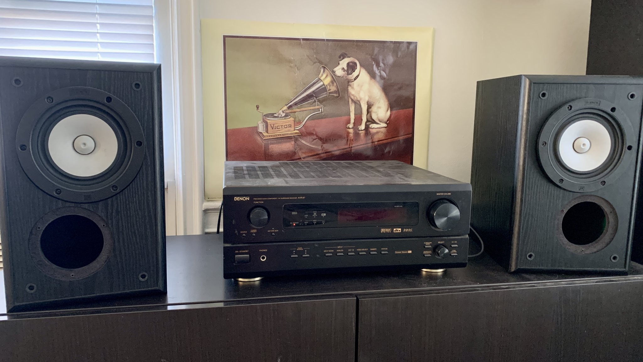

Frankstein full-range drivers speakers - what have I created? Why does it seem to work?
I got two Alpair 10p full-range drivers and plugged them into the woofer holes of old speaker boxes I took apart. I took the old tweeters out and left a big hole in the box. I also took out the bass port tubes and plugged up the back hole. So now the tweeter hole in the front is like a bass port? I thought these couldn't possibly sound good like this and put them in storage for a while. I just pulled them out and plugged them into an old Denon receiver and was pleasantly surprised by the sound. How is it possible this sounds half-decent?

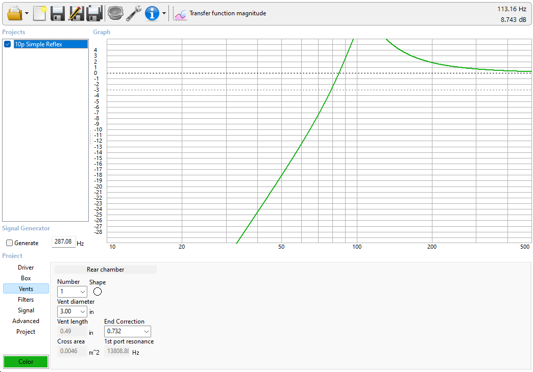

I guess you could take the measurements of the speaker box and plug it into an online calculator.
Then for a 'ported design' add in the radius/diameter of the port. (Tweeter hole)
It should then come up w a length of the tube for the port.
Because of the size of the hole, I'd expect the tube length to be short.
But I suspect 'half way decent is subjective. ;-)

In many speakers, successful crossovers need to account for acoustic slopes (and other things) affected by the enclosure and driver parameters. But in a full-range design, obviously crossovers don't exist - so it is easier to sound half decent through the more critical ranges (even if still sub-optimal). Most of the potential issues with a full-range enclosure mismatch will likely be in the lower frequencies.
The other factor is that 'half-decent' sound isn't especially difficult anyway, if one is lucky enough for the driver and enclosure to be a vaguely suitable pairing. It generally just requires nothing too awful to happen. Turning that into 'fully decent' is mostly what a lot of the time, effort and expertise is spent on.

Let’s figure the volume out a little closer.
But given Jeff’s guess, a 2” plumbing pipe, 4.6” long. But it could be better if you decrease the box volume. Toss some “bricks" inside.
If you sealed it close to as big as practical for sealed, starts rolling off early, but drops slowly. F3 at about 100 Hz, F10 in the low 40s.
About 17 litres is optimum.
dave
Reactions: 1 user
dave
It’s easier to use a 3” diameter tube because that’s the size of the hole.
