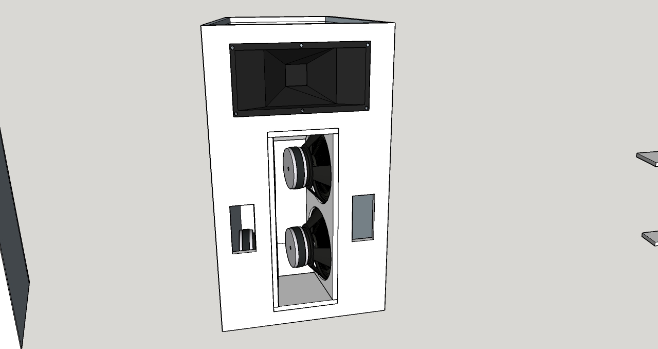

Ok final design is ready, building next week. Very exciting.
So, I am rebuilding these cabs with original Xovers and dimensions, but PPSL. This is what I have come up with. The tweeter looks like a single horn just because thats all i could find to download, but its the right proportion so it gives you the idea.
On reinspection the cabinets did have a vent, no duct. I didnt notice until quite late in the designing, but I am copying the originals so far so I just cut it in half and put half on each side to keep it symmetrical, but I wonder whether this might cause issues, as each half vent is paired to an opposingly phased set of drivers. Might make strange things happen? The vents could be good for un-mounting if needs be...
Also I was wondering whether to keep one phase on each side, or alternate so they are diagonally out of phase as well, I guess I can experiment.
Anyway, input from anyone appreciated before I go ahead next week :)

Very nice work!
One problem though: The high frequency section is supposed to be upright, not on its side as you have designed it in the new enclosure. Have a closer look at the original csx cabinet. I highly recommend you change your design in this regard.
The vent position shouldnt matter, but another option could be on both sides of the hf horn?
Otherwise it looks very good.
You still seem to struggle with the inverted polarity (not phase!!!) concept. Its fairly simple. A loudspeaker moves back and forth. The inverted speakers in the ppsl design have to be wired with inverted polarity, so that they push when the non-inverted ones push, and likewise pull together. Nothing is" out of phase " (n.b. "reverse polarity" is correct). It shouldnt really matter how you mount them, as long as the horizontal pairs are complementary with one inverted, one normal.

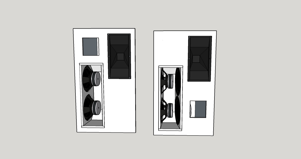

a very quick revision - both pretty much the same:
Ok I will try and adjust the HF section upright, its a bit awkward but there will be a way.
why is it that they need to be upright, out of interest? :
This specific high frequency unit was designed this way. Most hf horns are designed with a "landscape" aspect ratio, but this one is an exception.
Your revised version might work, but from the perspective of acoustic summing it would be optimal if you manage to vertically align them.
Try to optimize for vertical space. For example in your current design the plenum is designed as a self-contained box that is vertically a bit offset from the bottom. You could redesign it so that the bottom of the plenum is formed by the actual bottom board. Make the hf section exactly flush with the upper edge of the plenum. The box will become slender and tall, but it will also be more suitable for groundstacking. Making it again trapezoidal, and maybe a bit deeper could help keep the size and shape manageable.

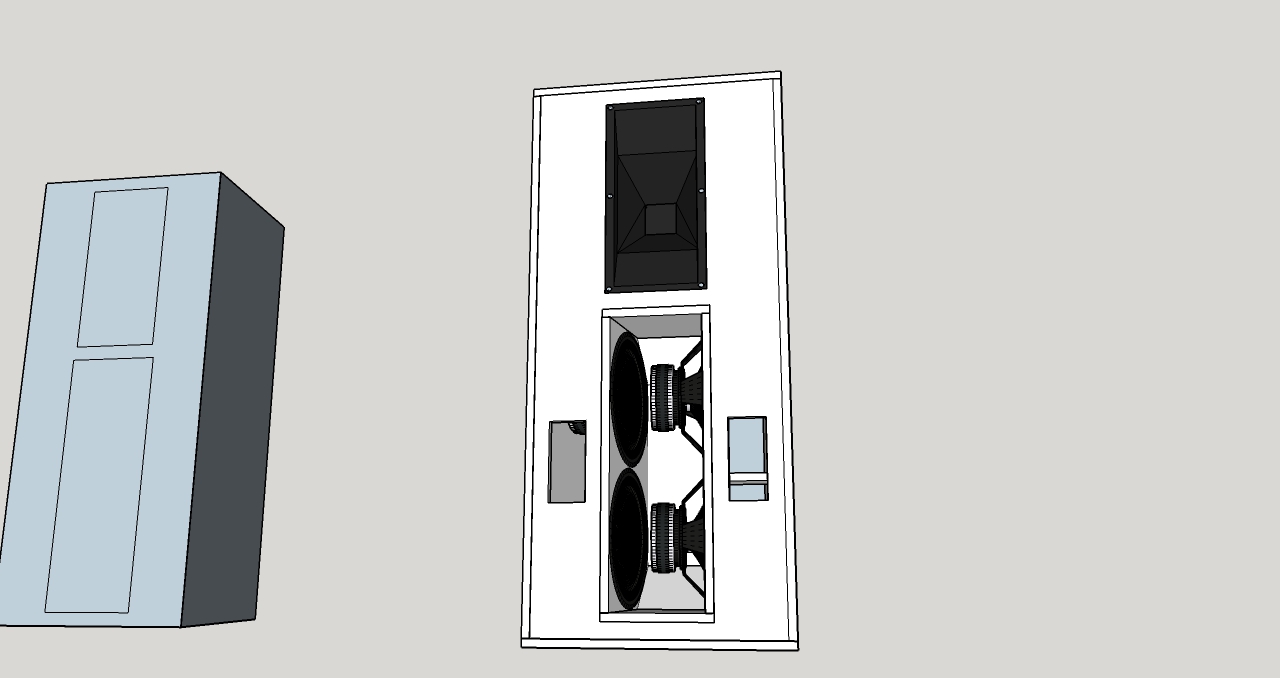

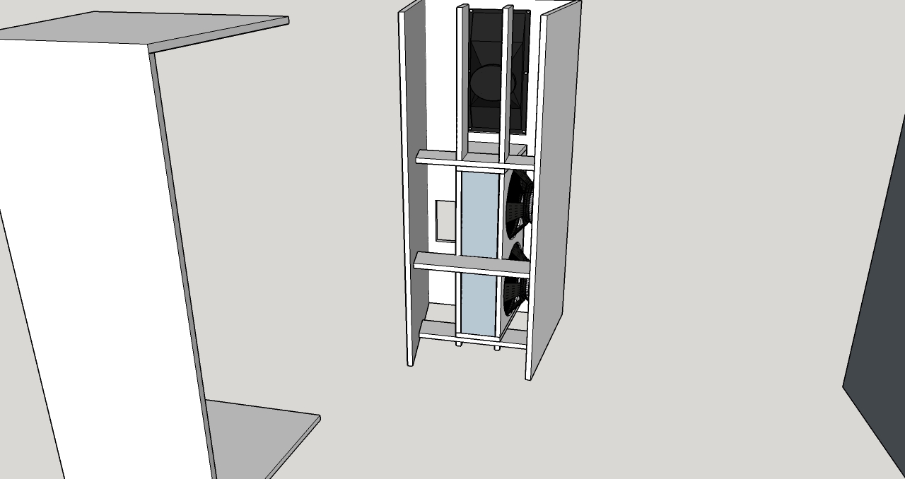

here is version 2.0 - a bit taller, same bracing as original, 'dual vent'...

Still very glad to help, and Wow, excellent work!!!
