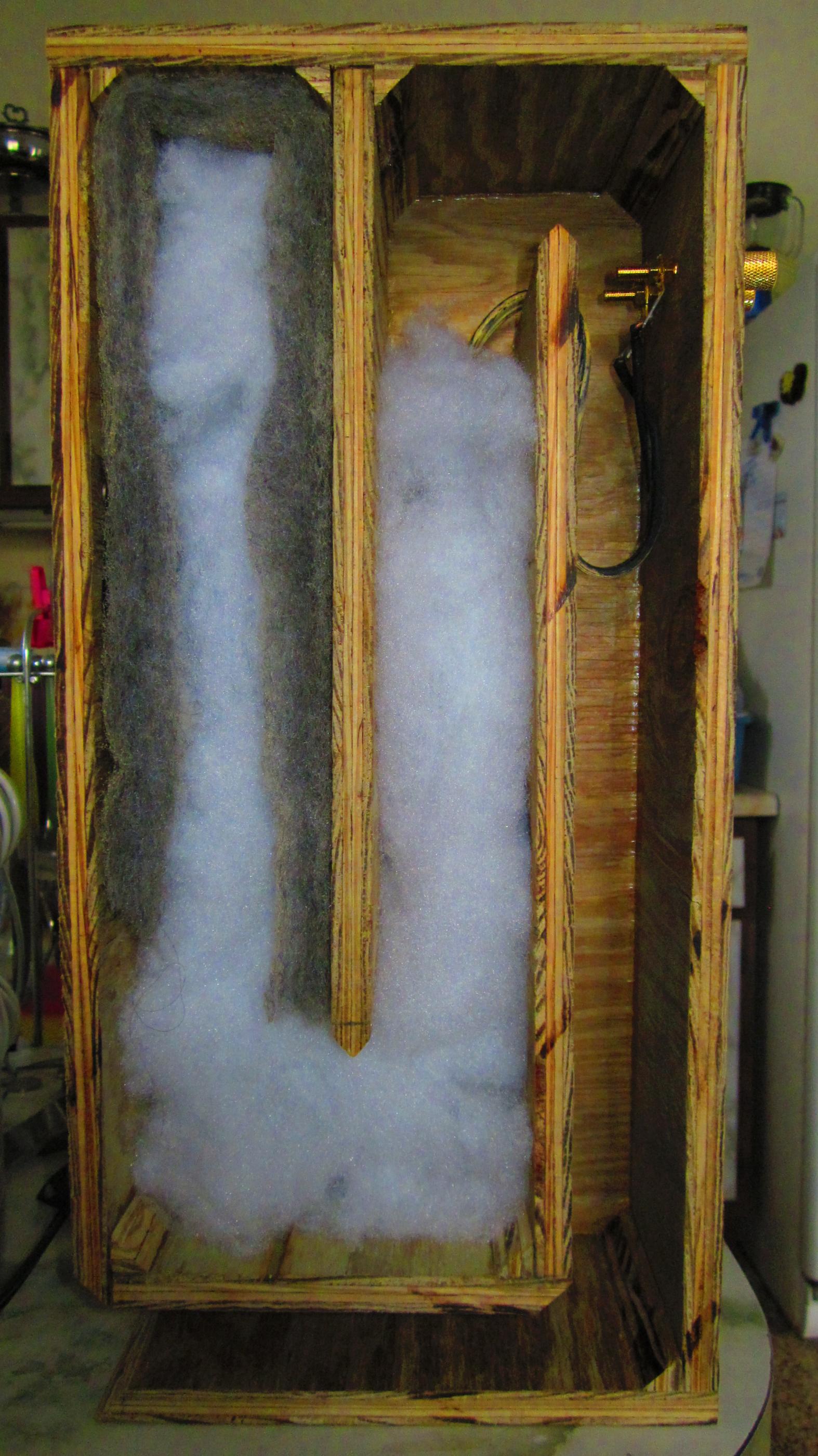

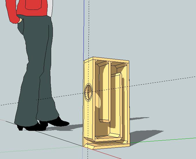

I'll be moving to Puerto Rico in a couple of days, so when the smoke clears I'll start the build project and document the whole thing. Hopefully I can post it all soon. I'll be using 1/2" MDF, 2xAurasound NS3-193-4A 3" Extended Range * 4 ohm * Silver Cone, and a set of gold plated binding posts. (Nothing fancy)

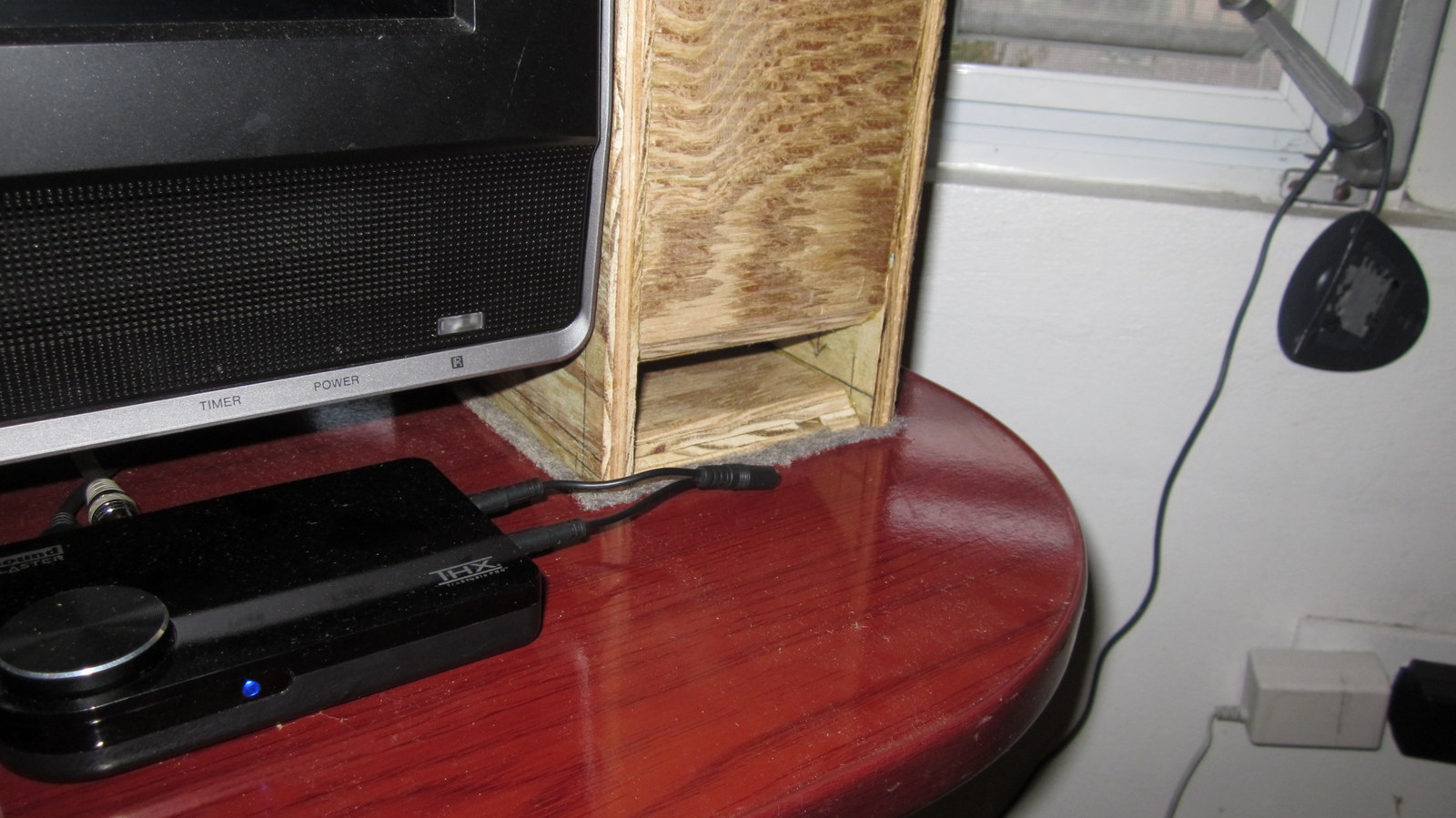

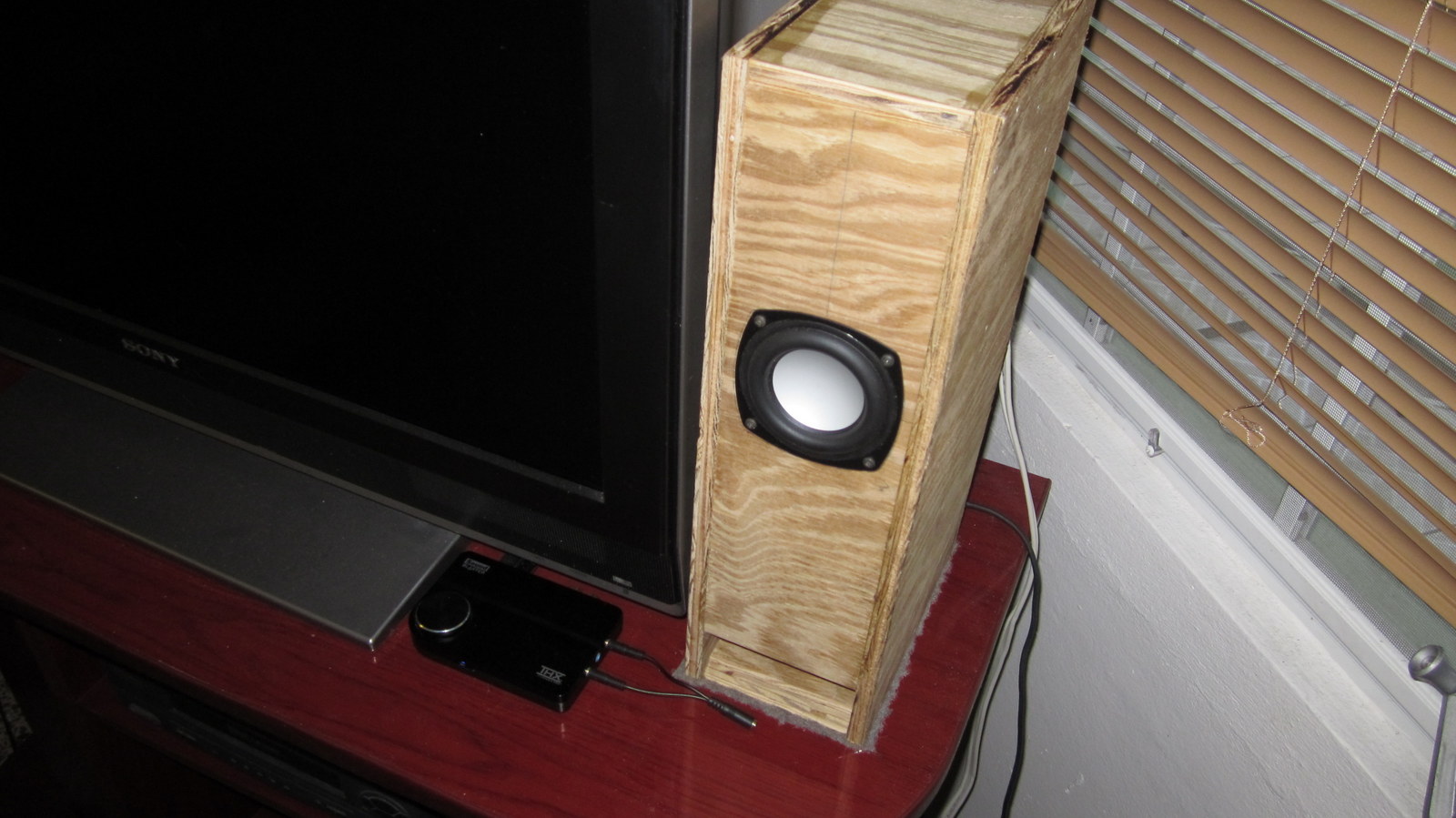

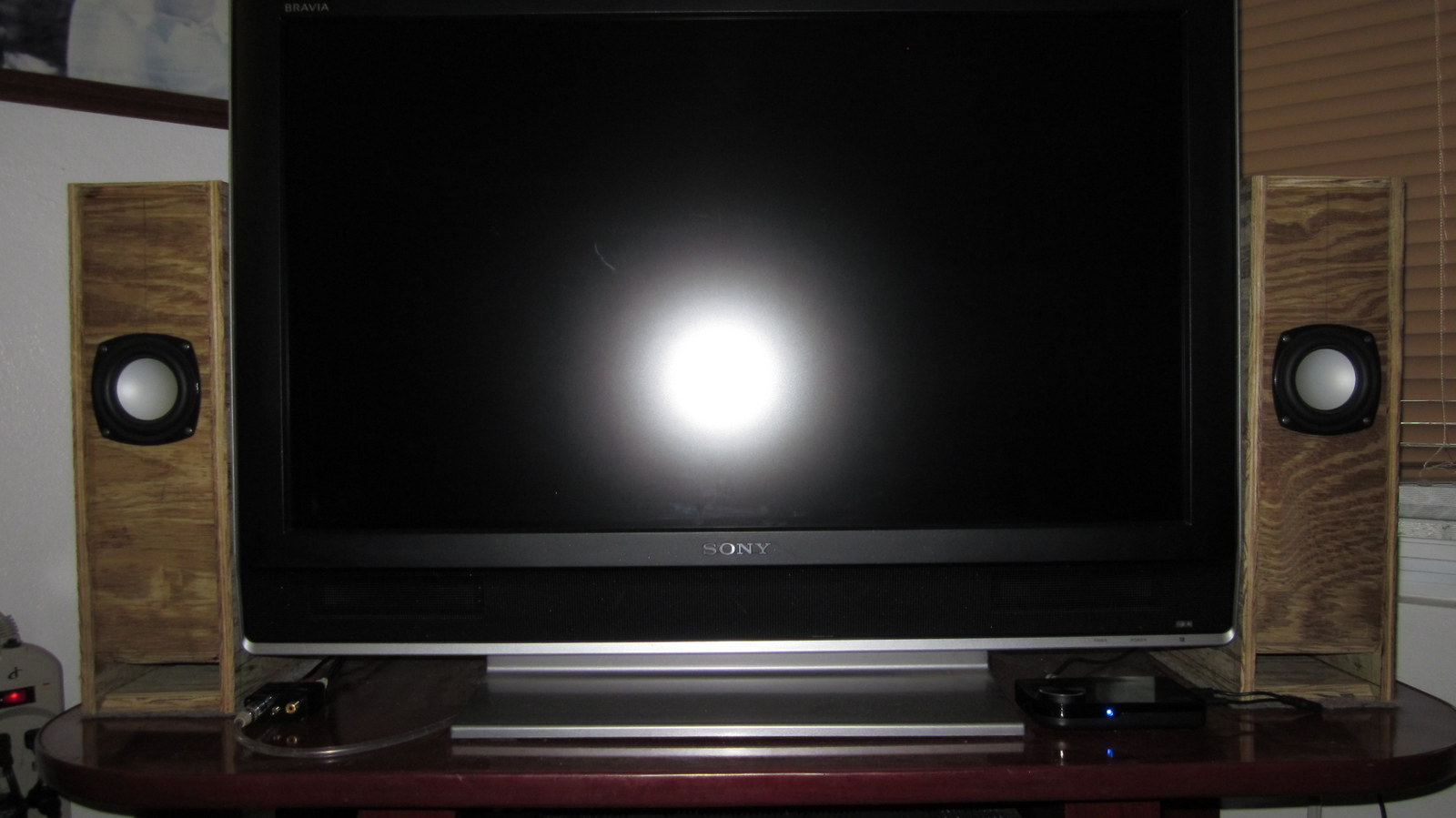

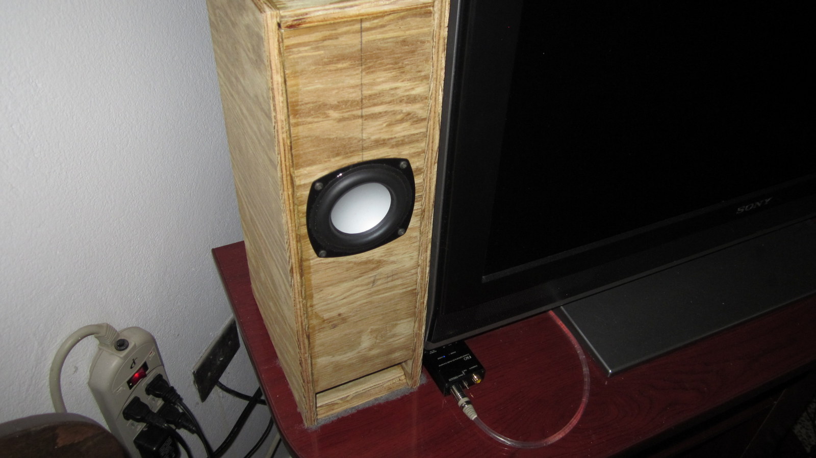

Finally got my prototype boxes built. I wanted to perfect the methods of it's assembly and tweek it's construction. When I got to Puerto Rico, I found out (quickly) that quality wood products are hard to come by. So...I bought some half inch ply(really garbage quality) and began my build. LOTS OF CLAMPING! The wood was warped badly, so I had to compensate for that. Well, they're done. I'm very happy with the sound. Incredible. Even with plenty of "BOO BOOs....I managed to get them to sound great. I'll post picks when I can but, I think I am very satisfied with these little gems! Ugly as sin right now but, I think i can fix that. For now....music plays through them without me feeling fatigued. Warm, I would say. Looking forward to getting back to the states so I can re-do them, more precisely and with better better quality wood. This build has taught me a lot. Now to put that experience to practice!

It looks like a good desktop solution for a 3 inch. I wonder about that fatigue thing though. While it might seem like a good idea to have the driver at ear height, a design by Zaph that I made for the Tangband years ago similar to this was, how to say, too close for comfort.
I had some small stands and did a lot of repositioning to get a bit of soundstage.

At the moment I'm only playing around with this build, testing out where I like them to sit. When I get back to Wisconsin, I'll be building a new set out of spruce or ash. I want to be much more accurate with my woodwork. I have thought of building a set of matching stands but , I need to know what my "Home" environment will be first. I have looked at Zaph's designs and chose to try a T-line first. Maybe after the fallout of this build clears, I'll attempt to do a sealed enclosure for the same drivers. I really can listen to these(as they are) all day long without my ears regretting it.
Hard to say how wood of any sort is acoustically better if filled with denim batting on the inside. Ancient wisdom from the forum here is that the reversing directions of Baltic Birch ply or any ply is sound neutral. I think GM told me that but he will correct me as needed. Ash or other quartersawn facing over one of the inert woods is a technique done by B. Brines and others. It depends on what sort of access to tools or professional help is down there in Racine.
