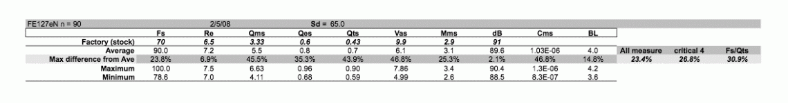

Dave - your data shows quite a spread, suggests that box designs should be tolerant to this kind of thing.
Exactly. Particularily because -- if my current views on T/S hold -- "parameters" will change depending on where the volume is set, and with the dynamics of the music.
Interestingly, the box they came in includes a printed statement that this is a matched pair, which I wonder out loud as it doesn't seem very economical for the manufacturer to do this unless the matching is simply within their 'factory spec' for all drivers.
They'd have to have a pretty streamlined process (cheap labour helps). And a simple matching algorithm that assumes more drivers coming off the line all the time, I wonder how tight they are?
Mine didn´t include such statement. However, Qts differed by 0.01 and Fres by 1 Hz only... Amazing:)

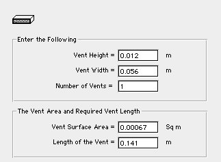

First off, they don't want a slot port on the front, for no other reason than how it looks. I'm now thinking if I can move it so that it vents underneath, lifting the box off the desk surface with some spiked feet. Is there a guideline for the height off the desk surface - I was thinking of at least equal to the diameter (narrow part of the slot) ?
Slot out the bottom (at the back) works. I have one of the classic GR Mar-Ken7 variations drawn this way. you can play with loading height... i'd lift it higher than one vent height (maybe tipped back somewhat too)
