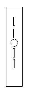

You can see my horrible drawing of the speaker in the attached image. (Yay, msPaint!)
I was hoping to build a "bigger is better" horn-loaded speaker, but instead of using a full-range driver, I'd just use a mid-woofer instead, like one of the Silver Flute drivers. This would produce the necessary mid-bass for these panels. A ribbon tweeter (ApexJr $5 model) would be used as a "helper tweeter".

The curves for the "bigger is better" horn-loaded speaker look rather rough (vary 15 dB).
It would be better to have at least two spaced woofers (>1 on ea. end) or better yet a line source of woofers to come close to matching the directivity of the ribbon/planar line source.
It is not a good idea to break the HF driver line, as that will create an uneven polar response.

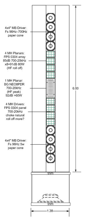

I have attached a jpg file including the basics of a similar tower-shaped speaker concept I am working on; it includes a BG NEO8PDR to add some MF & lots of HF (higher SPL than the FPSs) but the BG does have a HF peak on axis (& several small woofers for mid-bass).
If higher SPL is not needed, I would just insert a nice little ribbon/planar tweeter (like the Foster) in the middle of the four FPS ribbon/planar line source.

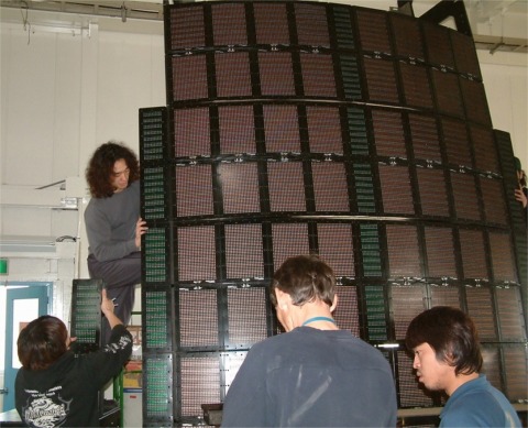

The attached pic. is of several of the FPS1030 and FPS2030 planar drivers in a large concert application (subs not shown). The larger FPS2030 planar drivers have a Fs of 90Hz and handle 125W long term.

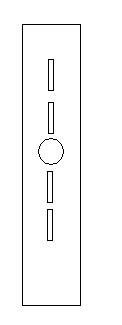

Baffle them basicly like the drawing in my Post #4 above.
