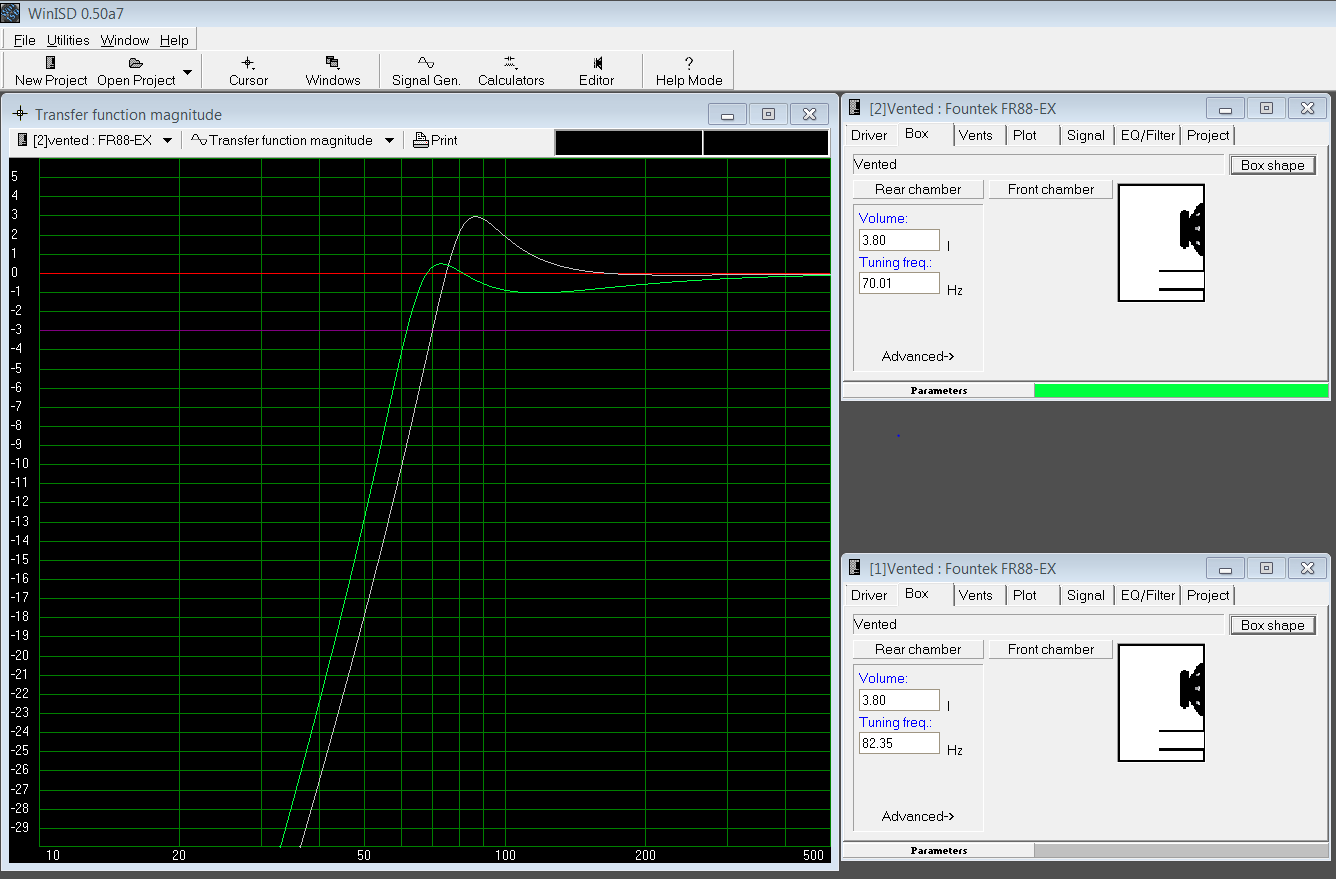

The manufacturer recommended a 3L BR tuned at 70Hz, and f3 is 70Hz. I haven't tried that, but it looks great on the sim.
This might go well with my sub, and WinISD also confirmed this is almost the optimum for a BR enclosure. The satellites will be placed close to the wall, so should I modify the design somehow to compensate for that?

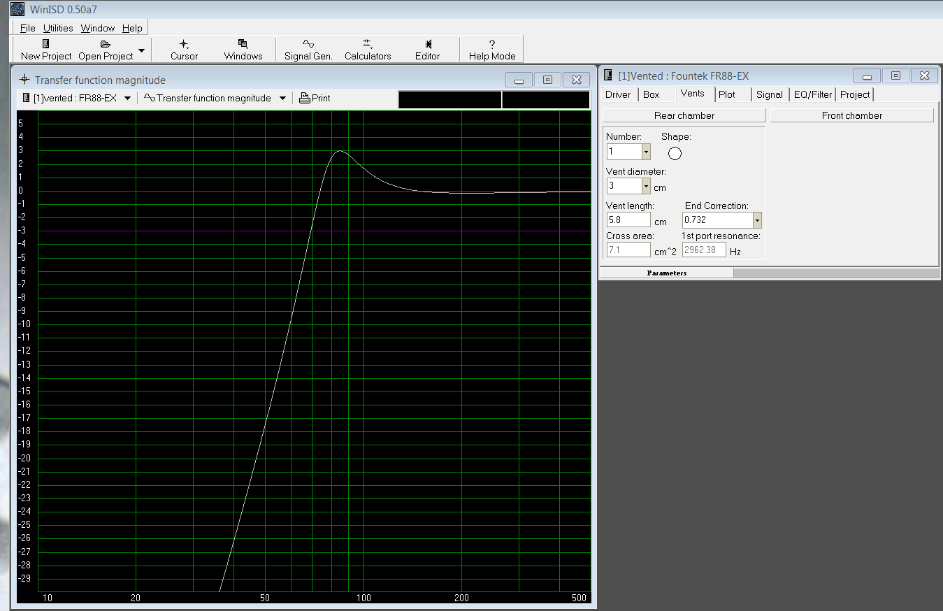

Did another quick sim on WinISD. Revised cabinet volume down a bit to allow for stuffing and port etc. (assumed 3.8L). Changing port resonance to 70Hz gave the following plot (green).
Rolled up some A4 paper to extend the port length to 9cm (to make port close to 70Hz). Lost some of that 100Hz weight but better top to bottom. Tracks the bassline in Burial's 'Etched Headplate' more evenly, but with less bass warmth.

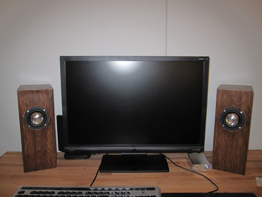

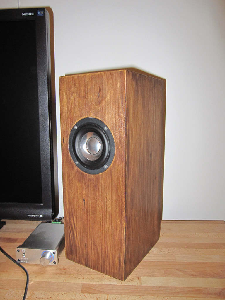

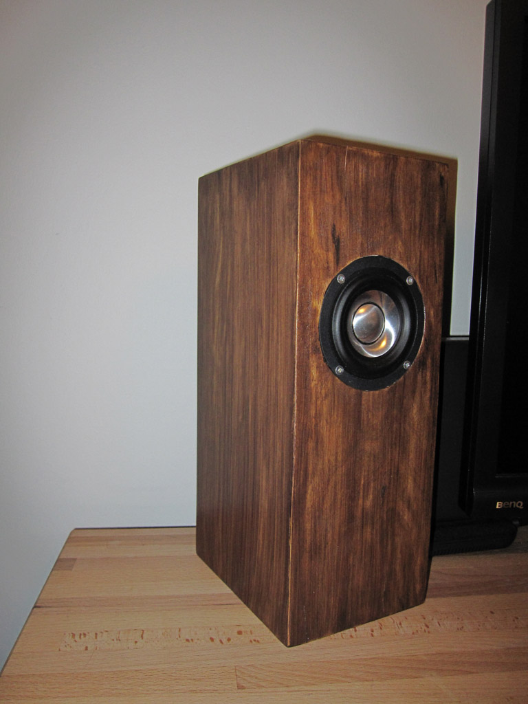

Hmm, update. The speakers are finished now, I used the 3l BR tuned at 70 Hz, and they sound awesome. Very detailed and accurate sound when run on a Tripath Ta2020 amp! I've used these to listen to anything from heavy metal to jazz, and they're so far the best satellite speakers I've made. Now I just have to connect the sub, and it's all done (lazyness).
Here's a few pics of them on my desktop!
