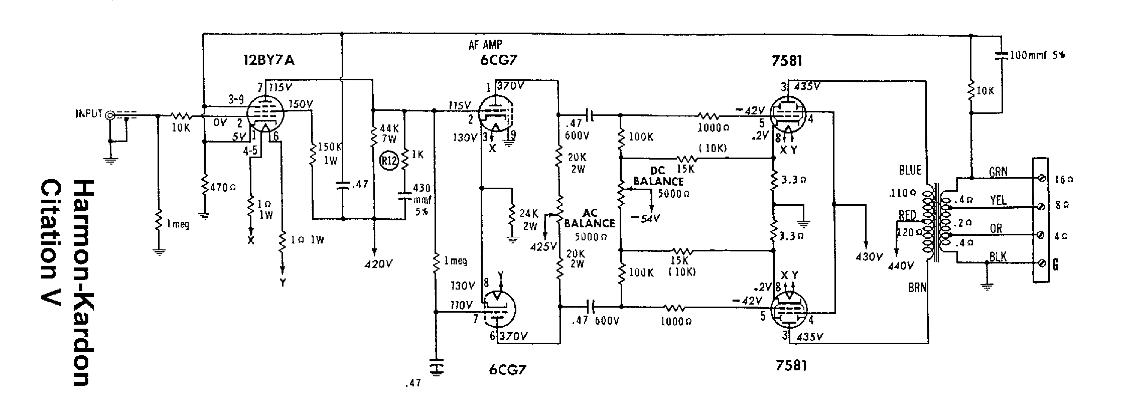

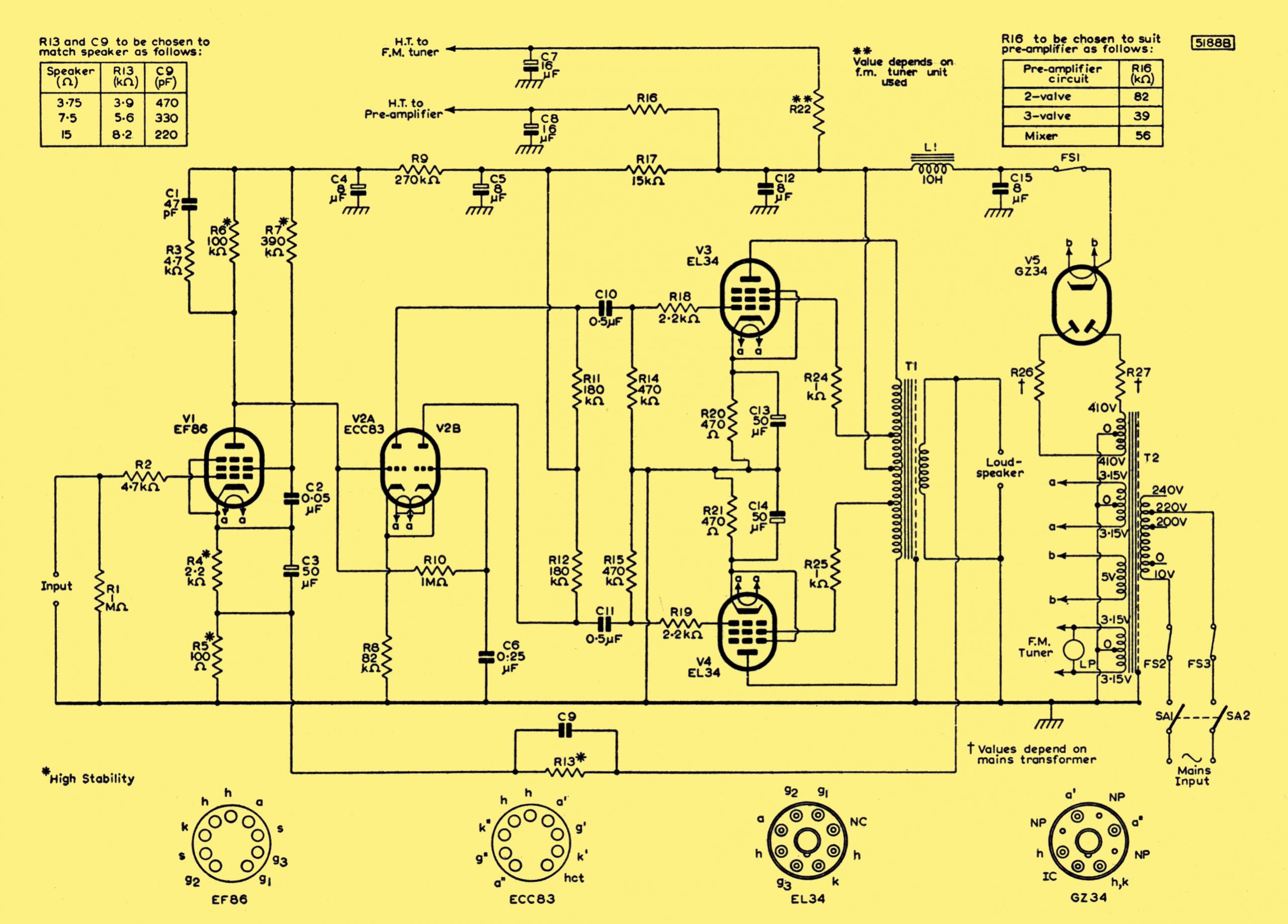

The 12AU7 is not linear. So, steer clear. The "classic" tube for Williamson style small signal circuitry is the 6SN7. You can save some real estate by using the electrically equivalent 6FQ7/6CG7.
Williamson style topology requires premium O/P transformers and careful adjustment of the high pass filter 1/2 power points. Failure to observe the appropriate precautions ends in low frequency instability.
When working with O/P "iron" that's less than stellar, Mullard 5-20 style small signal topology is (IMO) a better choice. Dodging the low freq. instability bullet is much easier, when Mullard style small signal topology is used. One of the finest implementations of Mulllard style circuitry is the Harman/Kardon Citation V.

Isn't that a long tailed pair?
The hallmarks of Mullard style circuitry are a voltage gain block DC coupled to a differential phase splitter (LTP).
Careful examination will reveal the same number of high pass poles as found in Williamson style circuitry. However, it's very easy to get the pole associated with the non-inverting grid to have a F3 quite close to zero Hz. That avoids the low freq. instability problem. Slipshod work on a Williamson setup yields a phase shift oscillator. It's much harder to make that mistake, when a Mullard setup is employed. A key factor that must be taken into account is the phase shift introduced by the O/P transformer.
When people refer to the "mullard setup" are they always referring to a ltp or is their something specific about the mullard?
Does the problem of opt induced phase shift increase as nfb is increased?

The 12BY7 is actually a high gain device. The parameter to look at in pentodes is transconductance (gm). When "constant" current arrangements, like pentodes and cascodes, are in use, a Norton equivalent circuit, as opposed to the Thevenin equivalent circuit used with triodes, is convenient. Stage gain is approximately gm X net load impedance.
The voltage amplifier at the I/P of both the Mullard and Williamson setups introduces a 180o phase shift. When the phase shifts of RC poles and the O/P trafo add up to 180o too, the feedback is positive, not negative. Barkhausen's criterion is satisfied and oscillation begins. :(

The 2 Mullard circuit examples I uploaded are very serious HIFI designs.
Dig around in the archives. You'll find all sorts of info. debunking myths about split load, AKA "cathodyne", AKA "concertina", phase splitters. In a nutshell, a properly set up "concertina" splitter is nearly perfect. The legitimate complaint about the "concertina" is poor voltage swing capability. Williamson dealt with that issue by incorporating a differential gain block between the splitter and the "finals".

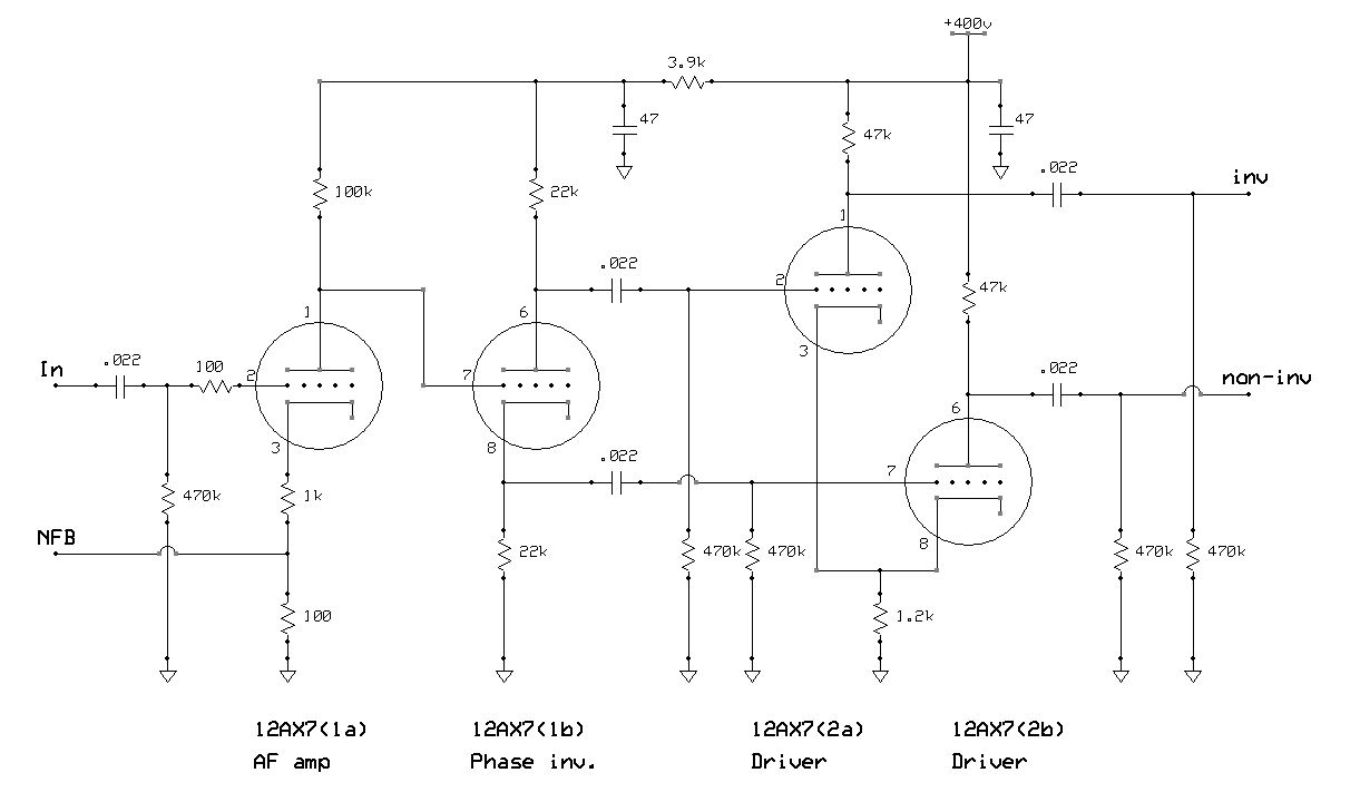

I'm fiddling with Williamson's design. I like the idea of making a universal driver PCB since the topology itself is fairly simple. I'm sure there's more to do but this is my starting point.

The 12AX7 is an absolute no/no!! It provides EXCESSIVE gain and wretched drive capability. Williamson knew what he was doing in selecting the highly linear 6SN7. Stick to that type or its very close relatives. Among its many good points, the 6SN7 contains reasonably high gm triodes. High gm protects against HF error correction signal induced slew limiting, in designs that incorporate loop NFB.
The 12AU7 is NOT a Noval equivalent of the 6SN7. The Noval type you want is the 6FQ7/6CG7.
People use the 12AU7 because it draws 300 mA. of heater current, while the 6FQ7, like the 6SN7, draws 600 mA. of heater current. The 12AU7 has linearity problems and (IMO) should be restricted to cathode follower and "concertina" phase splitter service, in serious HIFI designs. Local current NFB, inside the tube, disposes of the linearity concerns, in those specific situations.
Mosquito, are you still buzzing around the thread? Would it be a bother to emulate the schematic above and see how it performs?

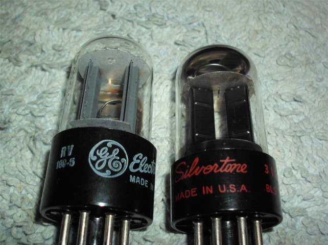

I found some 6SN7s but they don't match. They look completely different. One is a GE and the other a Silvertone. I found some 6SN7s coke bottles that look pretty cool. http://www.sophiaelectric.com/pages/se/6sn7.htm
Eli, I read a very good article about the Williamson amp that helped me understand a few things that had me stumped. The writer suggested using 12AU7s as the drivers (plate followers) because the 6SN7 has much high capacitance. In his revision, he paralleled the 12AU7's triodes. His complete preamp/PI/driver stage consisted of a 6SN7 as preamp/cathodyne and 2 12AU7s (with their triodes paralleled) as drivers. I'll try and find the article again.
Opinions?
EDIT - Here's the article. There are a few errors in the schematics.
If he uses 12AU7s as voltage amplifiers, which is what the drivers in a Williamson setup are, I am inclined to view his work with GREAT suspicion. The fundamental non-linearity of the 12AU7 will not go away. If somebody is worried about driver tube plate resistance and O/P tube Miller capacitance interacting adversely, the ECC99 is (IMO) the tube to use in place of the 6SN7. Notice the low RP, high gm, and μ of 22. :D The plate curves look pretty good too. The ECC99 is, indeed, a superior driver and you need only 1 bottle per channel.
The ECC99 is NOT the same as the 12BH7. Check the data sheets out.
There's no good reason to switch from the 6SN7/6FQ7/7N7 group as the preamp/splitter, in a Williamson setup. The triode in those bottles is as linear as they come and stress levels are low. Also, you can't ignore the 800 mA. heater draw of an ECC99.
