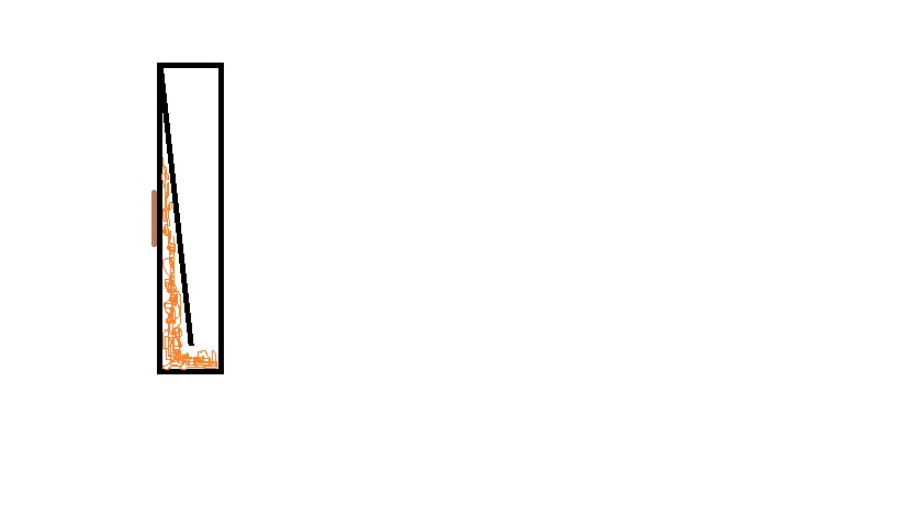

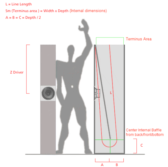

I want to put Fostex Fe 206e drivers into a good cabinet. I am 90% converted to BIB, half wavelength, However after two weeks of searching, with many frutrated attempts to reach the BIB Calculator, all I have are a few contardictory dimensions.
I need a simple ENGINEERING solution, i.e.
1) Dimentioned drawing, or the few critical dimensions
2) Any details of stuffing required, if any
3) Any details of method to effect the v joint between the baffle and front panel
4) Where are the connecting wires brought out - through the baffle ??
I'm fine with woodwork and would be happy to tackle acoustic theory, but really just want to get on and listen to my music,
Cheers Bob Wade
Robert,
1. Not sure if Zilla's site is up yet, but you can download the BiB calculator from the following link, post #39:
http://www.diyaudio.com/forums/full-range/190224-enclosures-hemptone-fr8-4.html
Also attaching a pic showing the basic BiB layout - this was either in one of the BiB calculators and/or at Godzilla's site.
2. Attaching a pic showing the basic stuffing scheme.
3. The "slant" is attached to the two side panels and is flush with the front baffle. I would suggest:
a) Cut the slant pieces an inch longer than required
b) when building, start with a side panel first - lay it on a flat surface and do all the necessary markings for the slant on the inside of side panel. Then glue on the slant.
c) Glue on the bottom and back panel too.
d) After the glue has dried, glue on the other side panel- assume you have clamps and/or some weights to put pressure - this is a BIG panel.
e) Since the slant is longer than necessary, some part of it will be sticking out of the top. Once both sides are glued on, you can saw off extra bit
f) Line adjacent areas behind driver with 1/2" thick felt, put in necessary stuffing
g) Attach front panel. I prefer keeping a part of the front panel removable for adjusting stuffing
4. Connecting wires - I like to drop them to the bottom and take them out through the rear. Some folks prefer making a small hole in the slant to get the wires to the back - the hole can be filled up with glue/epoxy. Both are fine.
For BiBs to work optimally they need to placed near corners - would you be able to do that?
