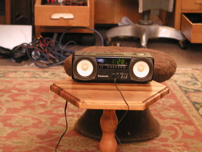

however, I picked up this alarm clock radio from the thrift store today and happened to have a few drivers laying around....
I find that it serves extremely well for doing "background" classical music, which does not require alot of bass. the thing barely puts out .8 watts per channel before major distortion. Yes, y'all, I have decended into the realm of lower -fi. I think it sounds nice though when not distorting. and hey, I have to have SOMETHING to tote around campus to do my assigned listening on (I am a music major).
so I guess when I graduate, look for a Cain and Cain model alarm clock!
