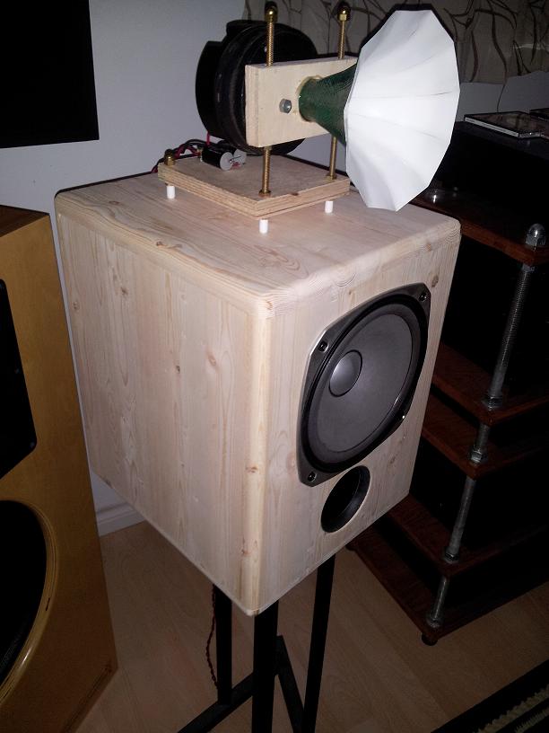

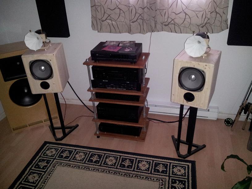

Well waddyaknow, I built another set of speakers. I chose the factory alignment for FF225WK that were sitting on shelves, 28L@39Hz, so though I'd post here. I did not follow the enclosure or vent dimensions though.
Boxes are built out of 12"x0.75" jointed pine, please no comments, :) I just wanted quick boxes and am limited in workspace/time and weather this time of year. Before a bit of bracing and wall lining, these rang as if made of metal, you really gotta hear this. I was actually shooting for a 44Hz tuning, but it ended a bit lower and I kept it like that so far. I mostly wanted woofer boxes to use under the petal tractix horns I'm running on top. The info is still relevant for use for FR duty.
I quite like these boxes. First try was way more out in the room than shown below, FF225WK run fullrange, it sounded real thin. There was no BSC then. I'm using miniDSP crossover and set it for 800Hz for the Emilar driver on the 700Hz horn. I use (IIRC) 4dB of BSC and with better placement, bass is quite good IMO. It's really damped and dry, which works in my small room, I have something similar going on my larger TD15M boxes. The shallow roll-off digs deep, if in a tamed way. Sound very "hi-fi".
