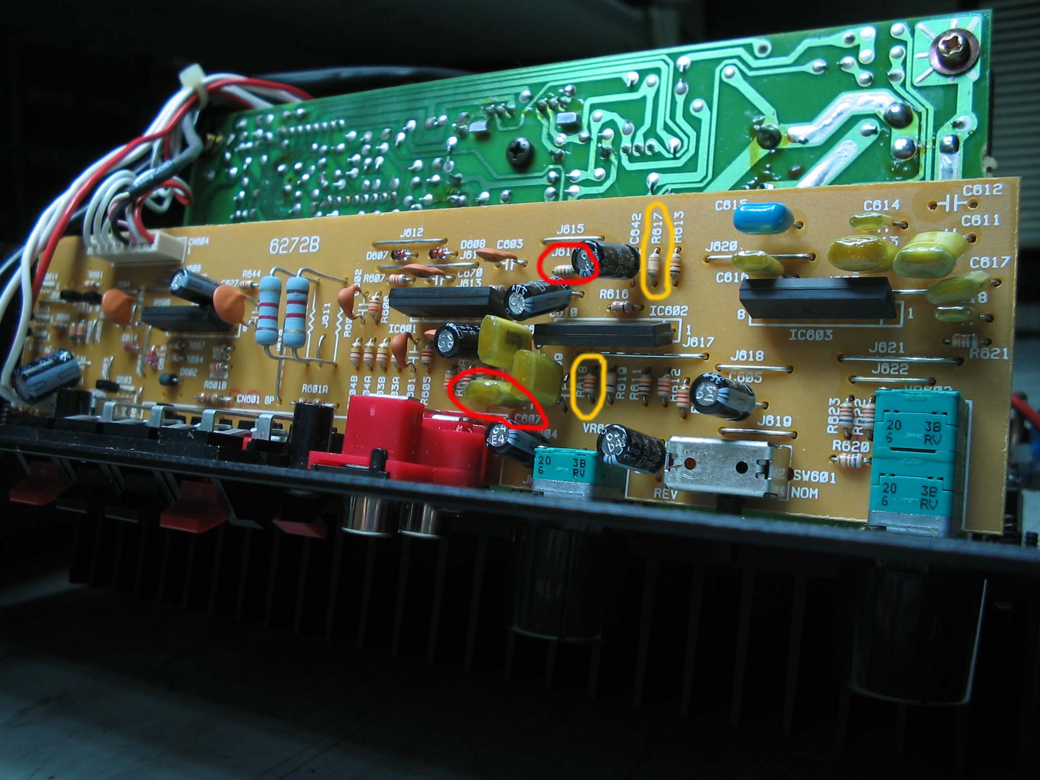

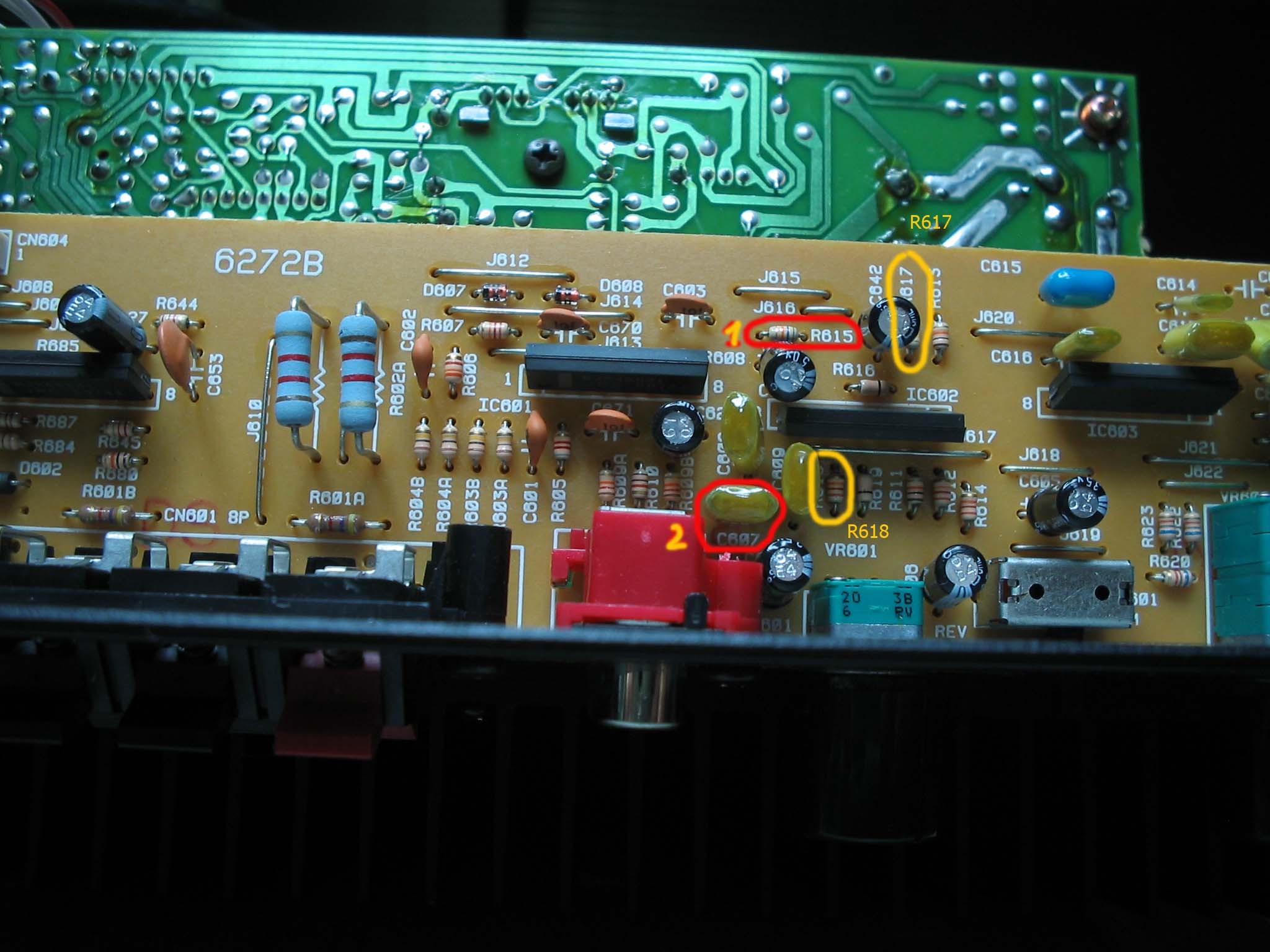

There is lots of info for tweaking them... the LF roll-off is a filter that can be removed or changed.
Dave, maybe you remember adjusting your amps. Can you please confirm that I've identified the correct parts on the PCB for adjusting the high pass filter?
To determine the correct boost, Q and F for the HP, model the woofer/cabinet system and the electrical filter in any of the standard free box modeling programs. You don't need the woofer parameters. Just put a woofer into a sealed box and adjust the woofer parameters until the Qcb and Fcb match the measured system response.
