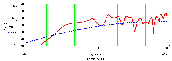

I probably would avoid. The BK is a fine kit I dare say, but it's not going to be optimal -it wasn't designed for the Sigma, and it's a bit small to do it justice.
Three alternatives. A BIB (see www.zillaspeak.com/bib.asp ) is a superb option for these drivers and is mind-bogglingly easy to build. Only six pieces of wood per cabinet.
If you want something more conventional, the Factory cabinet design is exceptionally easy to build as it's all right-angles, despite the large number of pieces, and it comes with a cutting-plan -just print it off, and take down to your friendly lumber merchant to cut to size, which you can then glue together as your very own kit. Better still would be the Nagaoka D37. Here's a link with a link, if you see what I mean, to the plans. Again, easy build, all right angles, and will sound better than the Factory horn, and far better than the BK.

See plot below -that's the FE168ESigma in the Nagaoka D37 cabinet modelled in the latest MathCad BLH Sections sheet. Not too bad at all.
