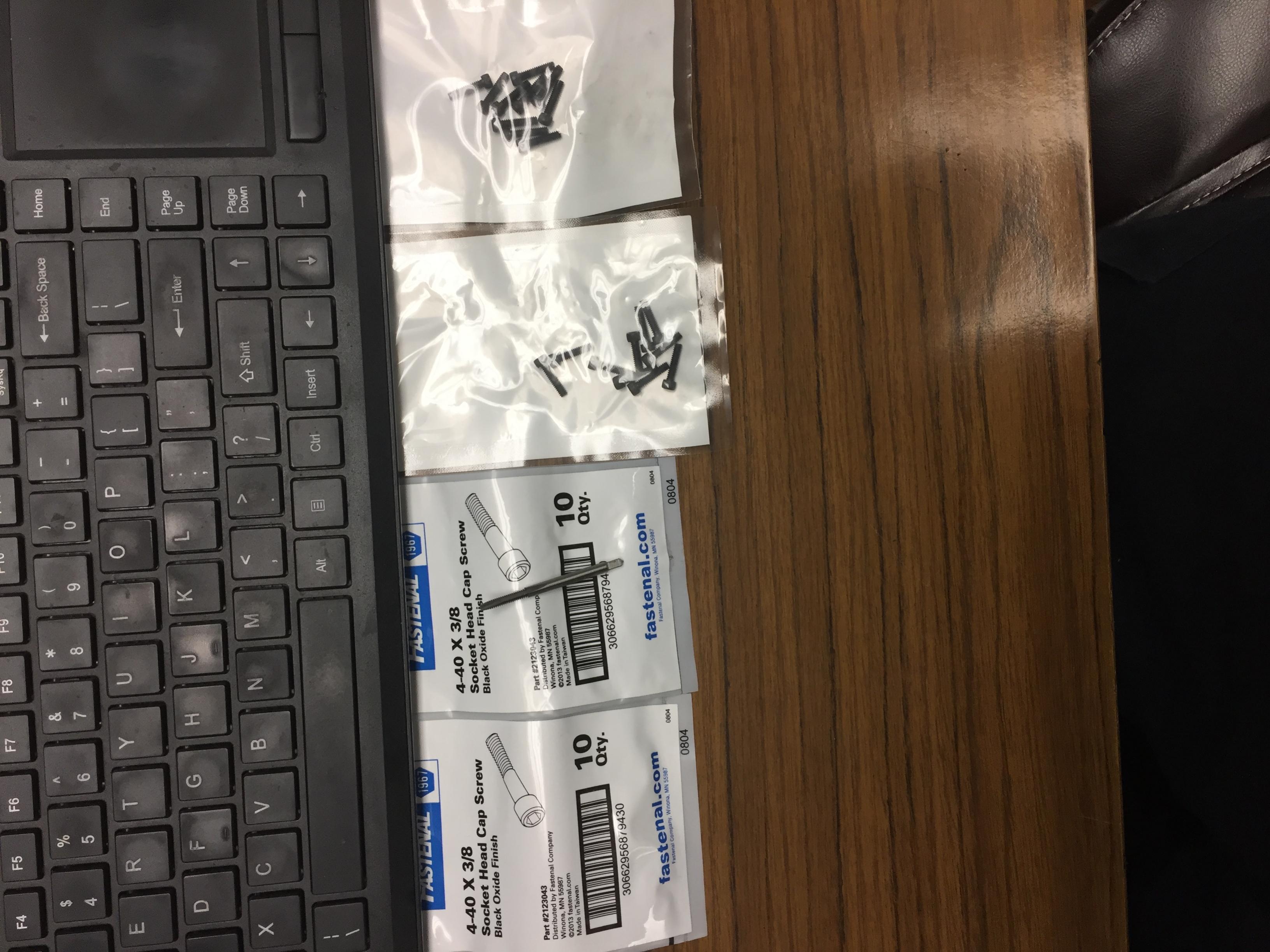

One thing that is a bit of work I used to do. I just remembered this. To stabilize the case and heat sinks, I drill and tap all the holes for #4-40 screws and enlarge the case screw holes. You won't believe how much of a difference that makes. File that under a must do with these amps. That adds about an hour to the job, but you really, really want to do that. If you can find black screws, it will look a lot better too.

Yes, good idea on the #4's. I would maybe only do it on the under side of amp however to maintain outward appearance. Maybe sides too but top IDK.

If you don't have any alternatives, I'll fix it for you. Let's keep your costs down, drill and tap all those holes for 4-40 screws. You can find black slot pan-head screws later, use silver ones for right now. Stick any new parts inside the unit. May as well use 2N6488 for the switching transistors and for the audio outputs use 2N6488 and 2N6491. They are both still current numbers. These days they are cheap compared to when I was doing car audio repair! Replace all tantalum capacitors with poly-aluminium ones.

Hey Chris, would it be possible (maybe picture ) could you replay the modification you make on the amp?? Is this considered " Type II" modification? I have about 30 250 and 2100 I am working on so this thread has really helped!! yea I have a problem. LOL love these Amps!!
