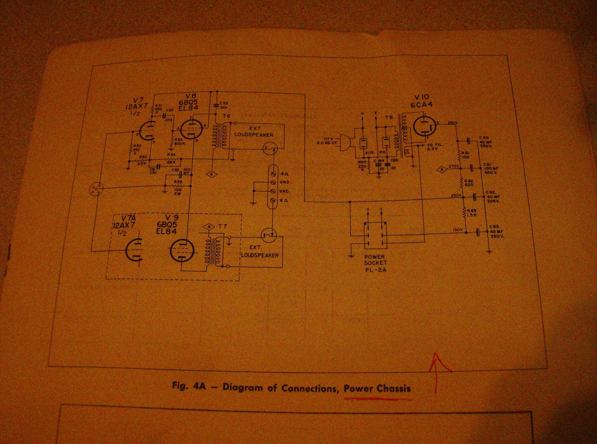

So, since that cat's now out of the bag.... Did your voltages check out? I'm especially interested in the voltage at pin 7 of the EL84. Is that 250V like it says it should be?
I'm also interested in what that capacitor is doing between B+ and pin 7 of the EL84. Is that a mistake?
Hi rongon....no worries much better to be pupil-ed than hectored.
See my last post....checking voltages is now my next order of business How do I do this properly and safely with a multi-meter? Do I stand on a proverbial rubber mat wearing rubber gloves?
As to the cap marked C53 .001uf between PIN 7 of the EL84 and the B+, beats the heck out of me why it's there....I have a second identical chassis (same manufacturer etc) and that cap is also there.
(ANYONE HAVE ANY IDEAS ON THE REASON FOR ITS EXISTENCE IN THIS CIRCUIT?)

I'm also interested in what that capacitor is doing between B+ and pin 7 of the EL84. Is that a mistake? --
According to Stefkorn and Bibliophile it is to prevent the EL84 from oscillating.
``Hi devilsindetails
It's a bit hard to make out in that scan but it appears to be conected between anode of output tube and B+ supply.
My best guess would be to stop some high frequency oscillation.
It could have been connected from the anode to ground but would require a higher voltage cap. Maybe done for cost reasons.`` (BIBLIOPHILE)
``Correct! It prevents the EL from oscillating.`` (STEFKORN)

Well it appears that with some careful and patient guidance (thanks to Cogsncogs, M.Gregg, bibliophile, Stefkorn, woodturner-fran, fullrangeSr.,hemgjord, DavesNotHere, rongon) the little amp that wouldn't, is now producing clean output
Swapped the red-plating 6BQ5 into the other channel and the problem followed it there..ergo...bad tube? Swapped it for another EL84 and voila no more redplating...so my cap job wasn't the problem...glad to know I can do something right!

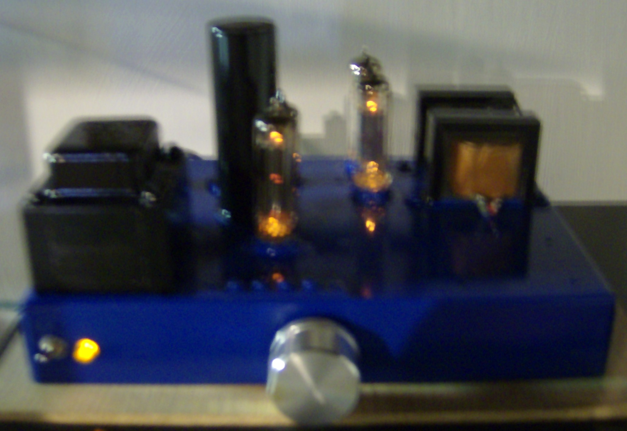

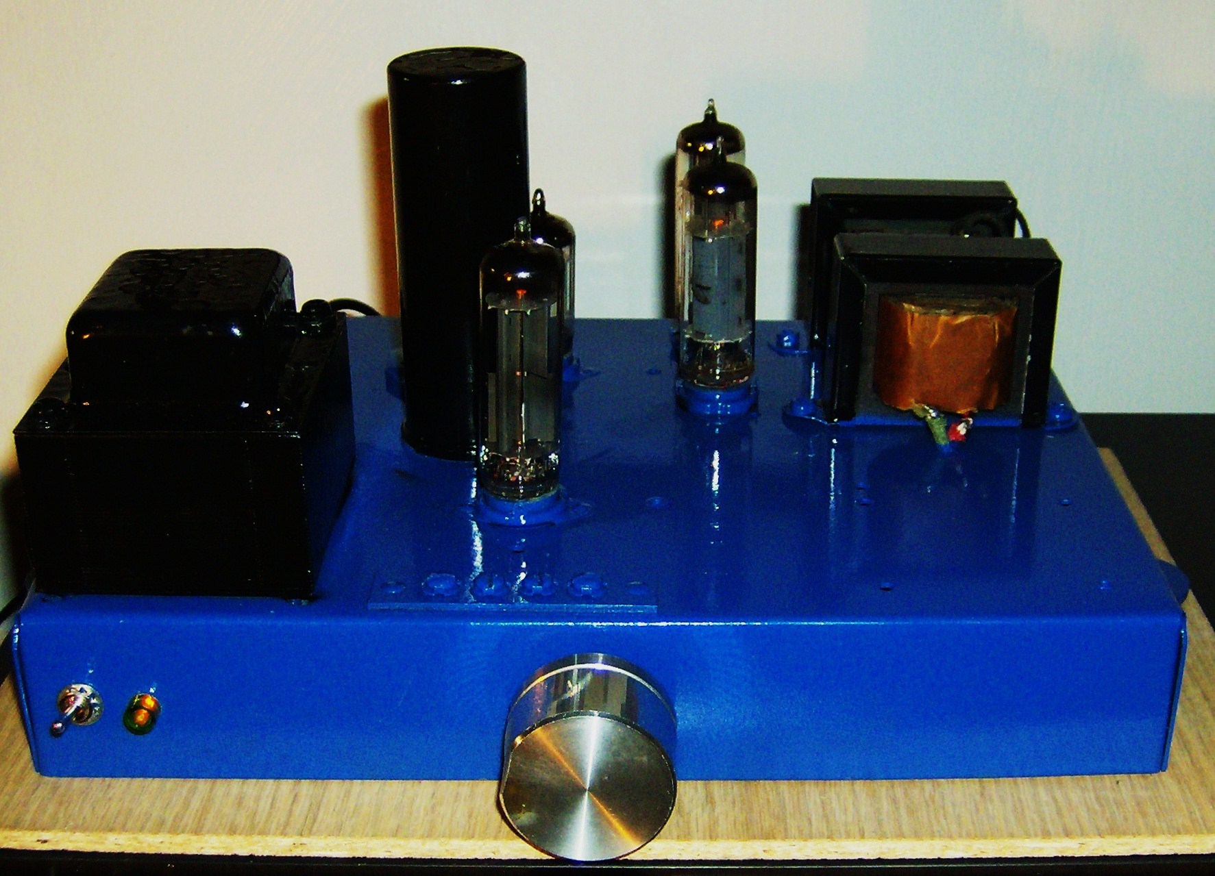

Although there are those who might think my refitting efforts are the equivalent of putting lipstick on a pig..here are a few pics of the little SE amp (my apologies for their quality, my camera calfed on me shortly after the second pic) which I am using as my tube learning tool while I continue with more reading and experimentation.

All is well and I am enjoying this little amp immensely...
Despite whatever limitations or inadequacies others may see in its original design and engineering....it is powering my Wharfedale SFB/3s with ease, no discernible hum and test tones (courtesy of an old Sheffield Studios Test CD)....reveal 40hz-15khz reproduction (the limits of my hearing anyways).
Inevitably this will be a stepping stone to my own, full-out DIY build (RH-84 perhaps)..but I can say without a doubt that learning is a whole lot easier when you have a working example to examine, prod and poke around in (carefully, of course)........
