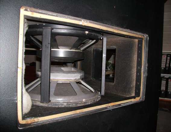

Found this pic when looking for info about the JBL triple chamber subs. Not sure if it's from an original or a copy though....

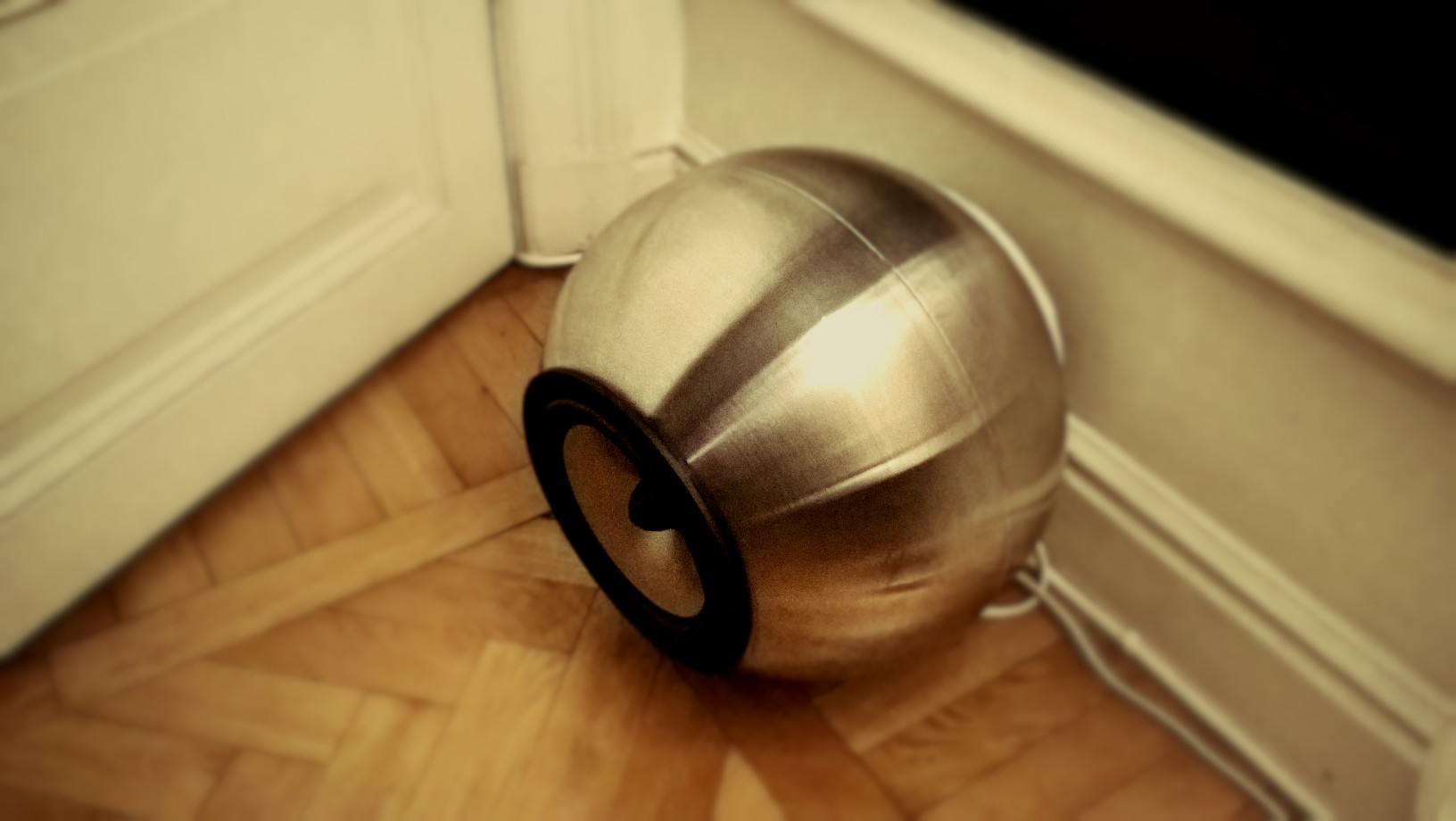

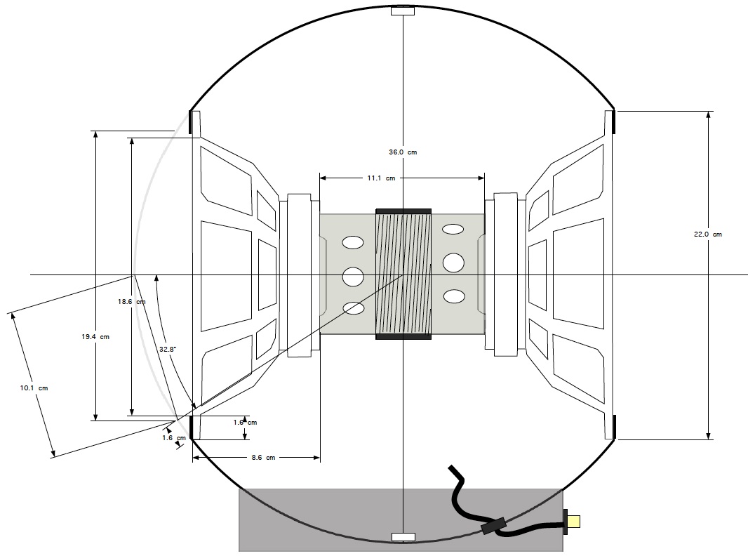

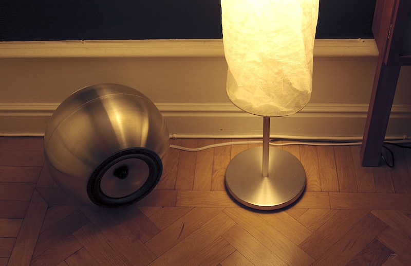

Its very efficient and highly recommended. I made these. Playing full force one cant feel a thing touching the bowl. A spherical enclosure is the most efficient as there will be no vibration due to pressure inside cabinet. A box will still "bulge"- a sphere in metal cant bulge :) The drawing don't reflect full out the build. Magnets are glued together via a piece of pipe.
