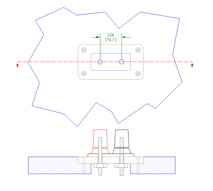

At one point we made our own "cup" out of wood that mounted flush, on a diy build it is extra work, but feasible. Since the decent binding posts usually require a skinnier mounting panel anyway, you route a rebate on the back with a centrally cut hole for cleanace of the posts, and then manufacture a removable plate that fits inside the rebate.

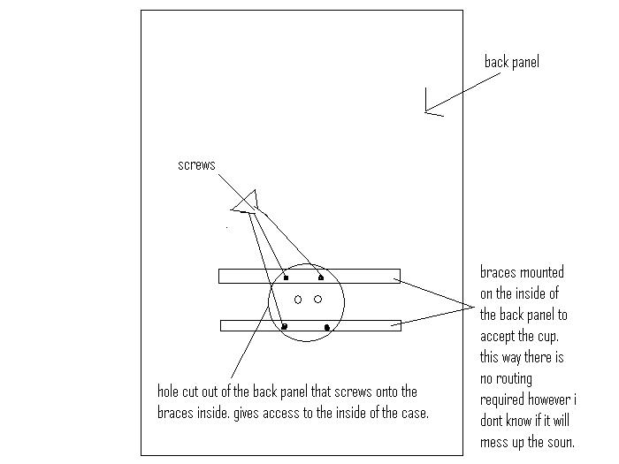

for the amount the gentleman is charging me i think it would be too much to ask for that dave. at this point i think the simplest way to have access to the innards of the box would be through the bottom panel. i could have half of it glued and half of it screwed on. the seam shouldnt be visible since the box would be sitting on it. this way i can get inside to change things (wiring, stuffing, posts etc).
if there are some important reasons why this shouldnt be done then i will just order a terminal cup =/ the trapdoor will obviously be sealed with something to make it airtight.
how about the attached picture? i dont know if adding those braces will screw up the reflections off the back panel. i dont see how it couldnt but im just brain storming here in a desperate attempt to avoid a terminal cup. this way no time consuming routing is required. just 2 pieces of wood be glued on the inside of the back panel. is this still not as simple as just making a trapdoor in the bottom panel. however it does the required job of giving me access to the inside.

You will have trouble getting a seal on that. This is what i had in mind. You can use wood or plastic for the removable bit, a chunk of aluminum only if the terminals you use are insulated from the mounting "panel" The only dimension to pay attention to is the standard 3/4" spacing of the terminals... and that you'd like the hole to be as small as feasible.
