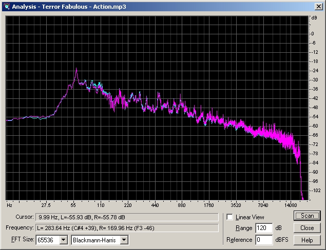

Can some one here ,who has the equipment, please take a spectral shot( maybe averaged) of some reggae songs so we can get an idea of where the low frequency energy is most abundant.

Here's a screen capture of an analysis of Terror Fabulous' "Action":

That's exactly what the RTA on my phone showed me, big bump between 60 and 120 hz from the Bob Marley song "one love". The peaks corresponded with the licks from the bass guitar.
