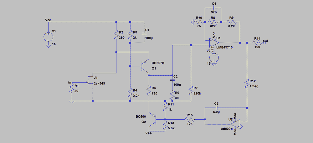

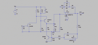

Kuei Yang Wang said:Konnichiwa,
Edit, attached a quick job on Werners schematic, showing instead of the folded cascode a current mirror with an option to increase the current gain of the circuit above that of the J-Fet.... The input CTRL on the second FET should adjust the current for 0V on the output (servo).
The ratio between the resistor in the current mirror should probably be around 5, not 10 as shown, this would give around 150mA/V effective transconductance which with 750Ohm load gives around 41db gain, the OPA627 stage will then give 19db gain for a total gain of 60db overall.
Switching the resistors in the Current Mirror and in the source of the second (current source) FET would accomodate a gain adjustment for use with MM Pickups as well....

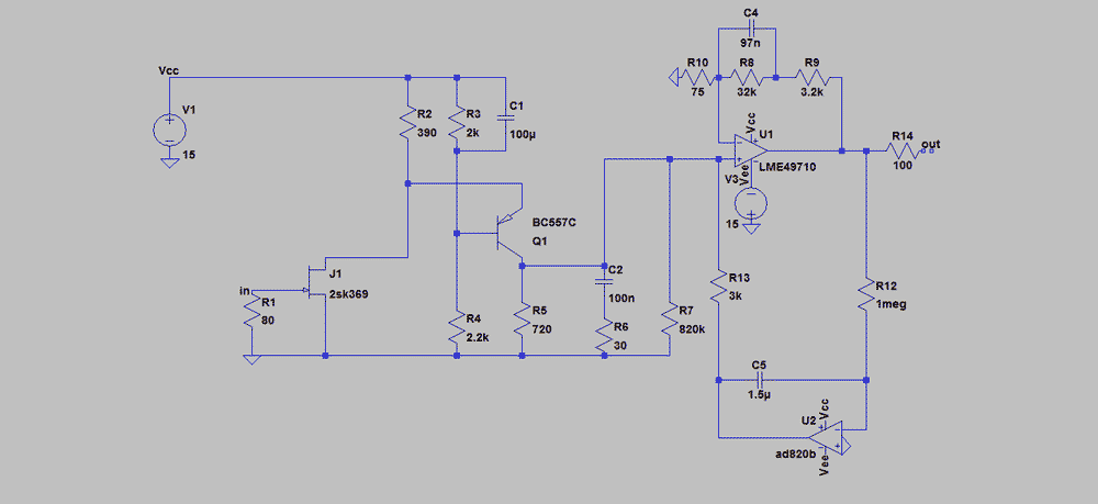

Hi!
While waiting for parts for another project to arrive,
I finished a protoboard of this litte phono pre I had in mind since it was posted.
I found it has some remarkable features, both sonically and practically.
At first, I build it as shown in the first posting, and then with a servo. This made a substantial sonic improvement, allowing me to omit C3. It can reveal a lot of 'microresolution' on my vinyl now. I clearly like what I hear. Schematic as shown.
1) Technical discussion.
What might not be obvious at a first glance: this circuit falls nicely together on the protoboard, a nice layout is easily made.
It is very quiet and totally relaxed when it comes to hum. I placed it directly on top of my line stage, above a not so small transformer. Even well made boards fail this test and hum badly. Not with this circuit!
It is a headscratcher, though, where Q1 gets his current from, with the servo working, because the non-inverting input of U1 is at 0V now. The sim indicates, that U2 serves as current source for Q1. I freely admit that I didn't really get it. (It was a mistake, I forgot to tie Q1 to the negative supply) There is probably room for improvement.
Since I will probably rewire my tonearm for balanced signalrouting, I have a very simple mod for the input stage on the drawing board which allows balanced input with just one additional FET which simulates great as well.
I have the vague feeling, though, that Werner's simple input stage deserves something better (simpler?) than the currently following opamp stage.

Forget the servo arrangement. With this, the whole immuneness against hum is gone. This is no big surprise, because the current loop of the input stage is not small anymore (through R5 and back to the input), but goes right through the negative supply and back through the entire ground bus to the input stage.
But with the intermediate coupling cap, the sound isn't as transparent as it could be.
Back to complimentary design?
Rüdiger

Why not use U1 inverting, with a feedback network of ten times the impedance and then use a 1M Resistor plus a 1uF (Wima?) cap to the non-inverting input, to cancel DC.
I used a similar circuit in a phono stage with a similar frontend and a valve section following and it works very well there.
Plus in your phono Stage it retains correctly the polarity, unlike now where the phono inverts.
Ciao T

Hi Thorsten,
yes, this is sensible. Here is Werners last incarnation.
I will try it.
I don't get where the other end of the 1Meg resistor goes. One of the supplies?
Rüdiger
Okay, simple.
Feedback Loop = 316K//10n & 36K, 750R to the collector of Q1 from negative input of U1.
CCS from Q1 Collector to ground or negative supply.
Resistor 1M from the collector of Q1 to the positive input of U1.
Capacitor 1uF or larger (high quality) to ground from positive input of U1.
This does not eliminate the offset of U1 of course, but offset should be minimised and it will track any thermal shift in the input folded cascode. The Offset of U1 can then be easily trimmed off or you can use a 2nd order Servo with a very high value resistor into the inverting input of U1 minimising the sonic impact.
Ciao T

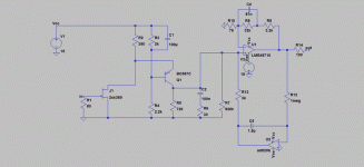

Thanks Thorsten.
Fiddling with it in a simulator indicates it might not be that easy to make it working. I will try on the bench.
However, your first answer indeed backs up my feeling that the input stage deserves something (more) decent as a following stage than 1 opamp.
Rüdiger

A Fet Input Op-Amp may help...
Well, I have a "near other commercial stuff" comparison Phono a design with an INA103 set up as Howland current pump (so it effectively behaves as transconductance cell (so it behaves a lot like a folded cascode).
The second stage set up as inverting Op-Amp with suitable input impedance and feedback network to affect the HF timeconstant with a cap to ground and the input resistor, plus the LF timeconstants in the feedback loop.
OPA is of course the OPA637.
No Servos.
No Coupling Caps. Hand trimmed offset using Vishay trimmers.
All Rhopoint wirewound copper alloy resistors for the critical stuff and mil spec east german made polystyrene caps (1985 vintage) for the EQ.
Massively overbuild unregulated supply, using four 50VA transformers with full wave schottky rectifiers and 10 pcs 10,000uF Caps in RCRC...RC filters per voltage.
Seperate 10R resistors and 80uF/35V Film Caps for each Op-Amp with some additional SMD Film Caps for decoupling.
This phono stage was in part inspired by the Emitter and the Vendetta plus some twists of my own.
Two section chassis, non-magnetic & copperclad in the audio section.
It takes some very SERIOUS phono-pre to better this little "illustration of a good commercial Phono".
So far not much commercial, solid state or hollow state did much better (except some extreme tubes stuff).
So, that "better than one op-amp" may take some doing.
The Phonostage that was designed with this one (and many others) as reference is not entierly inexpensive and was the one I referenced above.
Ciao T
