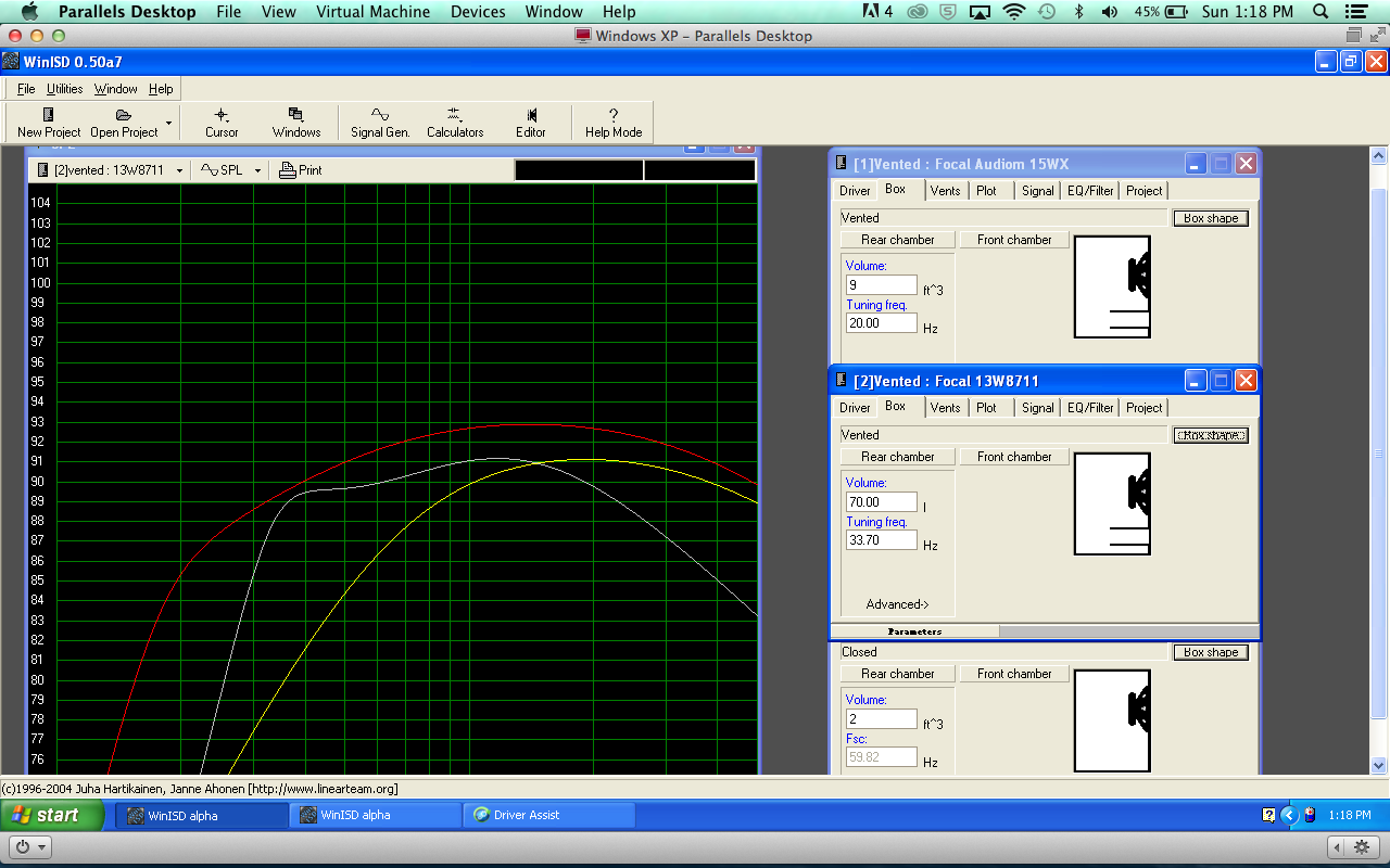

Considering I will have 106 db at 25 hz with only 30w once two woofers are connected I am tempted to leave it this way for now and start to get things re organized in here. Its been kaos with all this speaker building.
The other option is to make large square ports and attach them on the outside of each cabinet. However I may not have room for them so have to measure.
so for the midrange driver focal audio 6wm I am looking at the possibilities.
Here is critically damped . Has anyone tried this? What did you find vs a larger cabinet? Any input appreciated.

similarly comparing the options for the focal 7w6411
The recommendation I received from the seller of this drive is in yellow.
Critically damped in blue.
Max flat delay response option is in red.
