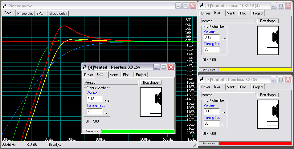

Everybody keeps saying that I need to eq them before I can directly compare the two drivers. I think I am having trouble understanding just exactly what is happening. I know the Peerless will play lower frequencies and the Focal will play higher frequencies. But, if it is crossed over at 100 Hertz with a slope of 24db per octave, should'nt they both have a flat frequency response between 100 Hertz and say 40 Hertz? I know the room will have an effect but it should have the same effect on both drivers right?
5 minutes simulating will tell you very quickly what is happening.
See image attached
The focal goes down to 35 Hz F3
The XXLS has a nasty hump in that box because it is tuned too high.
For a quick comparison you might be able to stuff the vent - not to block it fully, but to attenuate the peak.
Blue = closed
Red = XXLS in existing vented
Green = tuned lower
To get a comparison you could add some vent on to tune it lower. On some material, the extra depth of the XXLs will be evident, although you will have a better chance to compare midbass differences. Clearly at the moment, the response of the XXLS is dominated by an ugly peak.

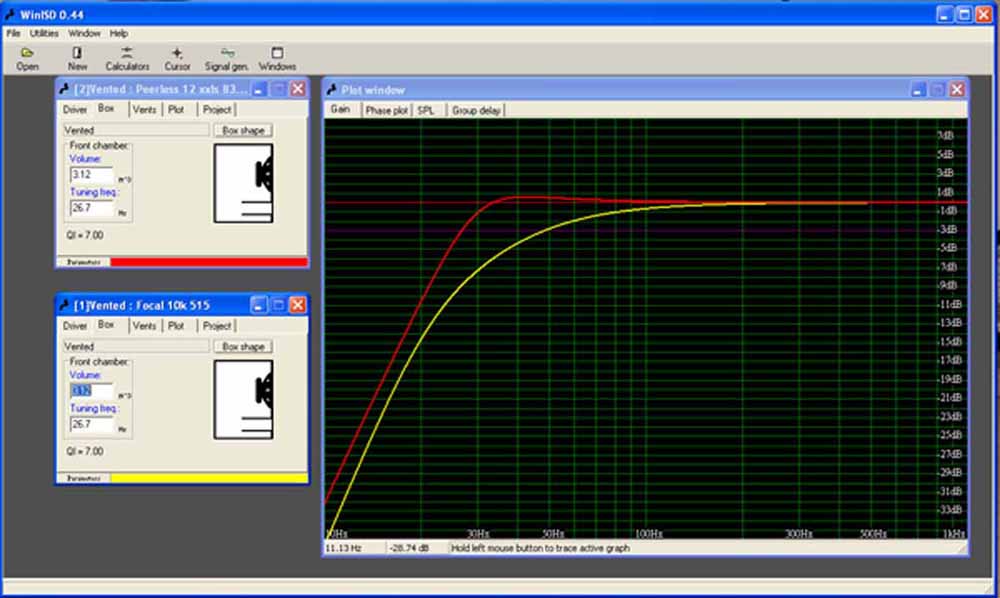

Joined 2005
See attached graph for 830847 XXLS in 88L box (~3.12 cu ft)
tuning at 35Hz
tuning at 25Hz
tuning at 20Hz.
35Hz tuning is too high, resulting in little low bass.
I would suggest changing the port tuning of the 830847 to 20-25Hz (bottom curve, and 2nd from the bottom, respectively)

For comparison, you want the drivers to have a similar response. Just temporarily attach extra vent when you put in the XLS so that they have a similar response down to 40 Hz. This will let you compare how they sound with music. You must get rid of that peak to give the XLS a chance. The low tuning is not so good for the focal since the F3 now is too high.
Also include the lowpass in the response, as you will see it changes things considerably - what looks good without a lowpass is not so good when it is included. You must factor in ALL the filters you will be using to get a correct design.
