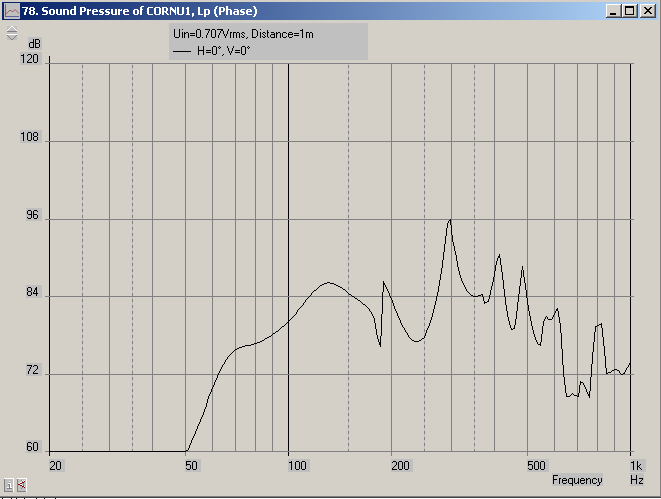

... Do you mind scaling it to 20 in (50 cm) and running it with the Vifa tc9fd ...

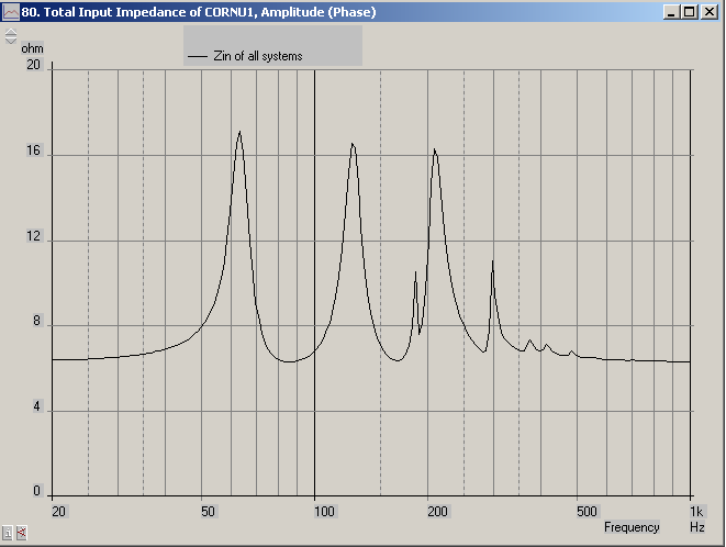

See attached. I assumed 6 cm depth. It doesn't look good... I think the volume (depth) is too small and the horn is tuned too low.
... Also, at the 70 cm, the longest path should get down to about 38 Hz, the sim shows falloff below 50 Hz. ...
It is what it is. The impedance and excursion graphs (of the 70x70 cm model) show resonances at 61 and 119 Hz. I suspect the bifurcated horn is the problem. The longer of the two "output" horns is 138 cm, which is 1/4 wavelength at 62 Hz. That's why I want to re-sim with equal length horns.

Like this:
Code:Throat +-- Horn 2 -- Radiator Radiator --Driver -- Chamber -- Horn 1 --+ +---- Horn 3 ---- Radiator
Don,
Thank you for running the simulation. This is good stuff and exactly the sort of thing we should do to improve things. I am not sure if the huge peaks and dips are really there in real life because like I said, this is one of the best sounding speakers I have heard. It may be that I modded my plan and made sharp corners on the insides to act as filters, and I have stuffing in the main chamber and the throat passages. The stuffing probably does more than anything to Smooth things out. I guess someone should do a measurement - I don't have the equipment. However, I have run simple SA on my Android tablet (limited range on freq response due to built in mic) while listening to music and do not see the huge dips or peaks, it is very even in the 100 Hz to 2 kHz range. But this is music and not pink noise....
Regarding the simulation and the bifurcation, I have my doubts about what really happens physically - that is, is it really a bifurcated horn, or is the bifurcation channel (the split) really acting as a divider rib to the longer horn with an average length between the shorter and longer one? Also, could it be additional horn resonances - there are 4 different lengths if you look at the combination of possibilities. Nonetheless, this is awesome what you have done. I am new to using this modeling tool - would you mind attaching the input file/script or whatever is needed to run the simulation as a file attachment to a post on this thread? I am not new to mathematical simulations, as I use Mathcad all the time, I am just not familiar with akabak.
