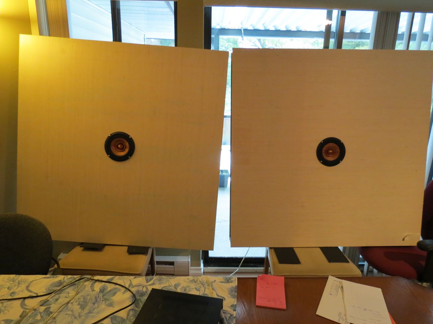

First attempt :) Quick and dirty,with 2 little kids "helping" . This really works to prevent woodwork perfectionism.

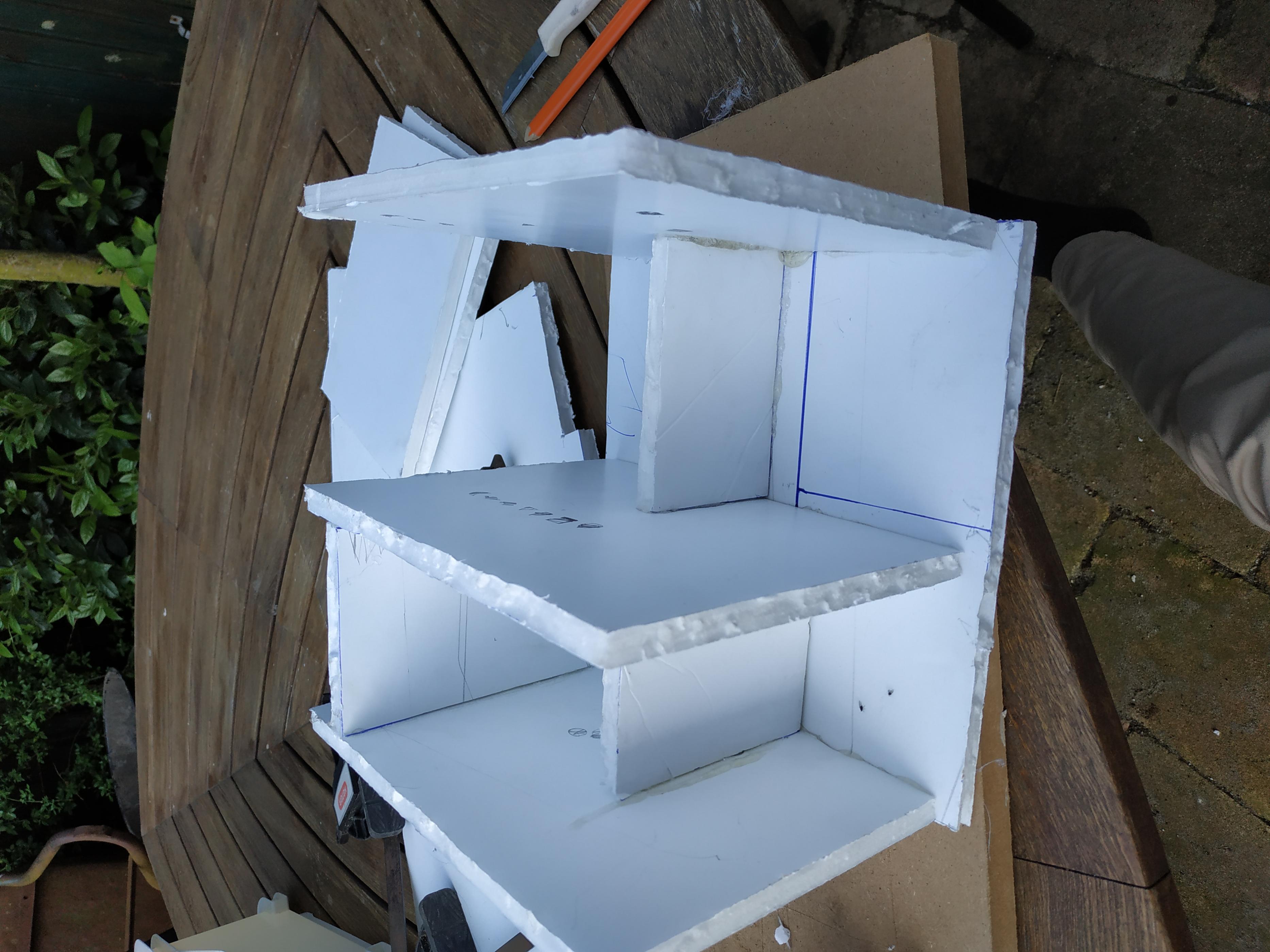

Cut with several 5-7 strokes each one a little deeper. Hold your blade at about 90deg and it’s close enough as Board is only 3/16in thick. The glue will fill in the gaps.

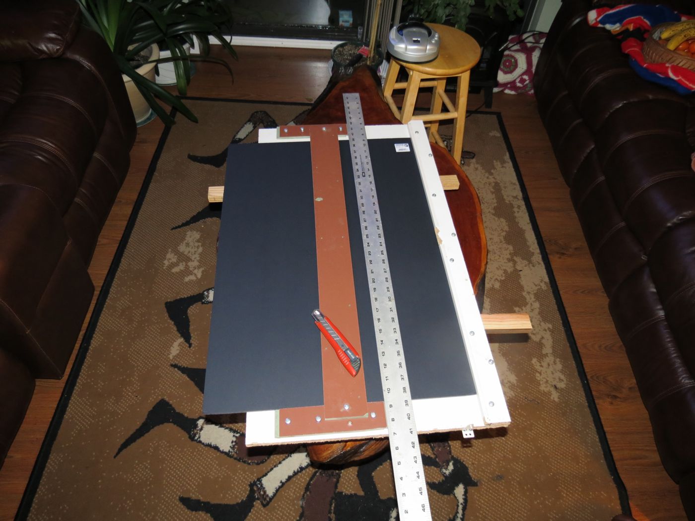

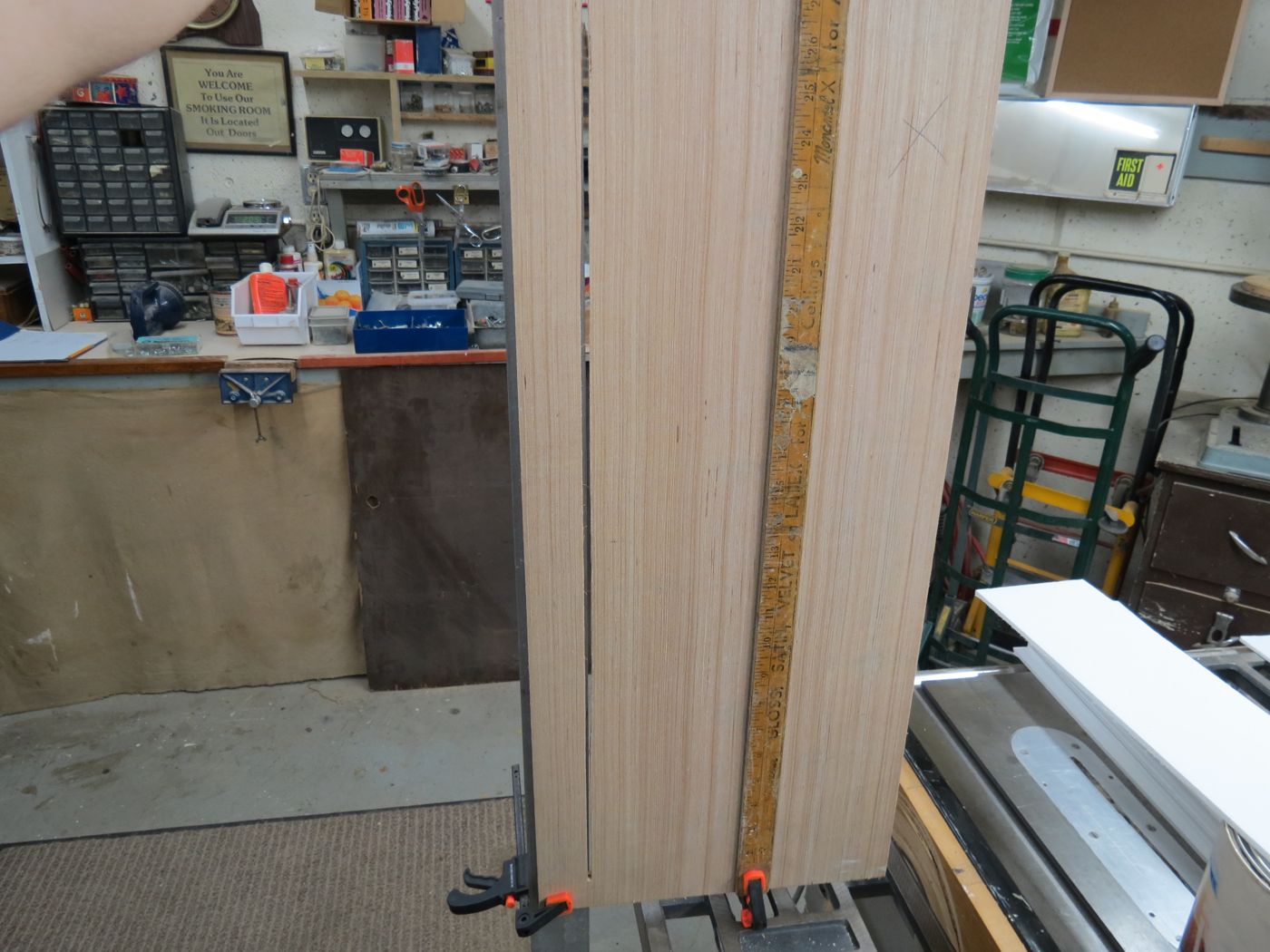

Sort of, I'll explain.
The first pic is of the bottom of one of them. Note the slot on the left is much wider than the blade but not cut the full length of the Sure Ply. The wood ruler is the fence.
The second pic is the top side with the metal ruler used as a straight edge. Picture a second metal ruler creating a guide or keyway.

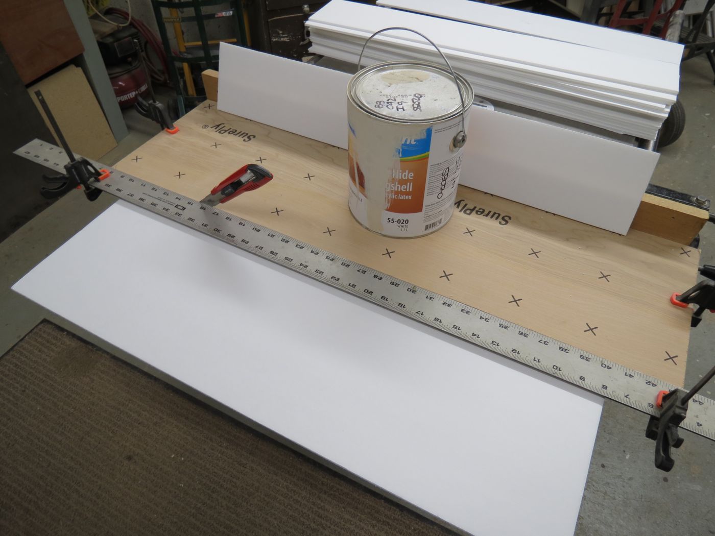

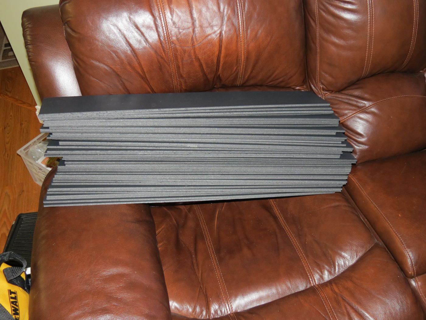

Here's another. This is using the black foam core. The brown piece is a retainer, it is elevated above the foam core so you slide the foam on top of the jig under the retainer and up against the fence on the right. Picture two metal rulers clamped to the table spaced just wider than a blade width.

I don't remember but it was probably a regular carbide blade on the table saw to make sure the slot was good and wide. I simply dropped it onto the blade making sure to use the fence so it was semi straight and of course the metal rulers did the final adjustment. As you say, it's pretty elementary but it's also very effective.

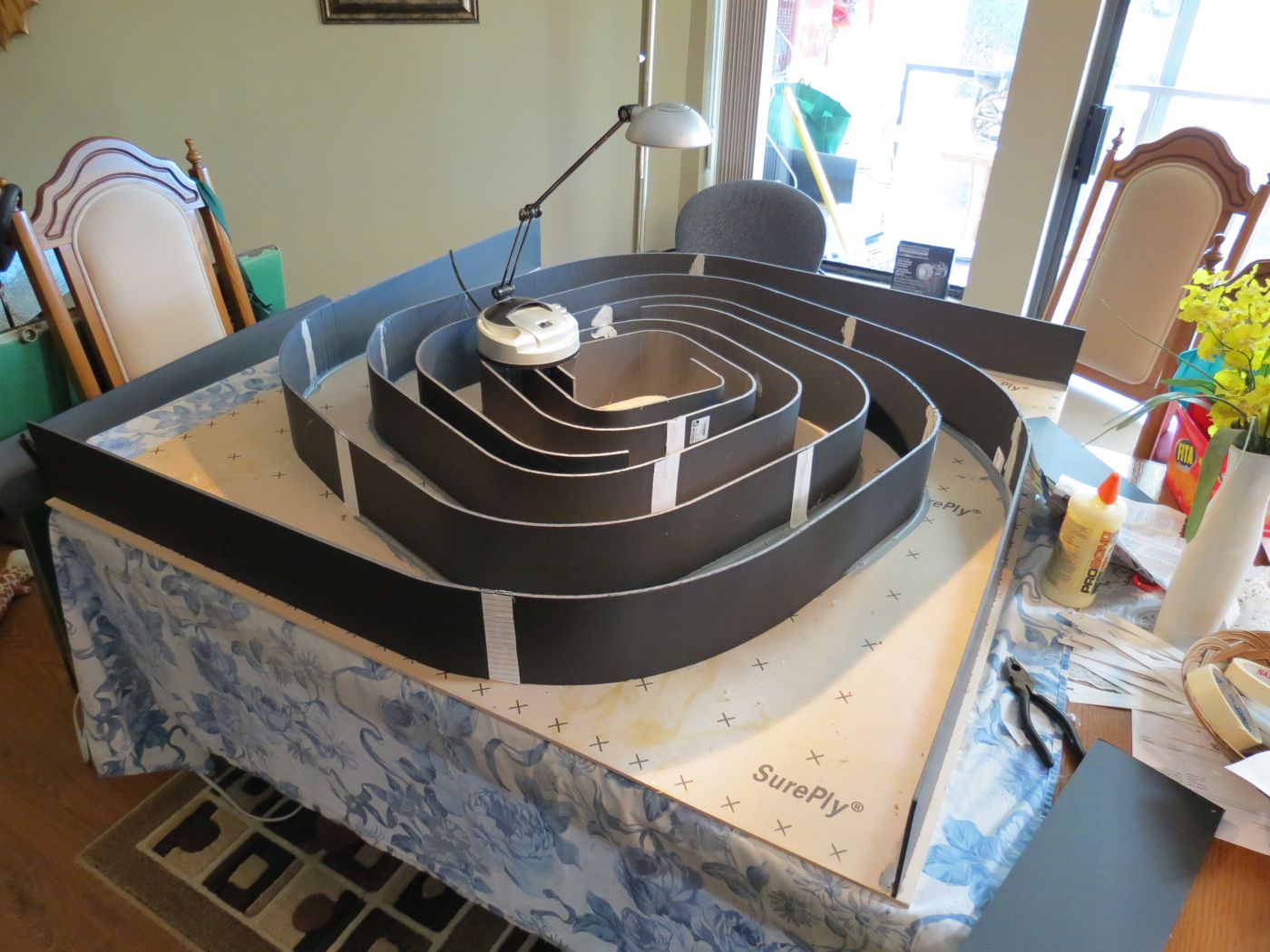

I think you want to avoid heat at all cost. You also need precision cuts as when you go to glue the second side on, you really need near perfect edges. Those are 6.5" drivers so you can see these are the large 48" units. The last pic is the guide I attached to the glue bottle so I didn't have to freehand a bead of glue onto all those feet of foam edge.

The tutorials I’ve seen (as well as my own methods) recommend a scoring cut through the paper face followed by a second cut through the foam and bottom paper layer. As Cal has mentioned a sharp blade is the key regardless of method.
