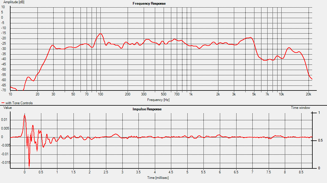

I removed some stuffing and it helped a lot. :)
Mic is at 30 in height and 1 m from speaker. Looks like bass extension matches my prediction of circa 30 Hz. The tweeter doesn't look like it kicks in until 10 kHz though and there is a cone breakup peak at 4 kHz. Not sure what is causing bass peak at 100 Hz - room effect?
The measurement is with tone controls for treble boosted and flat.
Sounds pretty good except that I can hear the difference in lack of clean tight bass articulation (as opposed to Nautaloss) , I can really hear the deep bass but it is a little jumbled as evidenced by ratty looking impulse response.

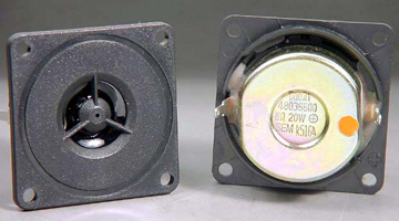

Did you ever try a pair of the ApexJr tweeters I mentioned. IMHO, they have a price/performance ratio similar to the Vifas.
I was thinking of the same thing as I recall you used it with the DNA horn with success. I need to get some of these. I also have a cheap Pyle PH44 CD horn tweeter but that will require a bypass cap and some resistors to pad down.

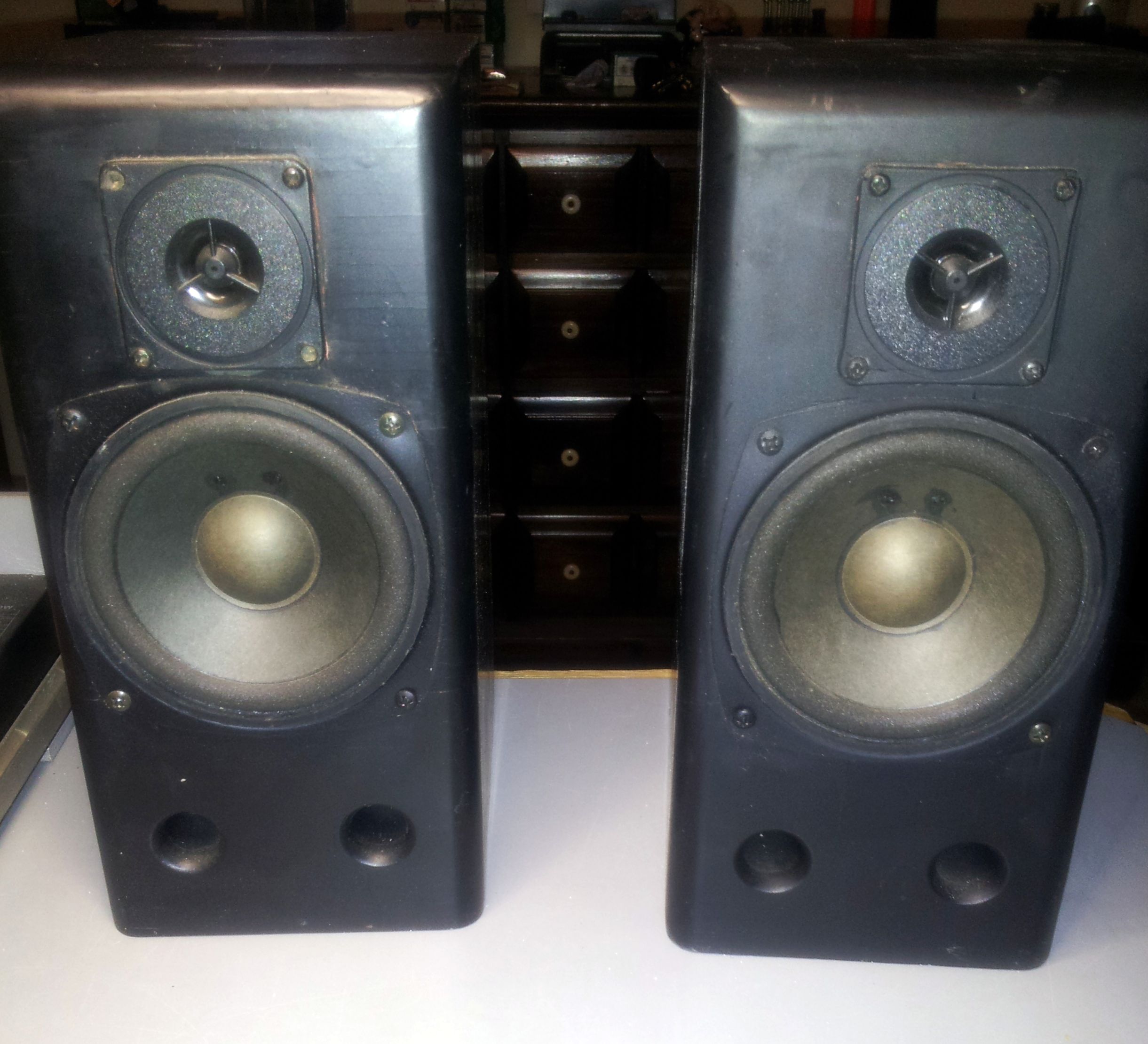

They are also in my DIY bench speakers. I built that set for several friends - and a local appliance dealer seriously considered adding them to his consumer level audio department before Best Buy and Amazon blew the lid off his potential profit margin.:mad:

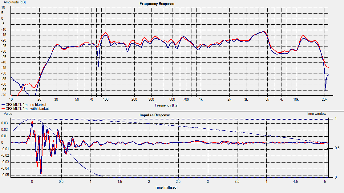

indulge me if you will,find a packing blanket and wrap your enclosure then take your measurements again.
i think the material density and stiffness effects are at play!
You mean secondary radiated sound from thin enclosure walls are being picked up in the measurement? I can try wrapping the box with a blanket and see what happens. That may be the cause of that 100 Hz resonance.

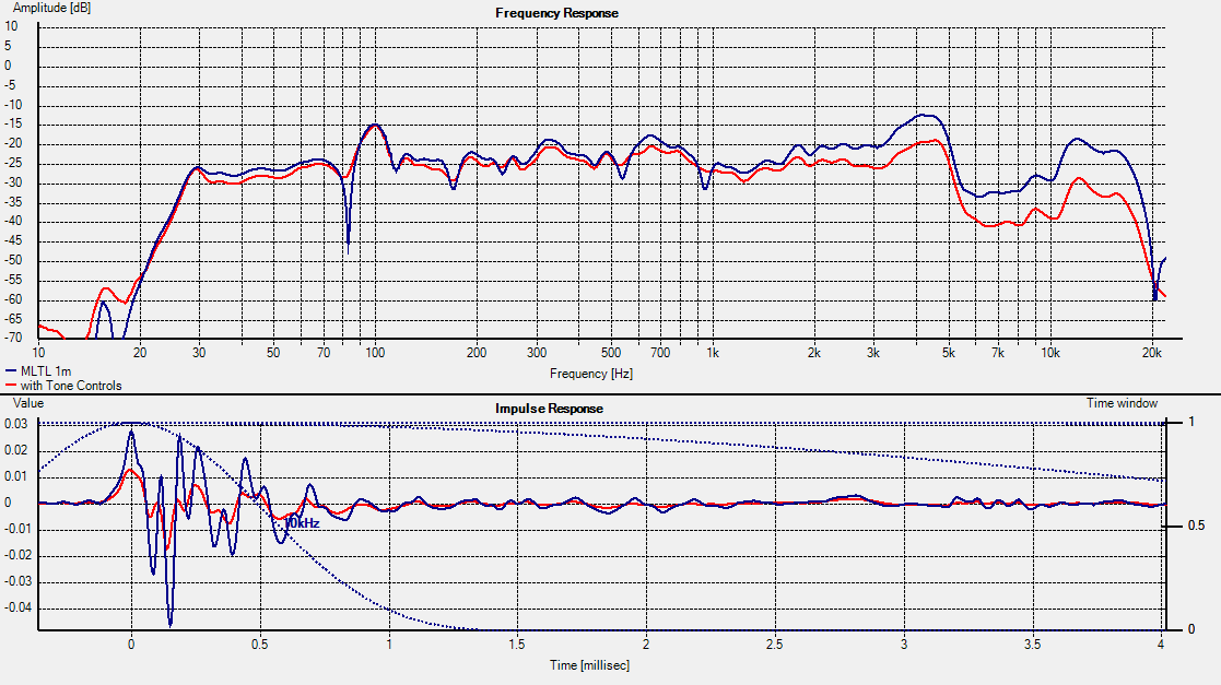

I covered the speaker with a thick -35 deg mummy style sleeping bag. The double zipper was perfect for allowing both the driver faces and port to be exposed while the rest of the cabinet was covered.
I see no difference - which is good from the standpoint of people wondering how much the foam walls contribute to the sound. In this case - negligible. In fact, the covered case seems to have slightly higher SPL?
I am pretty sure the 100 hz peak is a room feature as it shows up when I turn on my other speaker at this same mic position.
I am debating whether or not to build the matching stereo pair. Big speakers are rather time consuming to build with lots of bracing required... Hmmm...
There were some reflections from nearby walls/objects than once removed produces a better impulse response -similar to the standard exponential decay ringing that I saw on the single driver version of the OB. So the impulse response can be cleaned up a bit with placement/room treatments.

the graph on the left is no sleeping bag and the one on the right with?
how may ratch straps did you use?
if the added mass isn't firmly attached can it be expected to have any effect at any frequency?
The one on the left shows with and without sleeping bag cover. The one on right is no sleeping bag but placed differently in room to clean up impulse response.
I did not use any ratchet straps - don't have any but was trying to cover up radiated sound from walls of enclosure and not trying to affect the mass/densities of the walls.

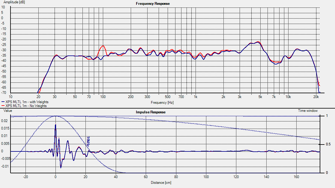

Mathematically it could be the mean of its primary reflections, so try adding as heavy a weight as the cab's construction can tolerate on top to mass load the cab to the floor to 'tighten up' its overall response, which BTW can benefit even very rigid cabs.
GM
Are you talking about adding mass to improve the impulse response or to help with the peaks? I think you mean impulse but not sure.

The added weight seemed to fix the 100 Hz peak.
Thanks for the suggestion.
