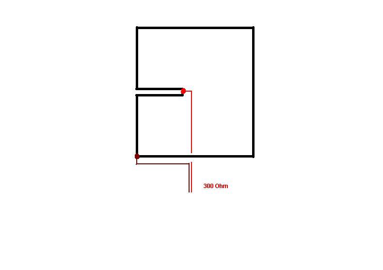

Scott,
Have you built this?
Is best reception parallel or perpendicular to the loop?
Which corner does the other 300 ohm lead attach to? The directions only mention "adjacent" corner? I am assuming one of the two corners nearest the merge?
Like attached?
Sorry, I did not need it since a simple dipole up high enough worked for me. If you want to try it I would first follow the picture they have. I know the words and the figure don't exactly line up, I also found it a little confusing. Possibly the AARL handbook has a description of the quad principle. 3-6dB extra from a few feet of wire seemed like a good deal at the time.
