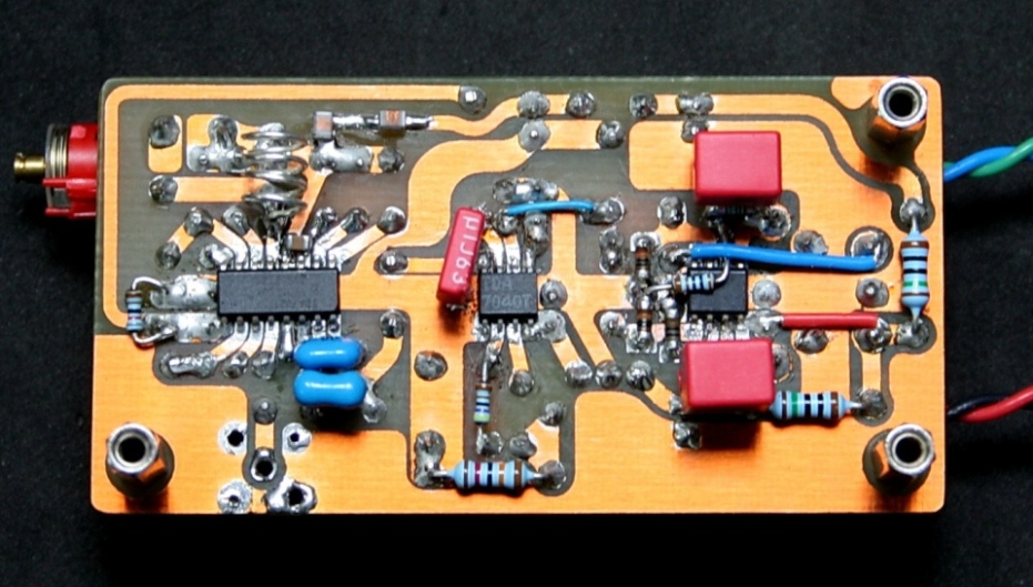

The SI chips are all one chip tuner, which means they use varicaps and caps integrated in the IC. I have build one of these with a JFET analog output stage :
Mini-Stereo-RDS-Radio-Modul Fertiggert, bernsteinfarben | ELV-Elektronik
It is again all digital with lots of features, but the sound was so-so even with a discrete output stage.

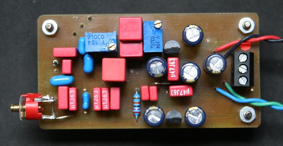

Then I built one using the TDA7021/7040 according to datasheet / Elektor :
Mini VHF FM Receiver - ELEKTOR.com | Electronics: Microcontrollers Embedded Audio Digital Analogue Test Measurement
but replace all SMD ceramic caps with MKP or mica, and also added an opamp amplified output stage. It sounds fantastic for the cost and the simplicity. The key is the choice of discrete components.
I will build a JLH FM next year, but that is a LOT more effort than this.
Just my own personal experience,
Patrick
