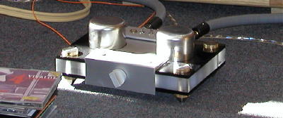

Don't forget that I was using S&B 102 TVC. So I already had iron and buffering in there.
But seriously, that tube version sounded really good, there was no question about it. Especially the separation between instruments, pace and overall liquidity. The highs might not have been that natural and digital free, but the other virtues made up for that. The SS version sounded average, nothing to write home about. My DAC was somwhere in between
I had not forgotten already, just thought the S&B was only used with your own DAC...You used it with the Shanling as well as with your own DAC, than?
Am I correct in thinking the S&B TVC is built inside the rectangular wooden boxes with the VPI bricks on top of them as shown in the last pic you posted?
Too bad you didn't compare the unit with and without the S&B, it may very well be a major contributor to the final outcome.

Here's the TVC stage. It was in all the time, as the GC monoblocks are much better in this way.
